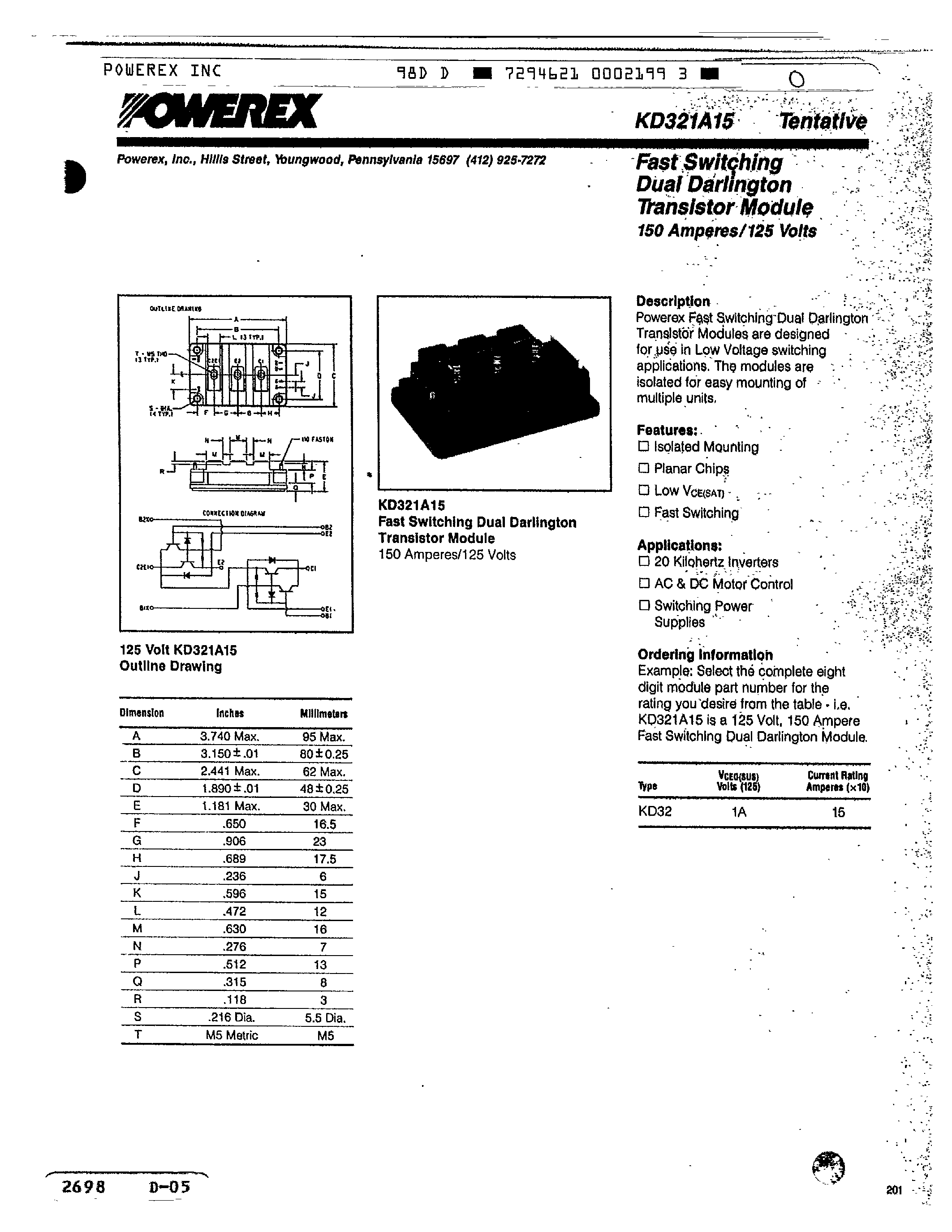

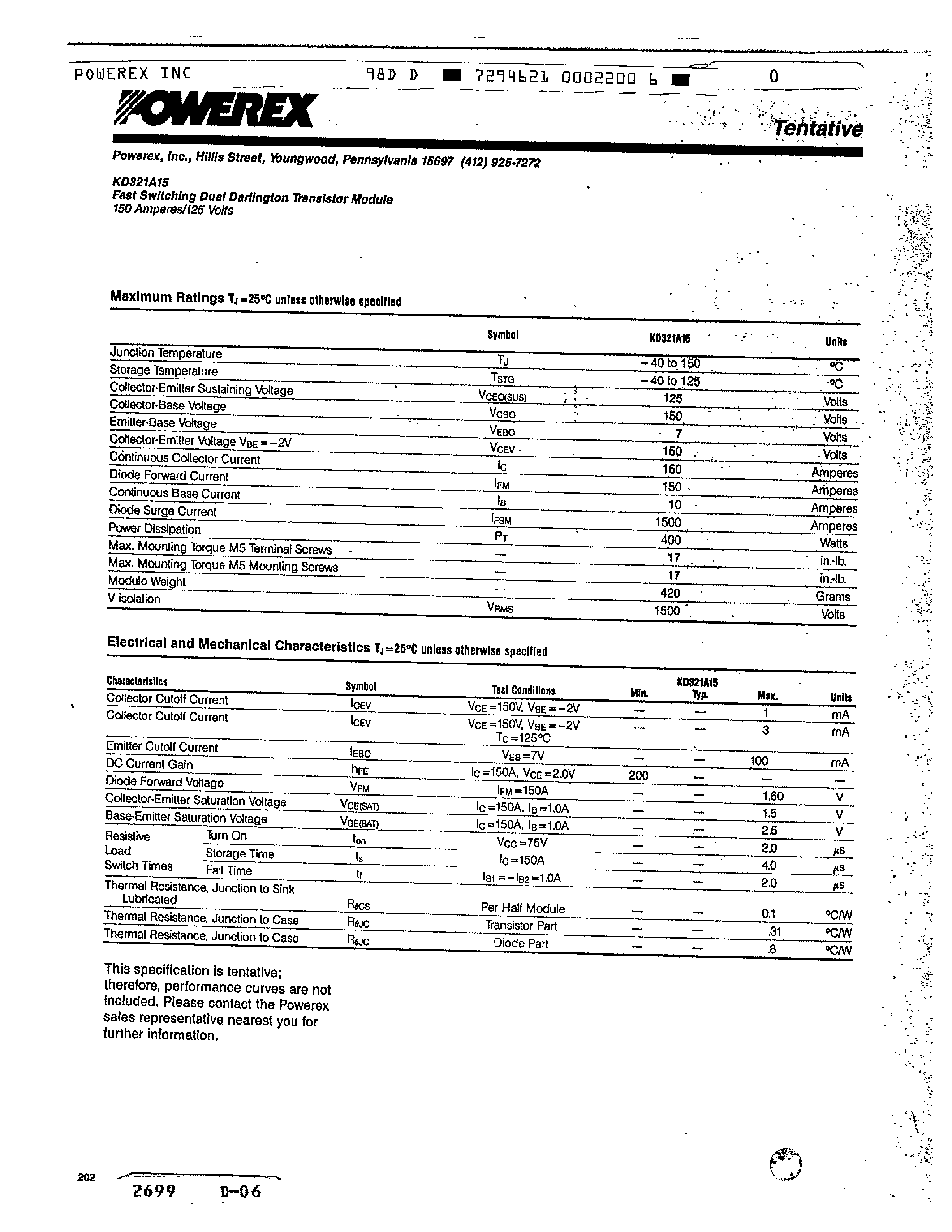

KD321A15-Fast Switching Dual Darlington Transistor Module (150 Amperes/125 Volts)
Producer:Powerex Power Semiconductors
Description:Fast Switching Dual Darlington Transistor Module (150 Amperes/125 Volts)
Others with the same file: KD321A15
Datasheet KD321A15 - Fast Switching Dual Darlington Transistor Module (150 Amperes/125 Volts) page 1
Datasheet KD321A15 - Fast Switching Dual Darlington Transistor Module (150 Amperes/125 Volts) page 2
