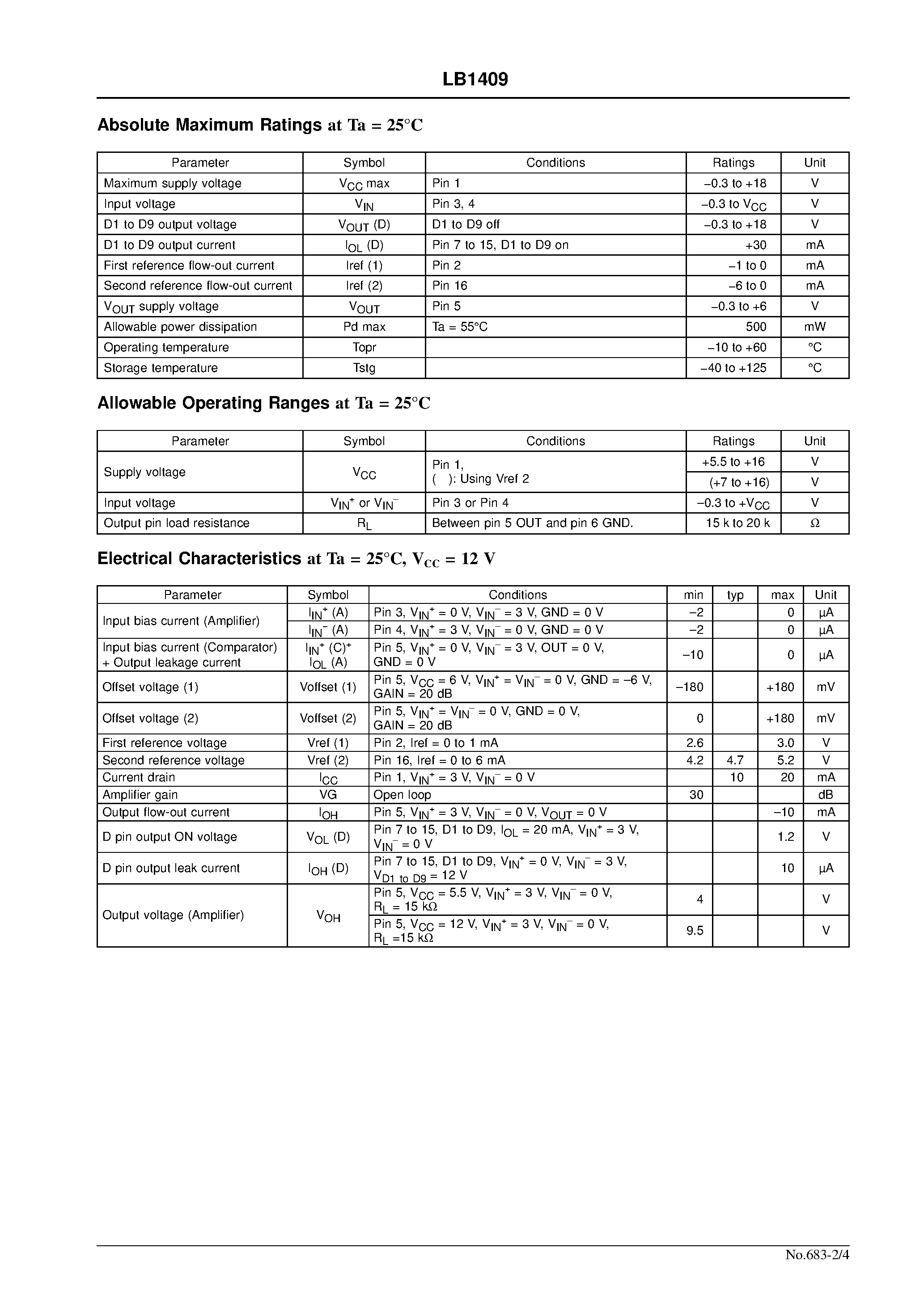

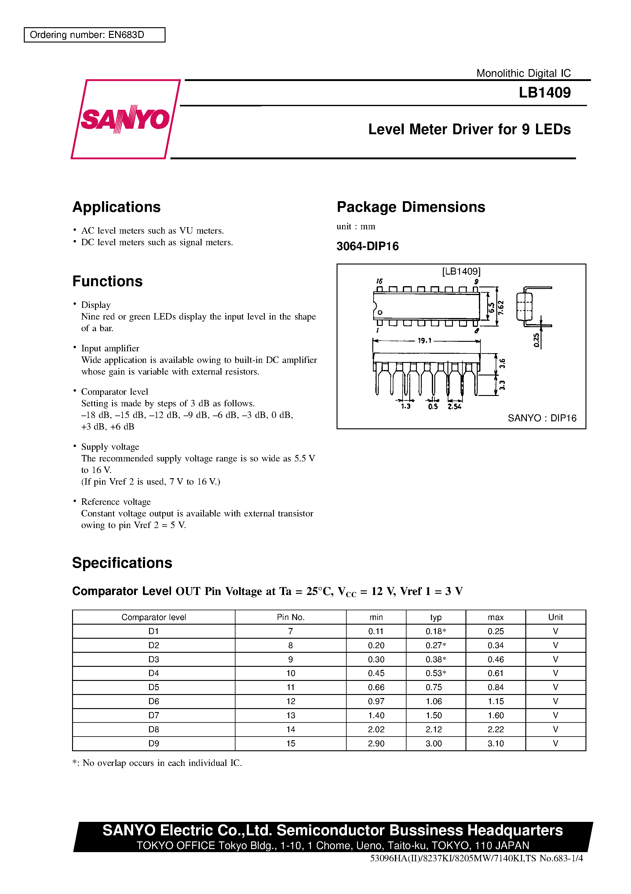

LB1409-Level Meter Driver for 9 LEDs
Producer:Sanyo
Description:Level Meter Driver for 9 LEDs
Others with the same file: LB1409
Datasheet LB1409 - Level Meter Driver for 9 LEDs page 1
Datasheet LB1409 - Level Meter Driver for 9 LEDs page 2
