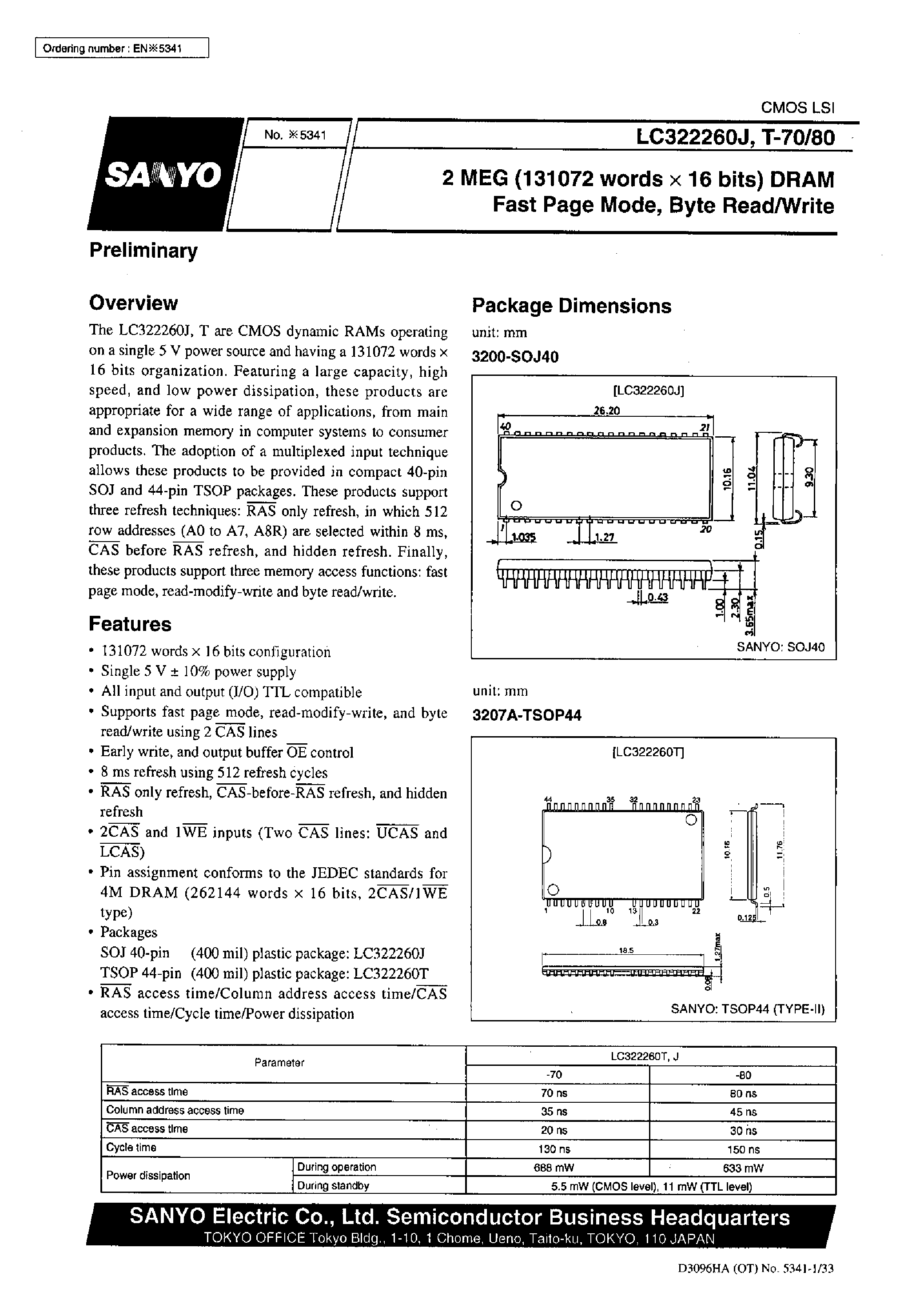

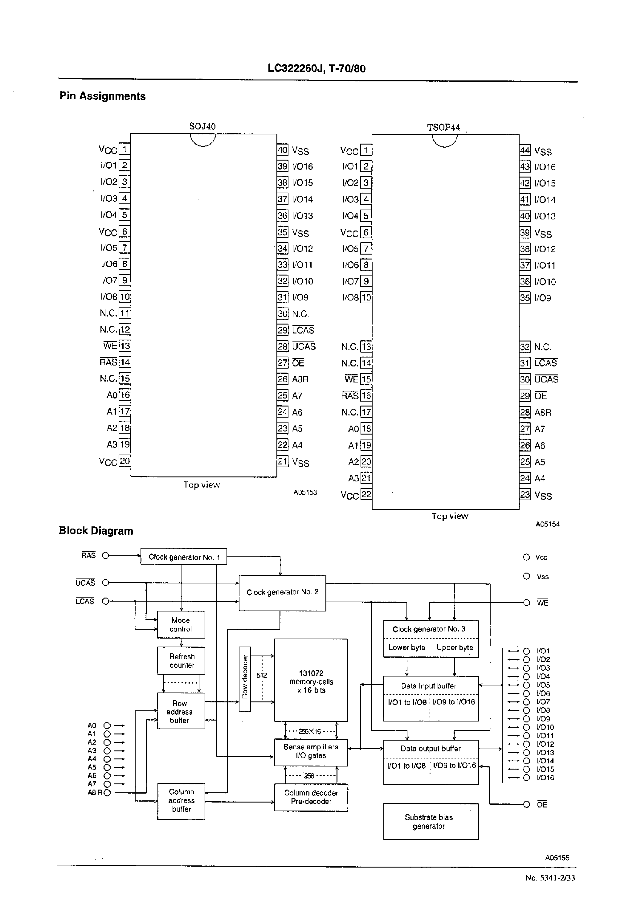

LC322260J-2 MEG (131072 words X 16 bits) DRAM Fast Page Mode / Byte Read/Write
Producer:Sanyo
Description:2 MEG (131072 words X 16 bits) DRAM Fast Page Mode / Byte Read/Write
Others with the same file: LC322260J
Datasheet LC322260J - 2 MEG (131072 words X 16 bits) DRAM Fast Page Mode / Byte Read/Write page 1
Datasheet LC322260J - 2 MEG (131072 words X 16 bits) DRAM Fast Page Mode / Byte Read/Write page 2
