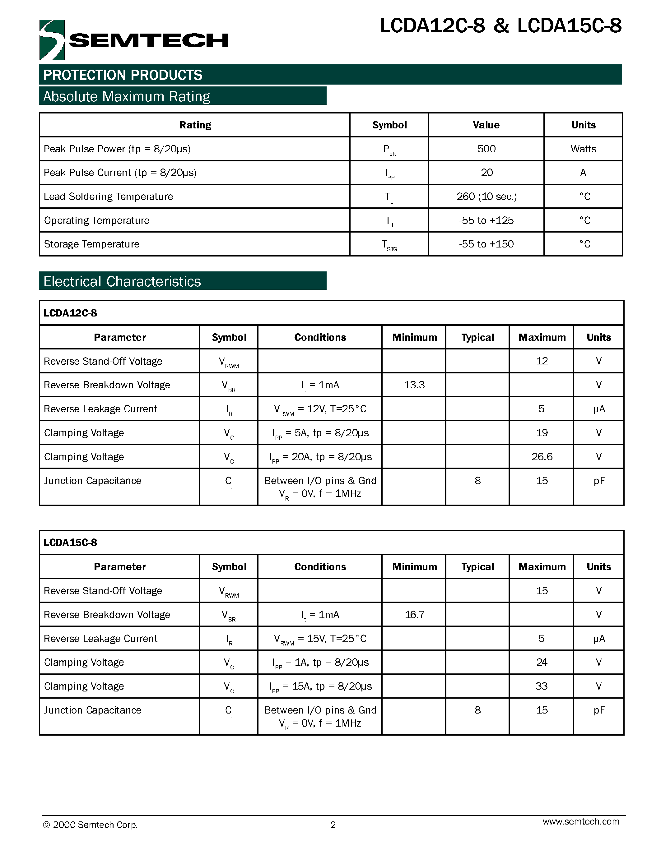

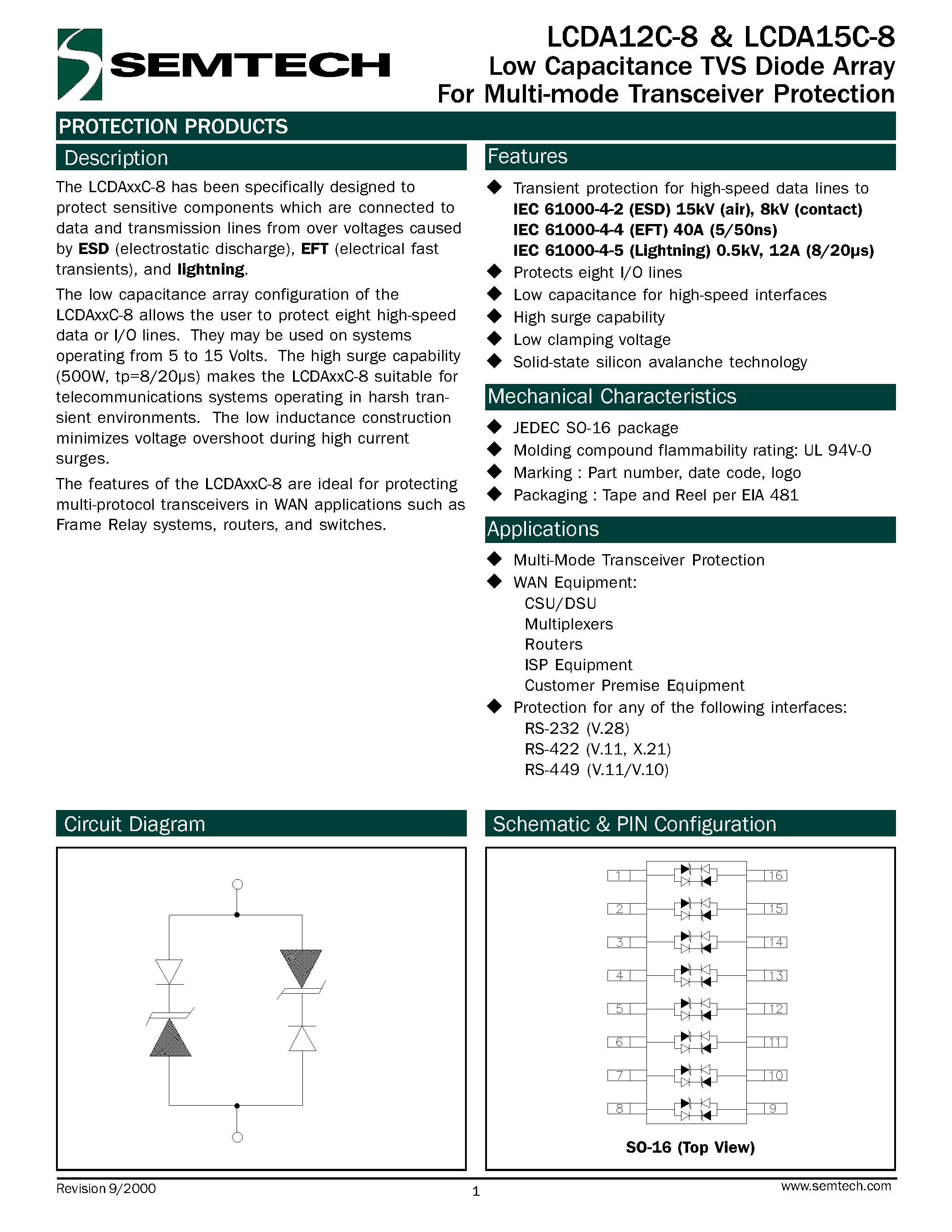

LCDA12C-8-Low Capacitance TVS Diode Array For Multi-mode Transceiver Protection
Producer:Semtech
Description:Low Capacitance TVS Diode Array For Multi-mode Transceiver Protection
Others with the same file: LCDA12C-8
Datasheet LCDA12C-8 - Low Capacitance TVS Diode Array For Multi-mode Transceiver Protection page 1
Datasheet LCDA12C-8 - Low Capacitance TVS Diode Array For Multi-mode Transceiver Protection page 2
