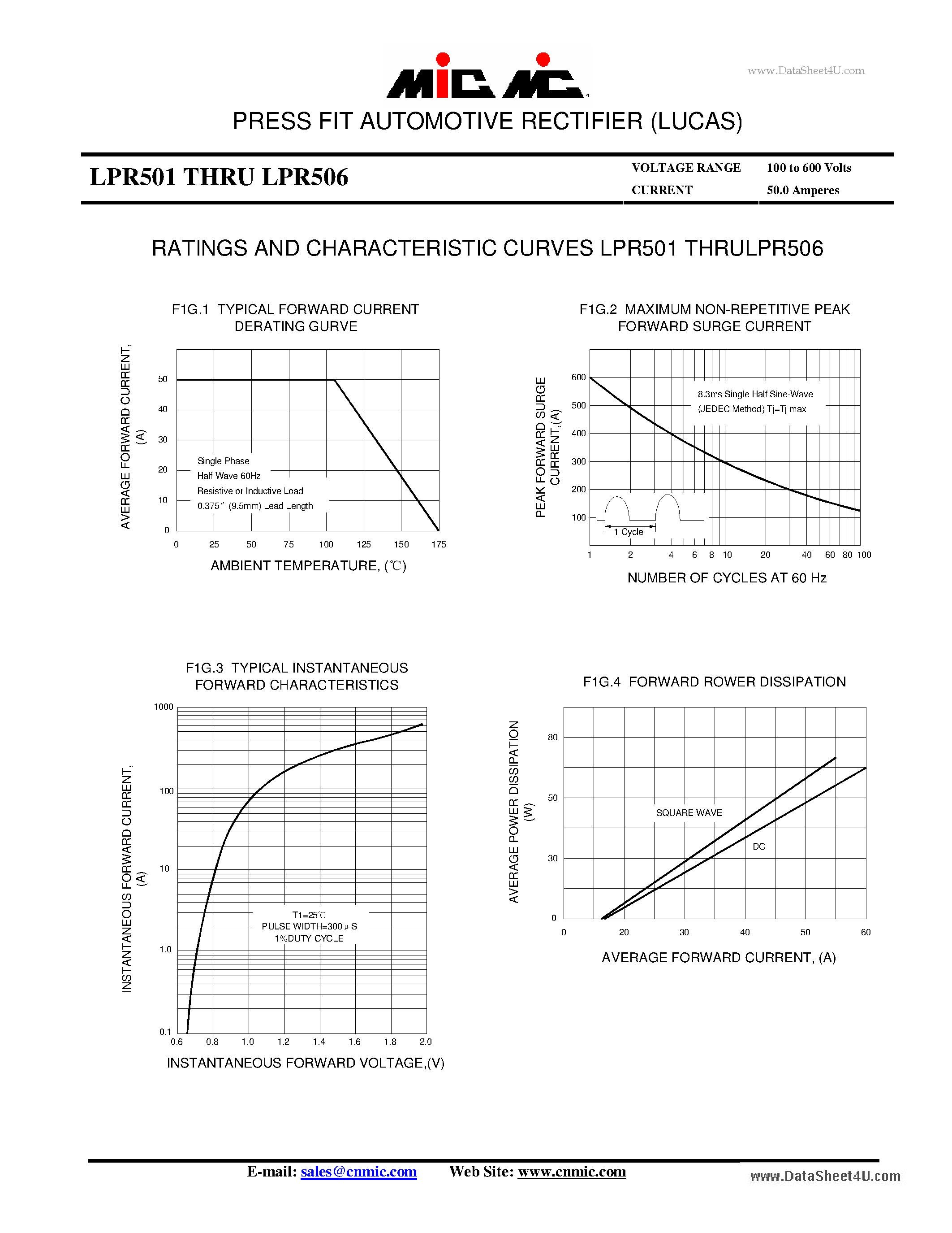

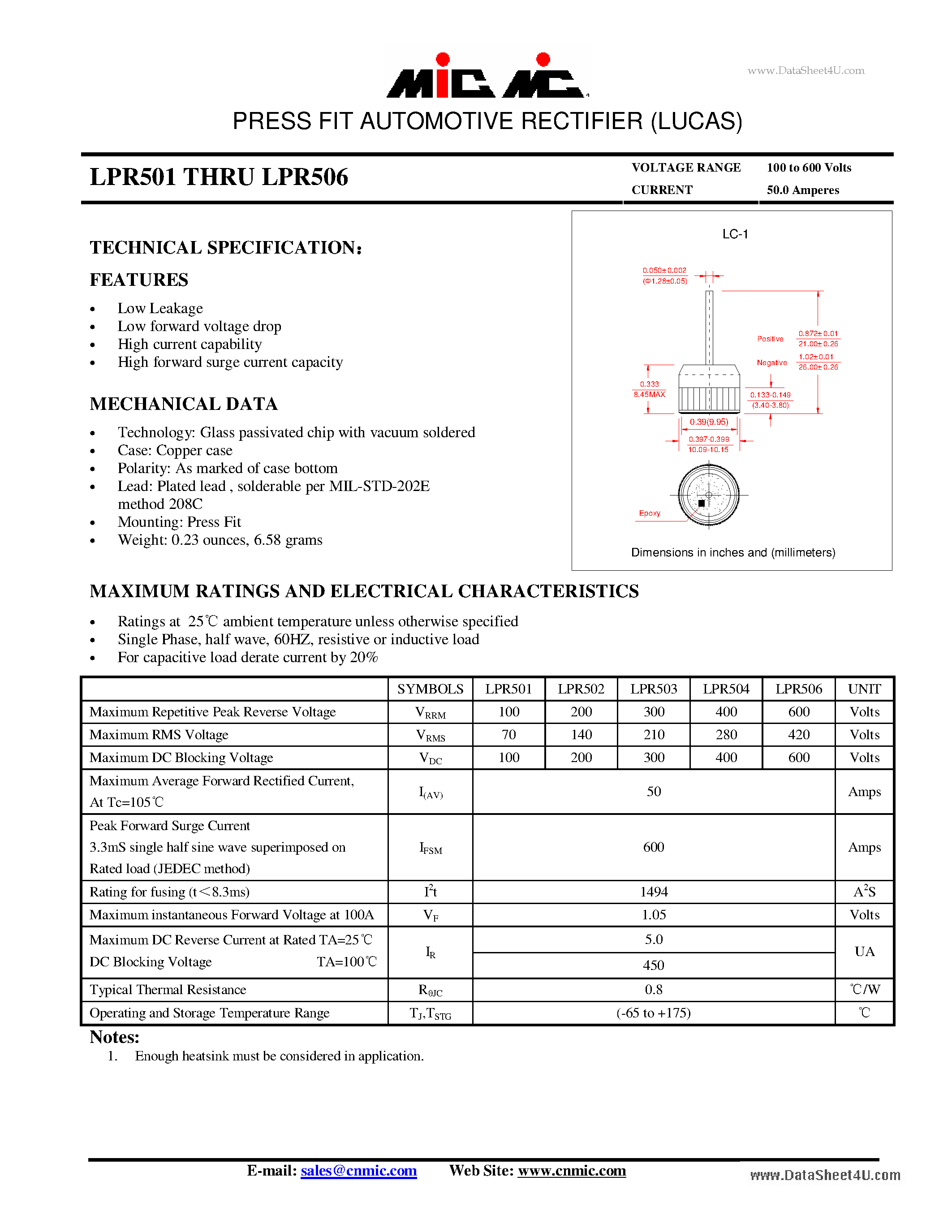

LPR501-PRESS FIT AUTOMOTIVE RECTIFIER (LUCAS)
Producer:MIC GROUP RECTIFIERS
Description:PRESS FIT AUTOMOTIVE RECTIFIER (LUCAS)
Others with the same file: LPR501 | LPR506
Datasheet LPR501 - PRESS FIT AUTOMOTIVE RECTIFIER (LUCAS) page 1
Datasheet LPR501 - PRESS FIT AUTOMOTIVE RECTIFIER (LUCAS) page 2
