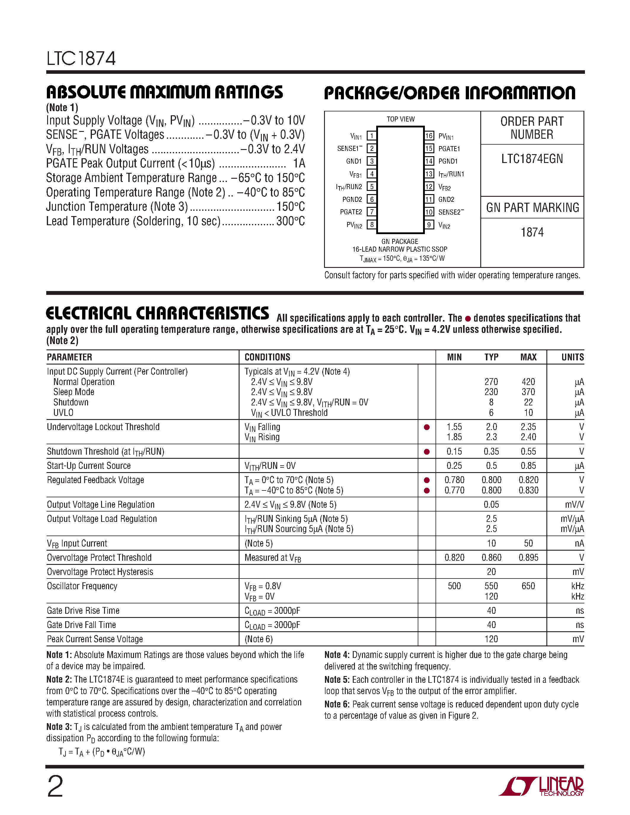

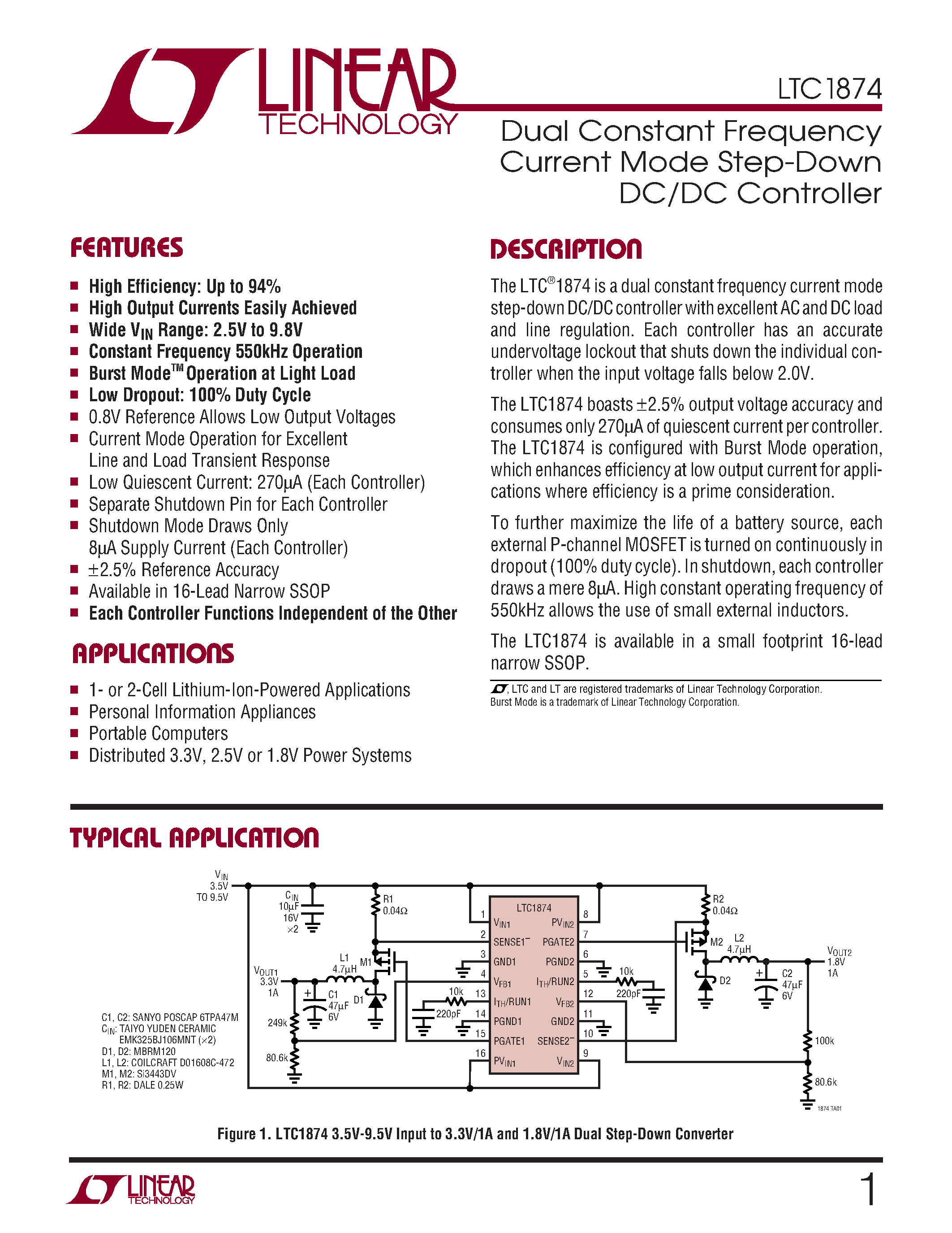

LTC1874-Dual Constant Frequency Current Mode Step-Down DC/DC Controller
Producer:Linear Technology
Description:Dual Constant Frequency Current Mode Step-Down DC/DC Controller
Others with the same file: LTC1874
Datasheet LTC1874 - Dual Constant Frequency Current Mode Step-Down DC/DC Controller page 1
Datasheet LTC1874 - Dual Constant Frequency Current Mode Step-Down DC/DC Controller page 2
