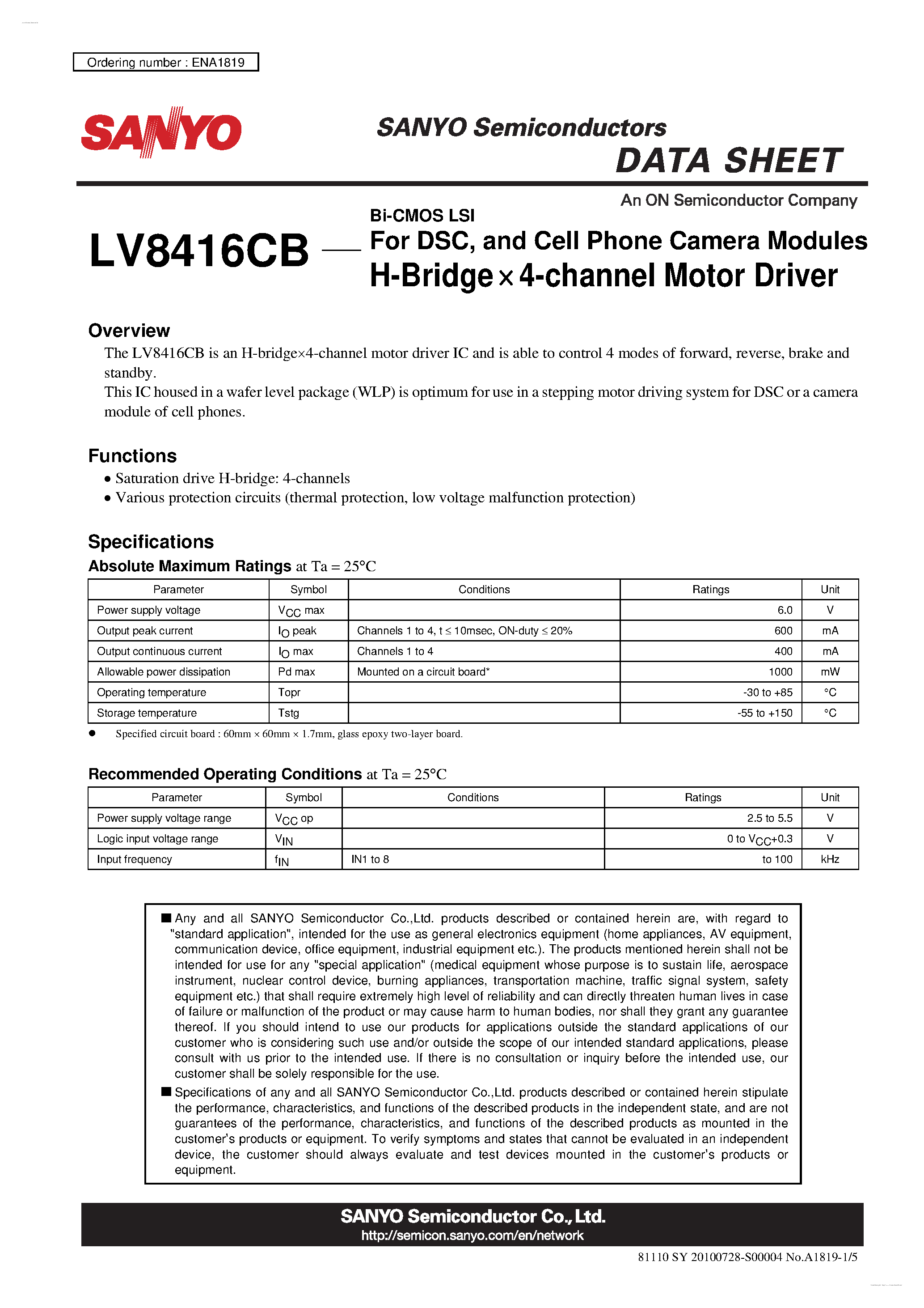

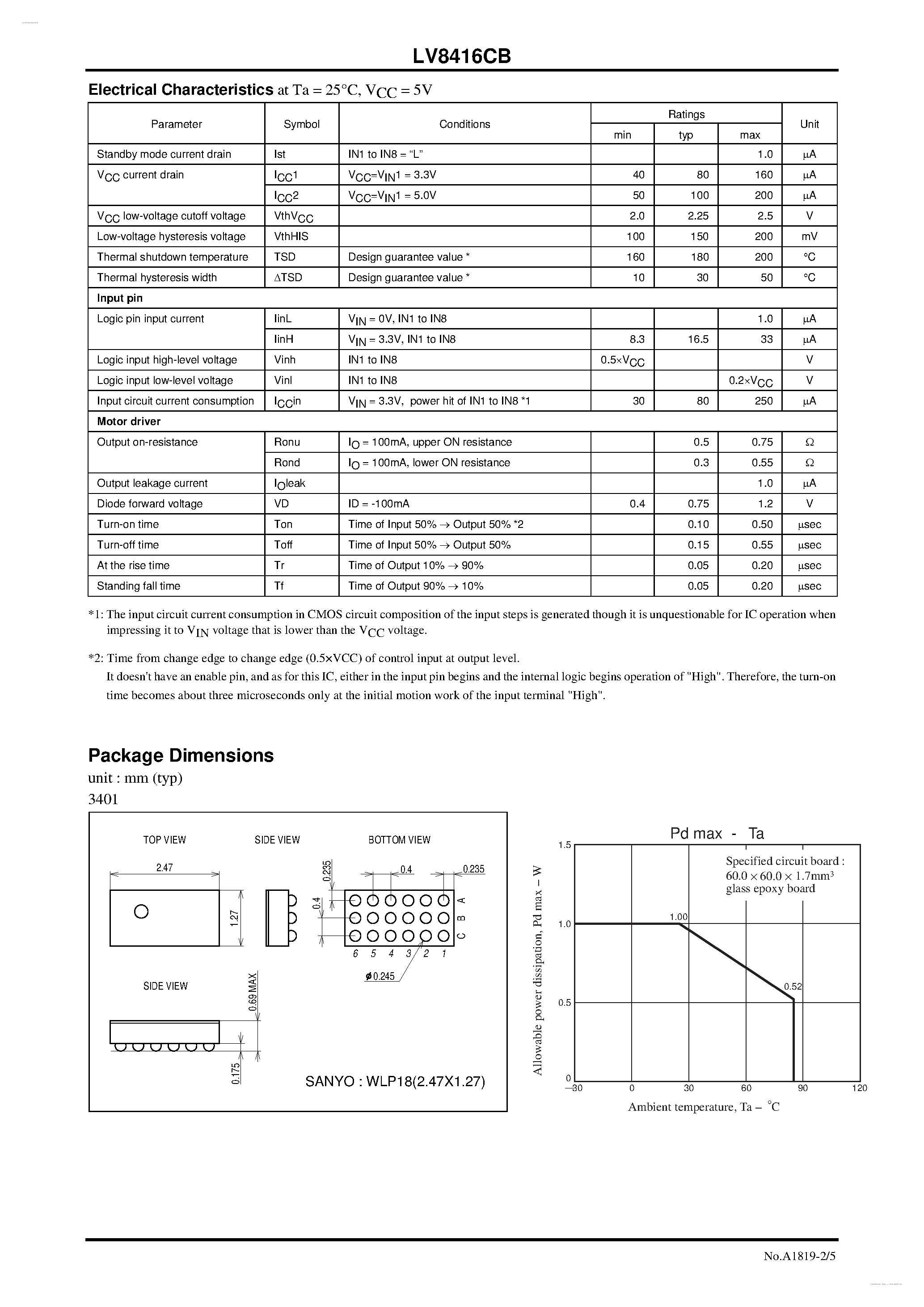

LV8416CB-H-Bridge x 4-channel Motor Driver
Producer:Sanyo Semicon Device
Description:H-Bridge x 4-channel Motor Driver
Others with the same file: LV8416CB
Datasheet LV8416CB - H-Bridge x 4-channel Motor Driver page 1
Datasheet LV8416CB - H-Bridge x 4-channel Motor Driver page 2
