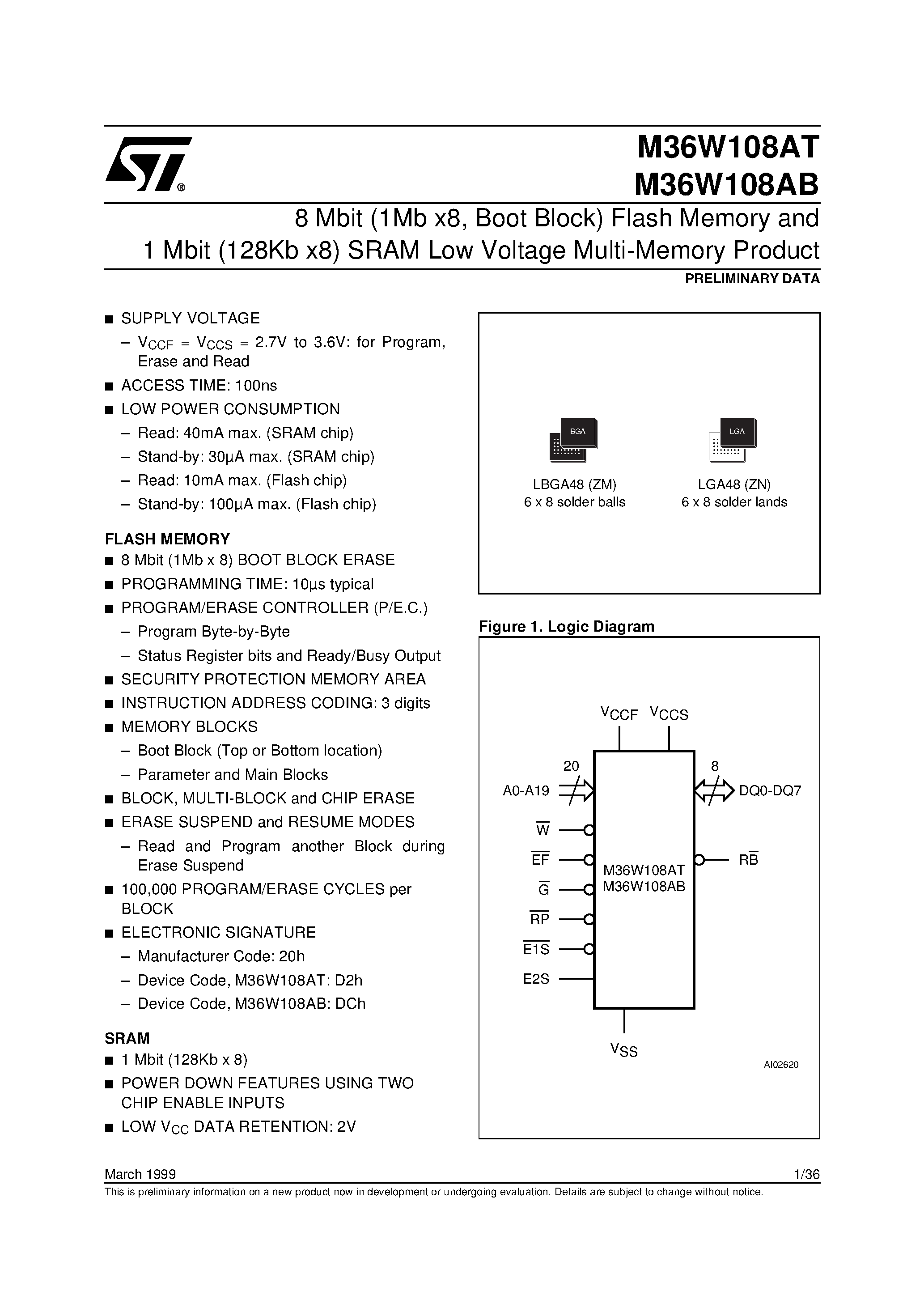

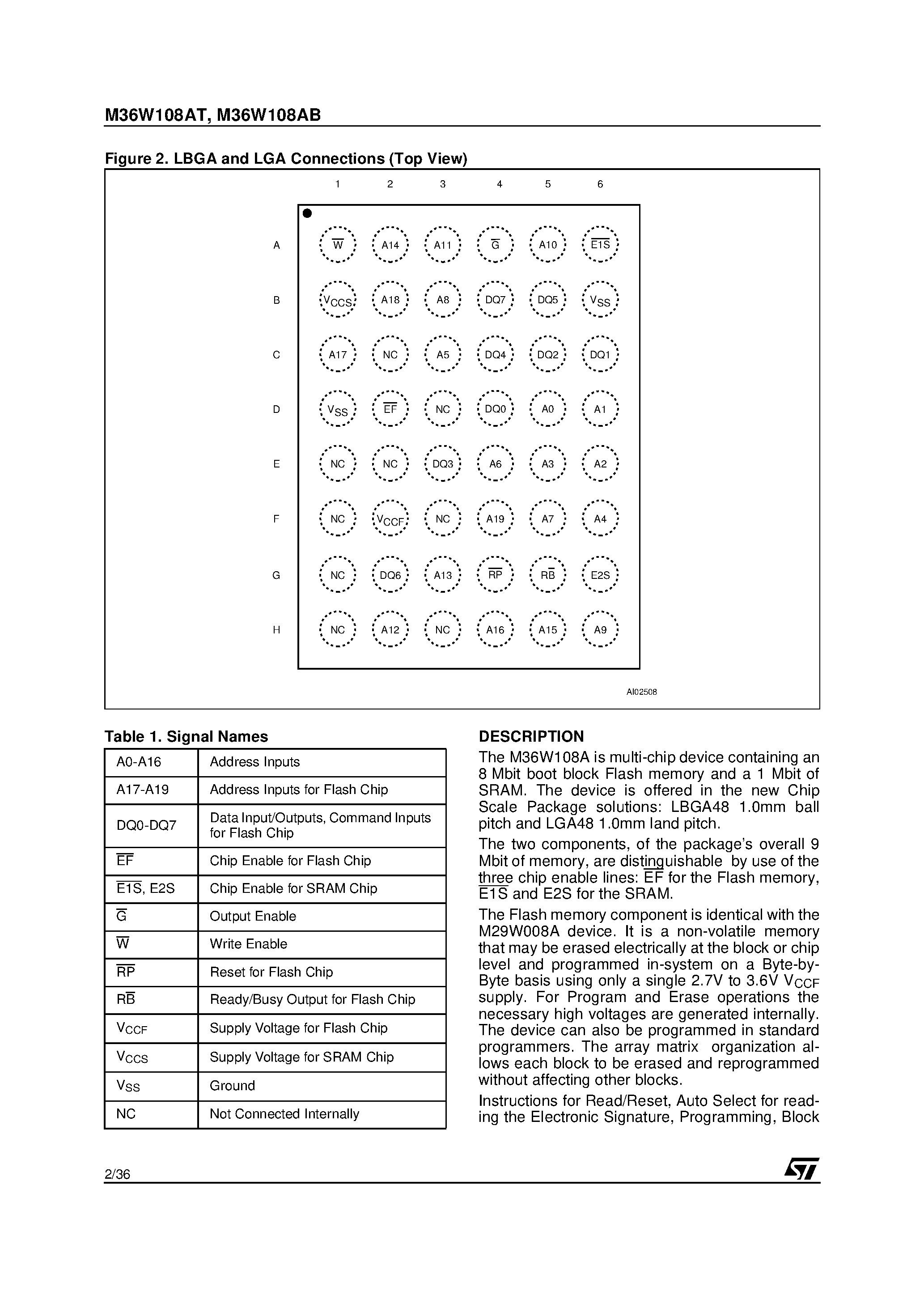

M36W108AT-8 Mbit 1Mb x8 / Boot Block Flash Memory and 1 Mbit 128Kb x8 SRAM Low Voltage Multi-Memory Product
Producer:ST Microelectronics
Description:8 Mbit 1Mb x8 / Boot Block Flash Memory and 1 Mbit 128Kb x8 SRAM Low Voltage Multi-Memory Product
