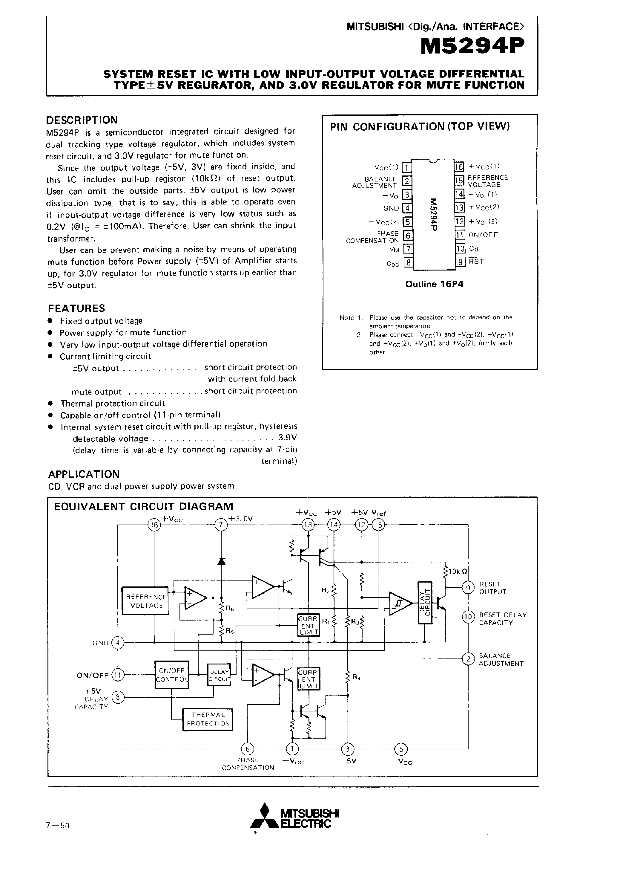

M5294P-SYSTEM RESET IC WITH LOW INPUT-OUTPUT VOLTAGE DIFFERENTIAL TYPE +-5V REGURATOR/AND 3.0V REGULATOR FOR MUTE FUNCTION
Producer:Mitsubishi
Description:SYSTEM RESET IC WITH LOW INPUT-OUTPUT VOLTAGE DIFFERENTIAL TYPE +-5V REGURATOR/AND 3.0V REGULATOR FOR MUTE FUNCTION
Others with the same file: M5294P
