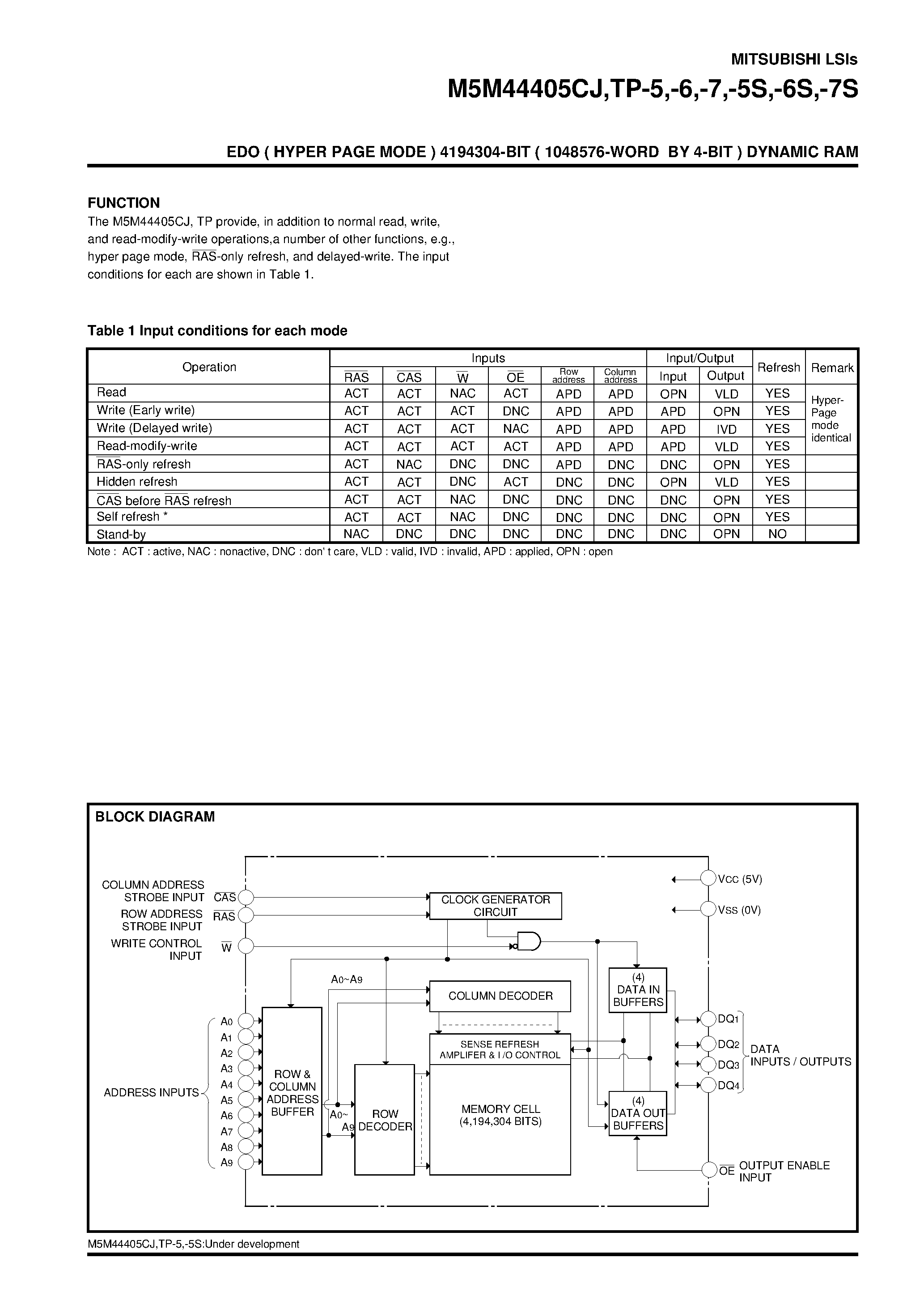

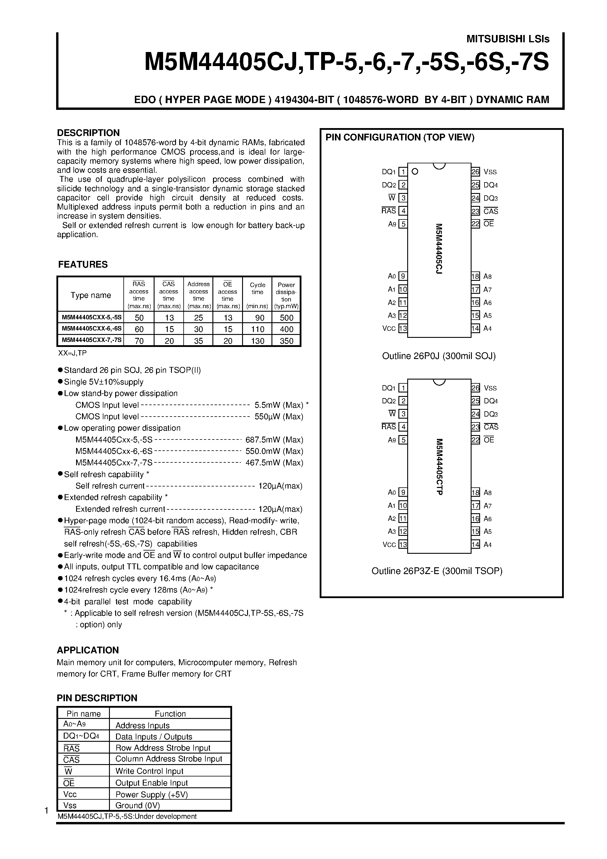

M5M44405CTP-7-EDO ( HYPER PAGE MODE ) 4194304-BIT ( 1048576-WORD BY 4-BIT ) DYNAMIC RAM
Producer:Mitsubishi
Description:EDO ( HYPER PAGE MODE ) 4194304-BIT ( 1048576-WORD BY 4-BIT ) DYNAMIC RAM
Others with the same file: M5M44405CTP-7
Datasheet M5M44405CTP-7 - EDO ( HYPER PAGE MODE ) 4194304-BIT ( 1048576-WORD BY 4-BIT ) DYNAMIC RAM page 1
