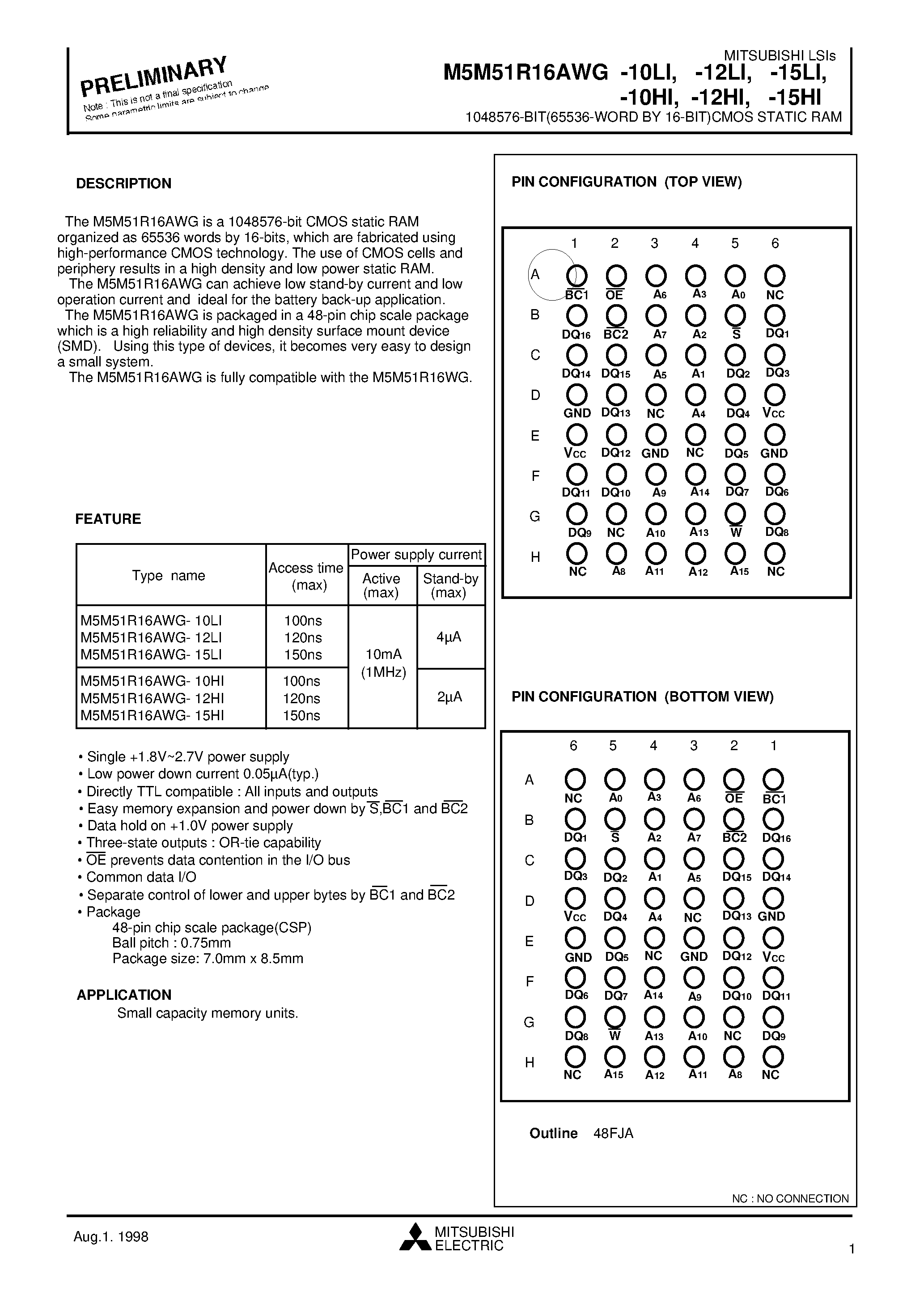

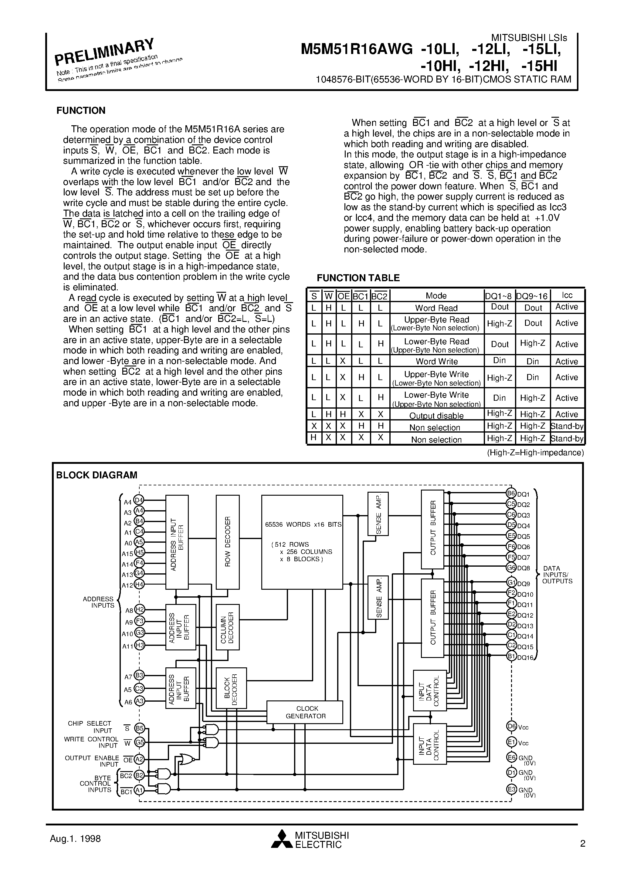

M5M51R16AWG-15HI-1048576-BIT(65536-WORD BY 16-BIT)CMOS STATIC RAM
Producer:Mitsubishi
Description:1048576-BIT(65536-WORD BY 16-BIT)CMOS STATIC RAM
