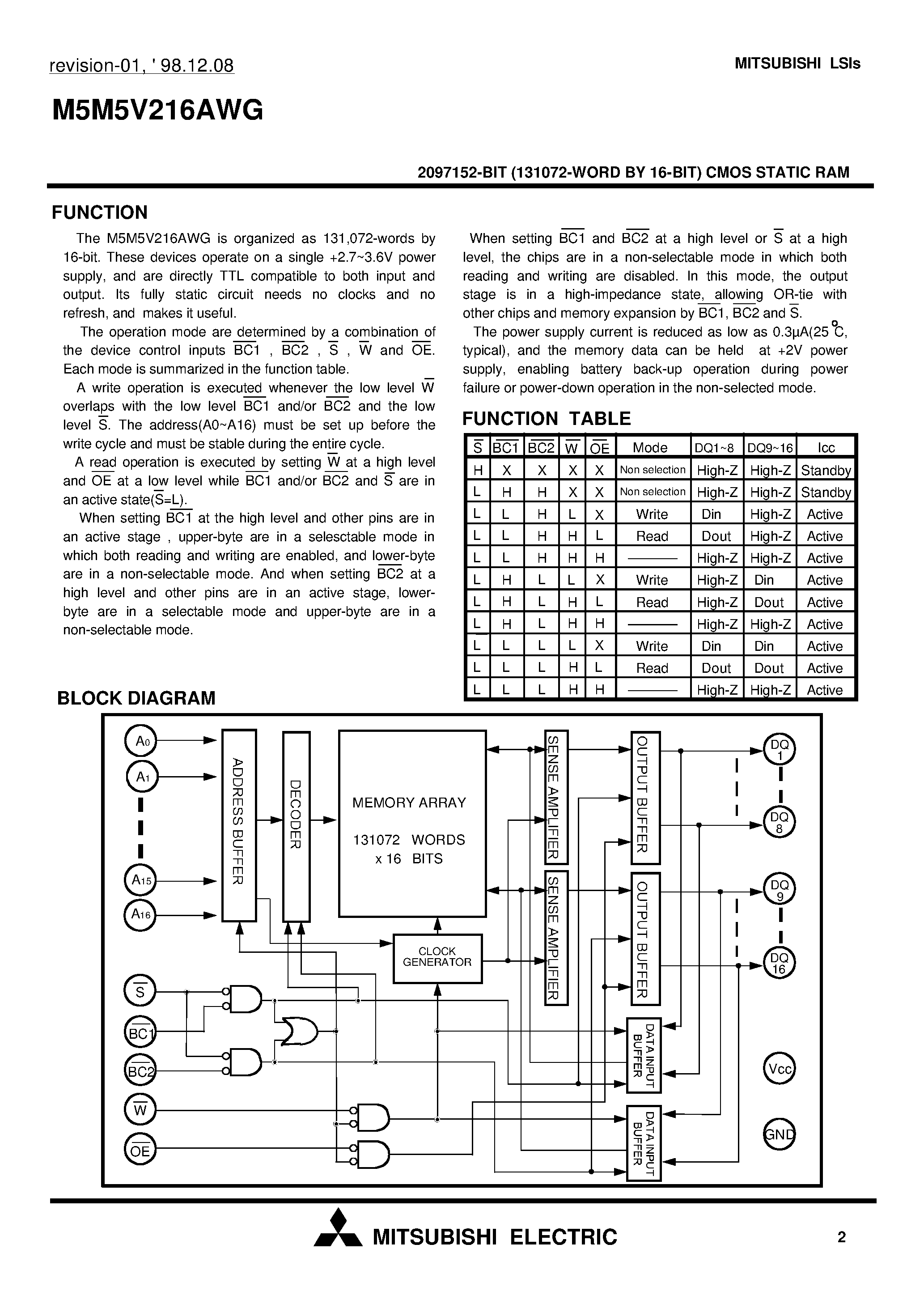

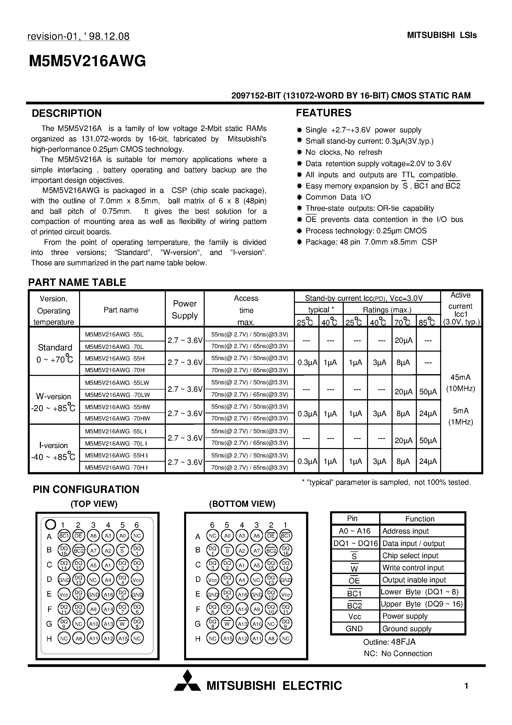

M5M5V216AWG-2097152-BIT (131072-WORD BY 16-BIT) CMOS STATIC RAM
Producer:Mitsubishi
Description:2097152-BIT (131072-WORD BY 16-BIT) CMOS STATIC RAM
