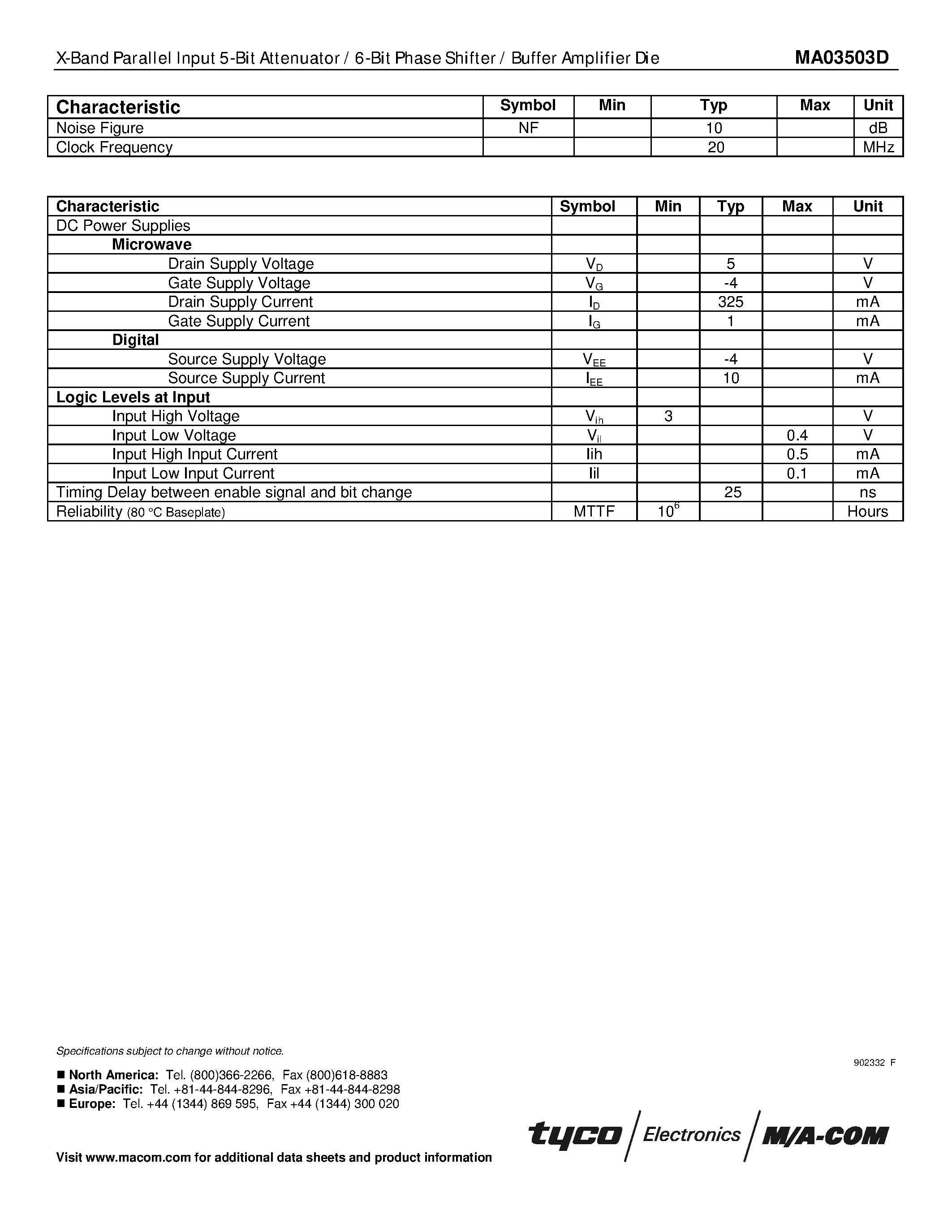

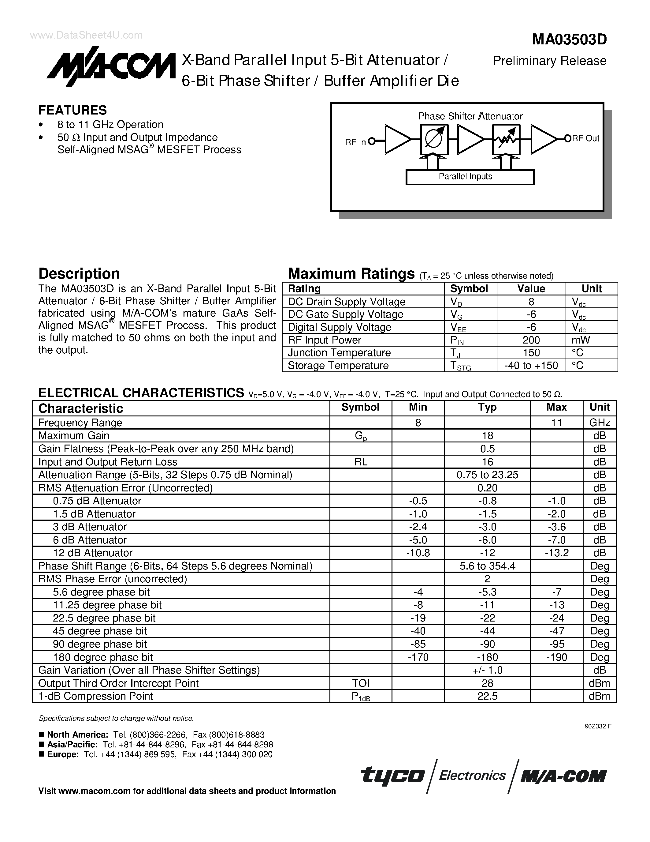

MA03503D-X-Band Parallel Input 5-Bit Attenuator / 6-Bit Phase Shifter / Buffer Amplifier Die
Producer:Tyco Electronics
Description:X-Band Parallel Input 5-Bit Attenuator / 6-Bit Phase Shifter / Buffer Amplifier Die
Others with the same file: MA03503D
Datasheet MA03503D - X-Band Parallel Input 5-Bit Attenuator / 6-Bit Phase Shifter / Buffer Amplifier Die page 1
Datasheet MA03503D - X-Band Parallel Input 5-Bit Attenuator / 6-Bit Phase Shifter / Buffer Amplifier Die page 2
