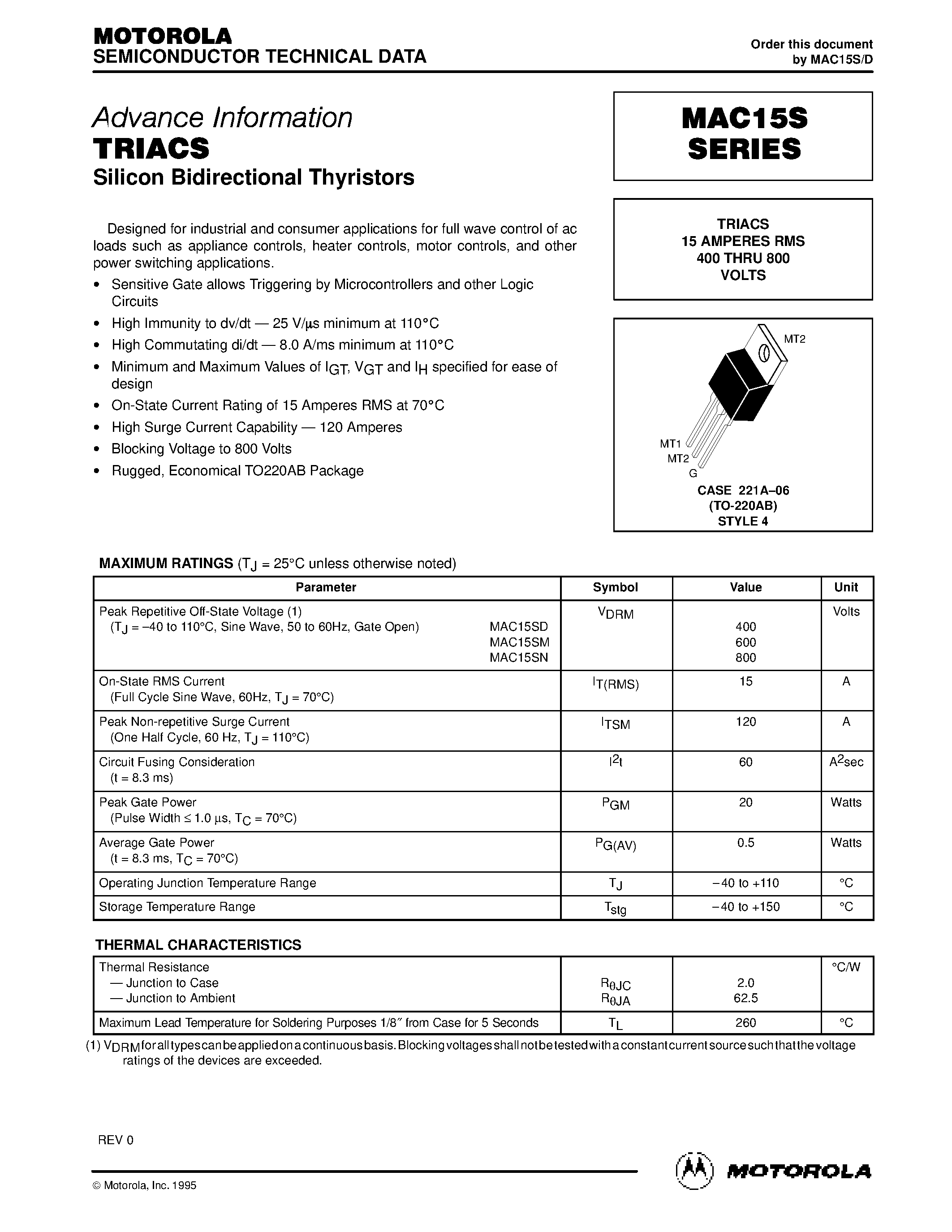

MAC15SN-TRIACS 15 AMPERES RMS 400 THRU 800 VOLTS
Producer:Motorola
Description:TRIACS 15 AMPERES RMS 400 THRU 800 VOLTS
Others with the same file: MAC15SN

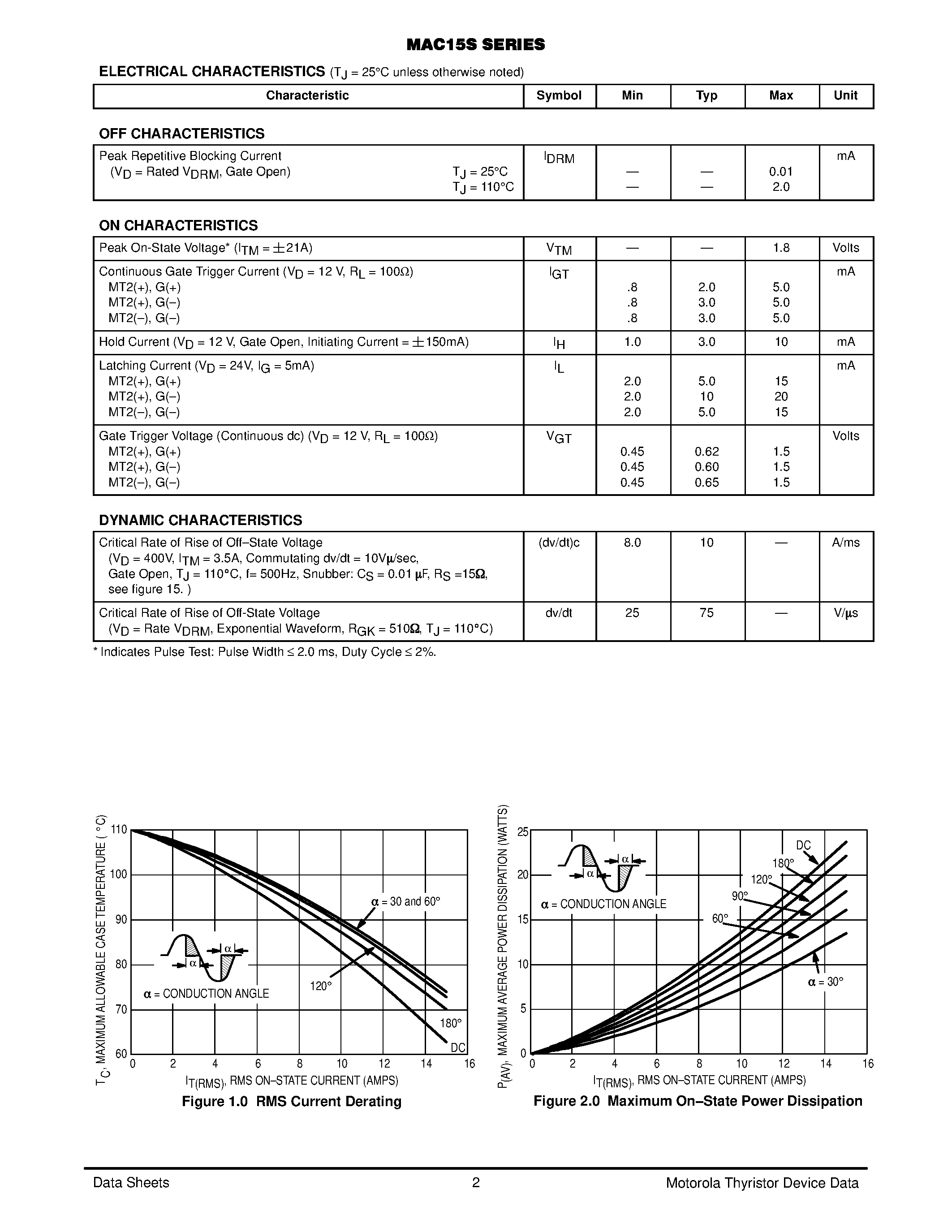

Datasheet MAC15SN - TRIACS 15 AMPERES RMS 400 THRU 800 VOLTS page 1
Datasheet MAC15SN - TRIACS 15 AMPERES RMS 400 THRU 800 VOLTS page 2
