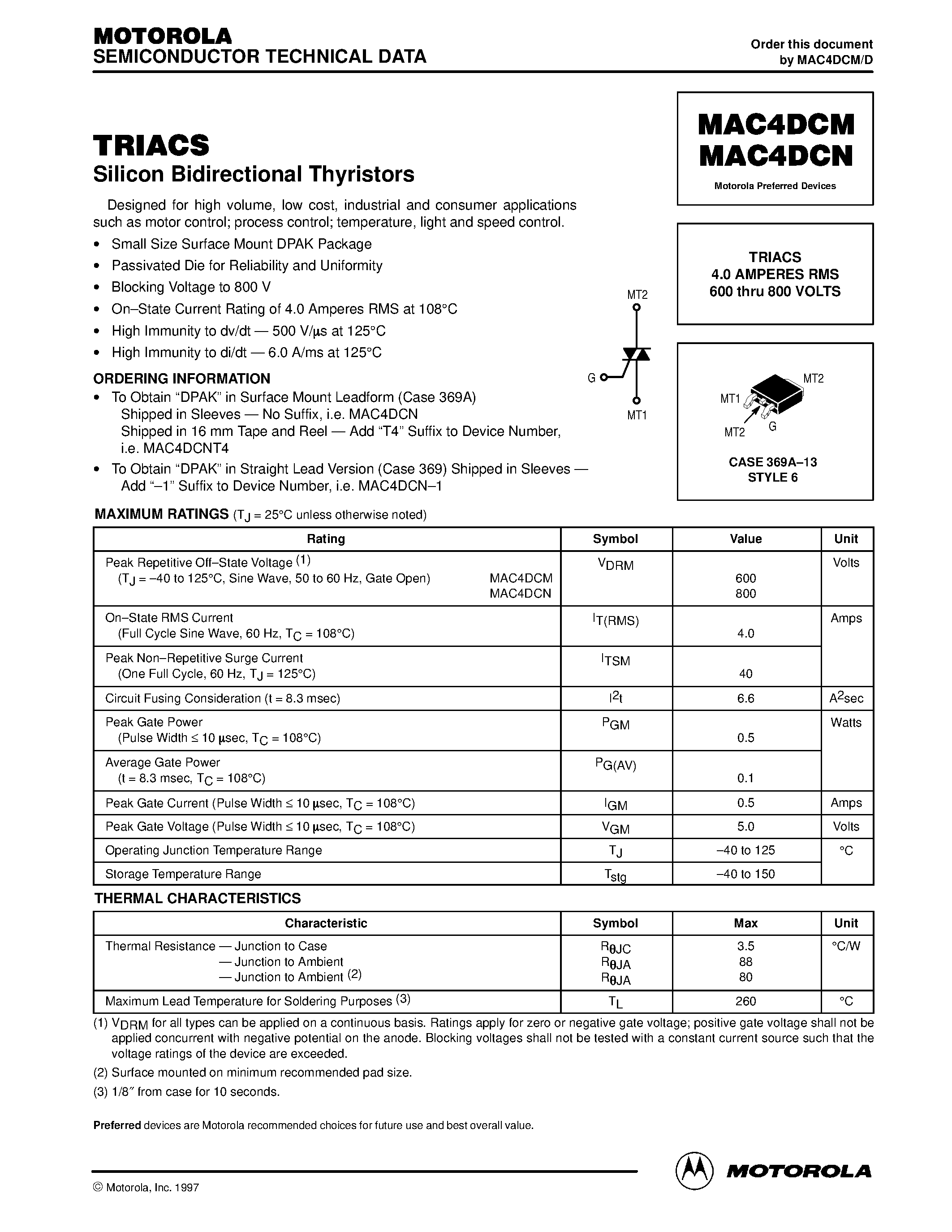

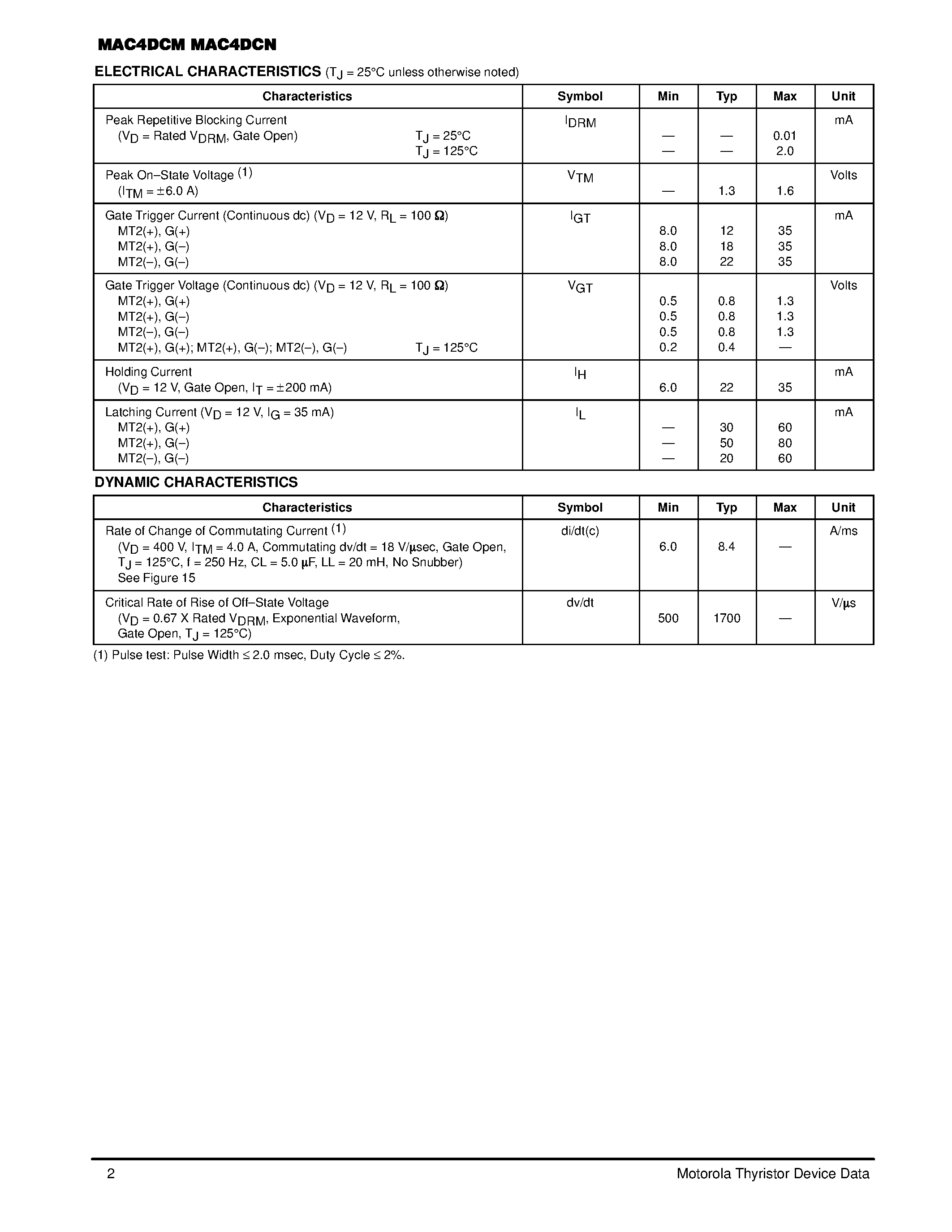

MAC4DCM-TRIACS 4.0 AMPERES RMS 600 thru 800 VOLTS
Producer:Motorola
Description:TRIACS 4.0 AMPERES RMS 600 thru 800 VOLTS
Others with the same file: MAC4DCM
Datasheet MAC4DCM - TRIACS 4.0 AMPERES RMS 600 thru 800 VOLTS page 1
Datasheet MAC4DCM - TRIACS 4.0 AMPERES RMS 600 thru 800 VOLTS page 2
