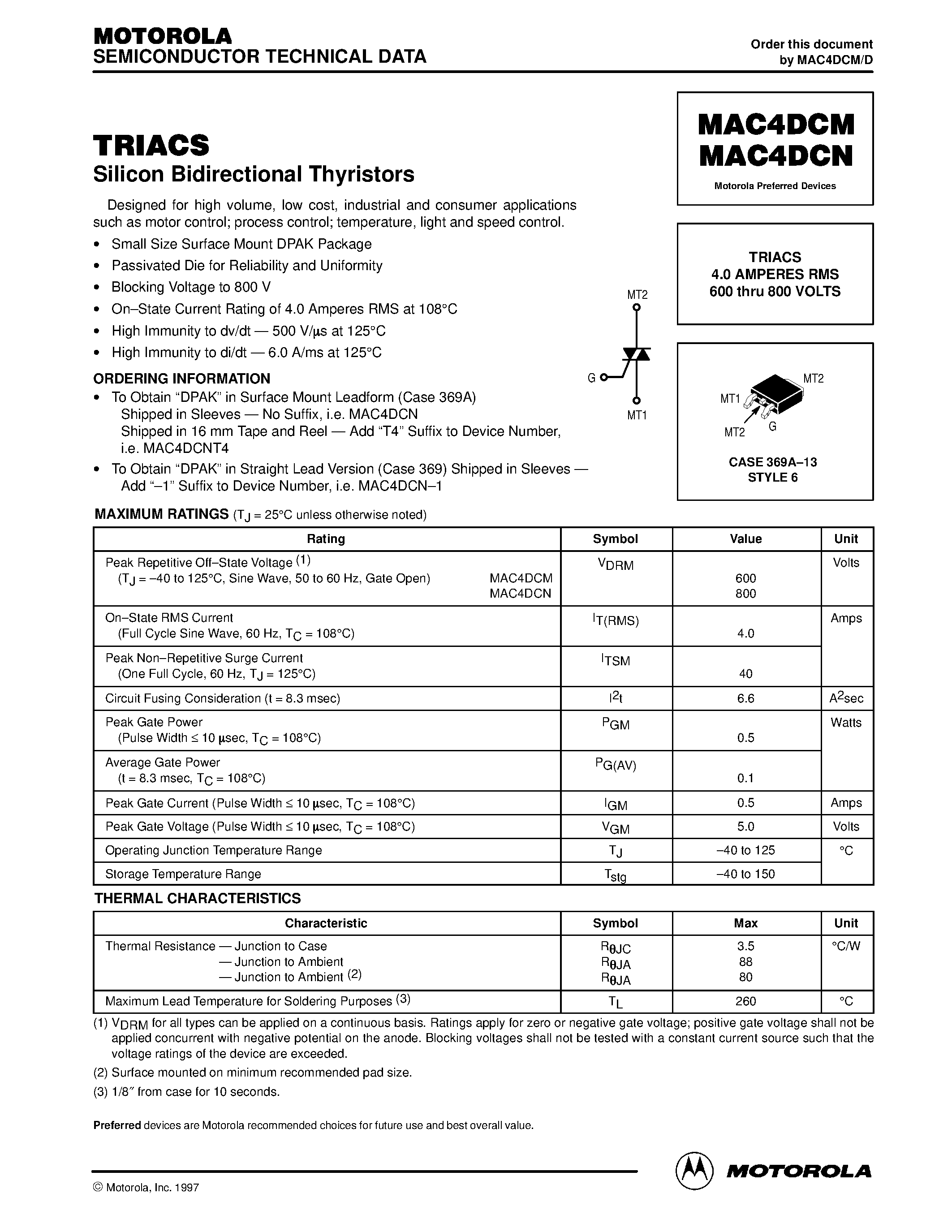

MAC4DCN-TRIACS 4.0 AMPERES RMS 600 thru 800 VOLTS
Producer:Motorola
Description:TRIACS 4.0 AMPERES RMS 600 thru 800 VOLTS
Others with the same file: MAC4DCN
Datasheet MAC4DCN - TRIACS 4.0 AMPERES RMS 600 thru 800 VOLTS page 1

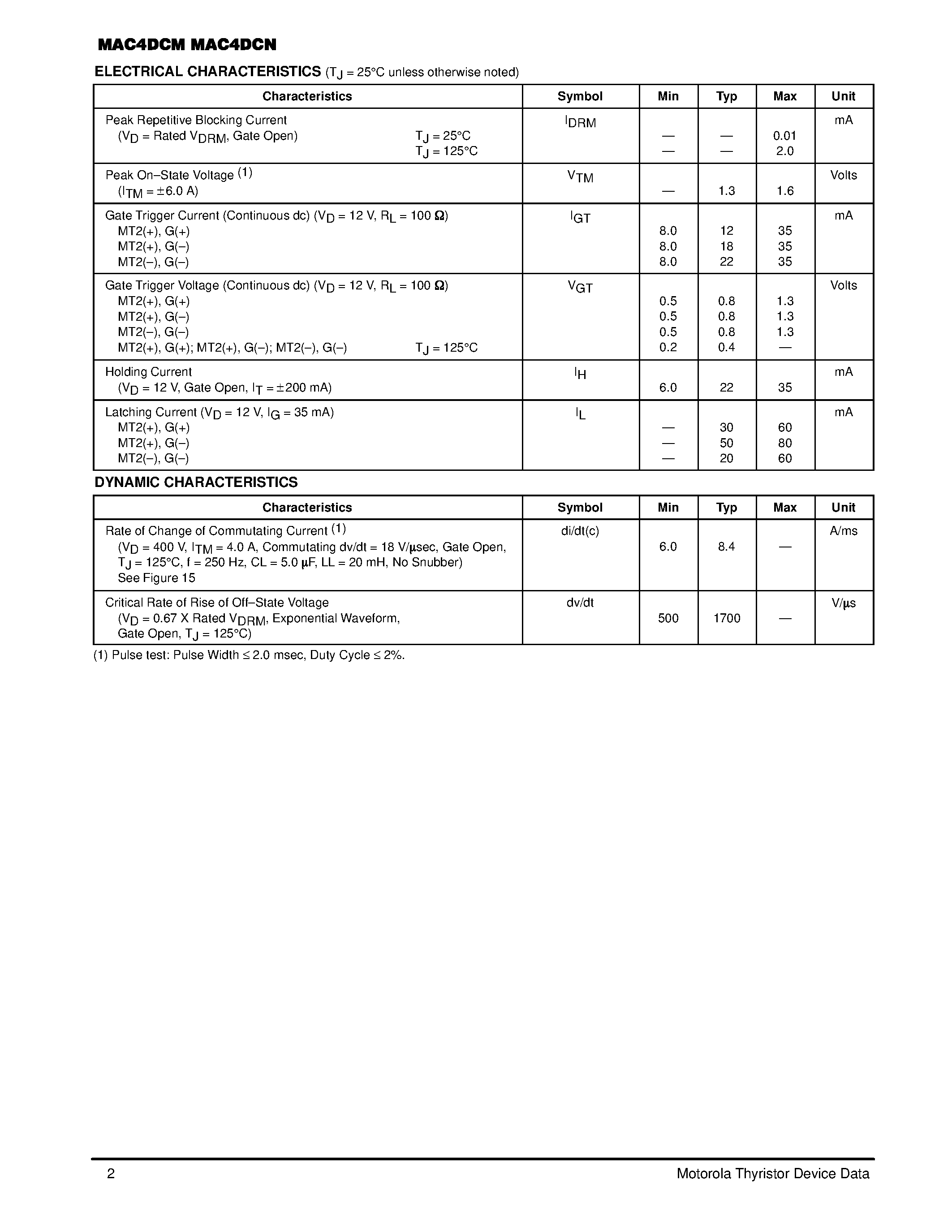

Datasheet MAC4DCN - TRIACS 4.0 AMPERES RMS 600 thru 800 VOLTS page 2
