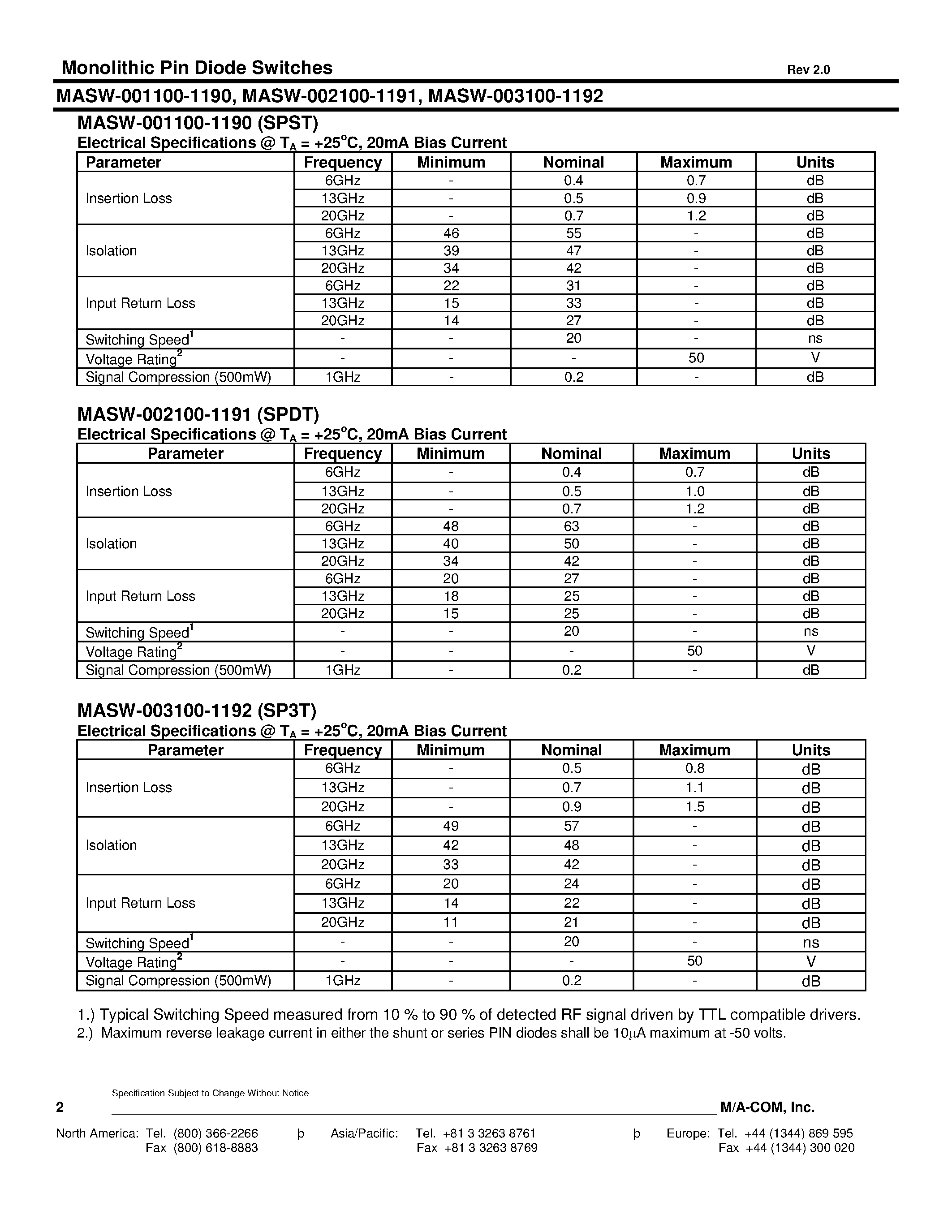

MASW-001100-1190-(MASW-00x100-119x) Broadband Monolithic Silicon PIN Diode Switches
Producer:Tyco Electronics
Description:(MASW-00x100-119x) Broadband Monolithic Silicon PIN Diode Switches
