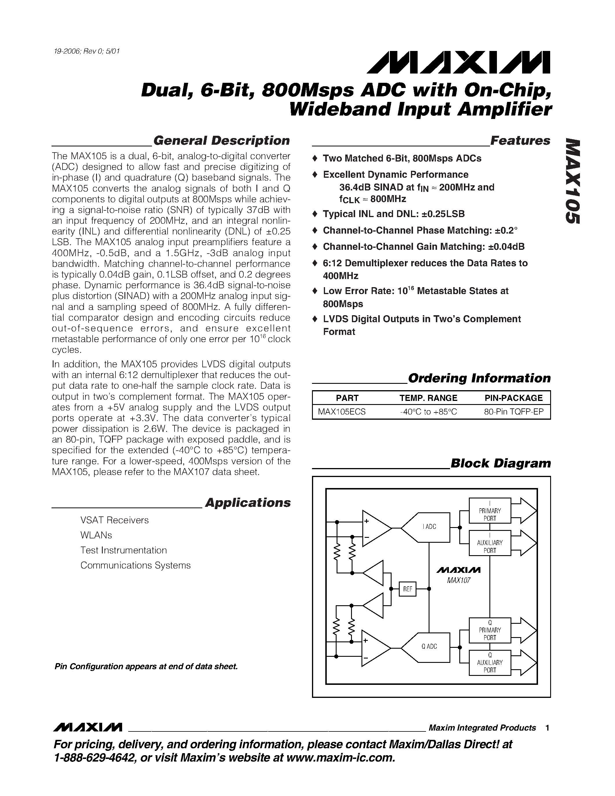

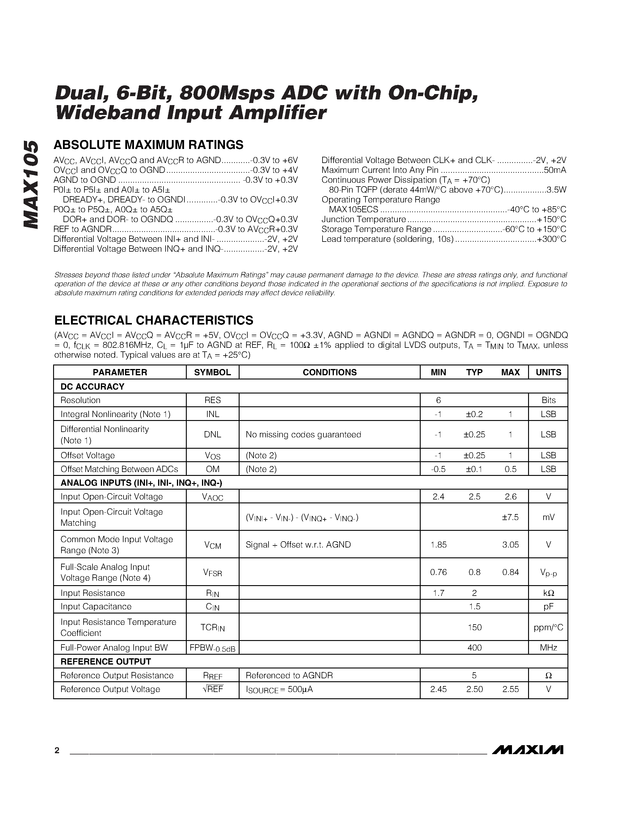

MAX105ECS-Dual / 6-Bit / 800Msps ADC with On-Chip / Wideband Input Amplifier
Producer:Maxim
Description:Dual / 6-Bit / 800Msps ADC with On-Chip / Wideband Input Amplifier
