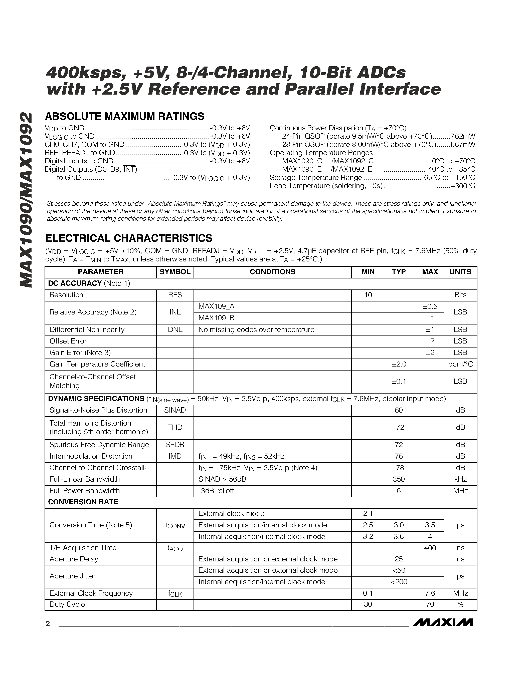

MAX1090AEEI-400ksps / +5V / 8-/4-Channel / 10-Bit ADCs with +2.5V Reference and Parallel Interface
Producer:Maxim
Description:400ksps / +5V / 8-/4-Channel / 10-Bit ADCs with +2.5V Reference and Parallel Interface
