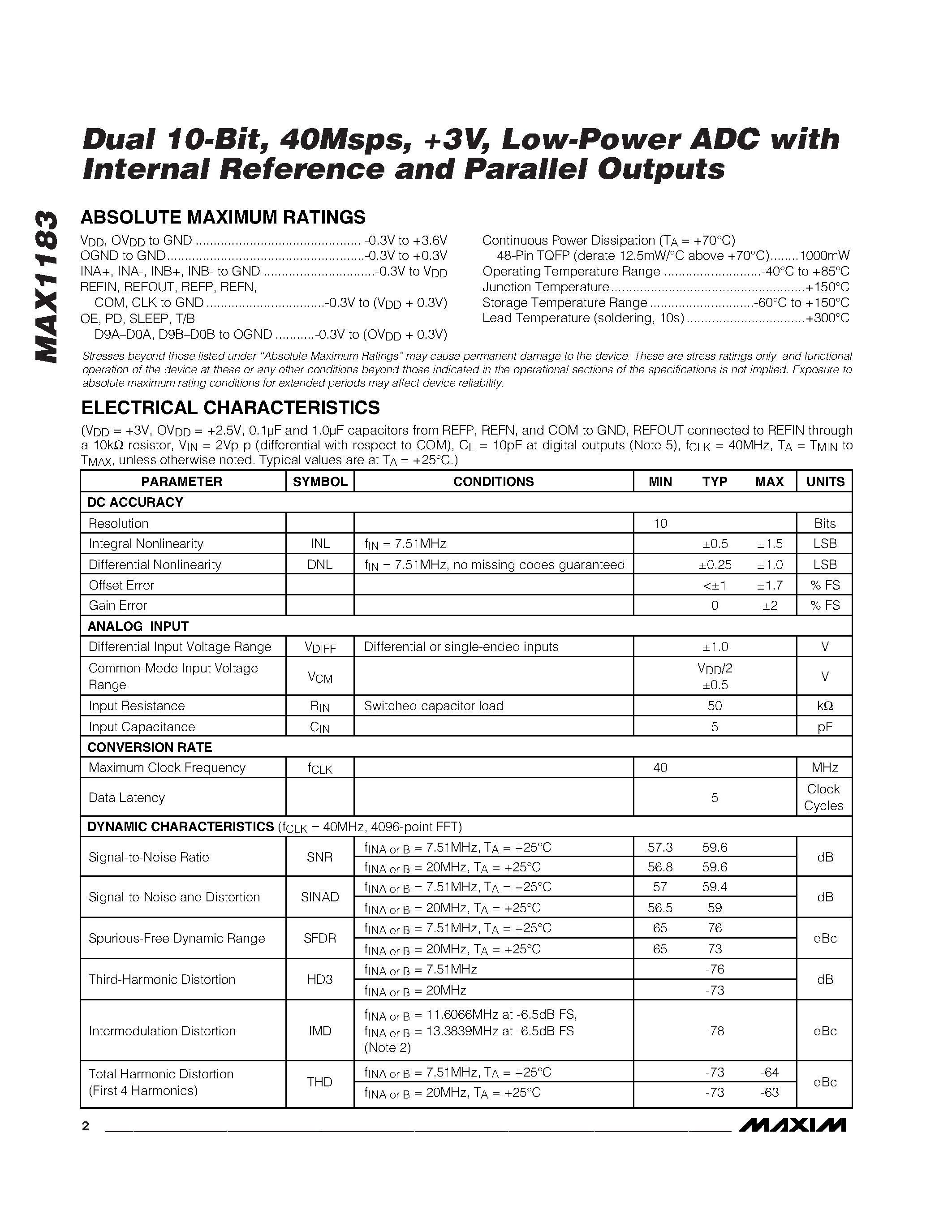

MAX1183-Dual 10-Bit / 40Msps / +3V / Low-Power ADC with Internal Reference and Parallel Outputs
Producer:Maxim
Description:Dual 10-Bit / 40Msps / +3V / Low-Power ADC with Internal Reference and Parallel Outputs
