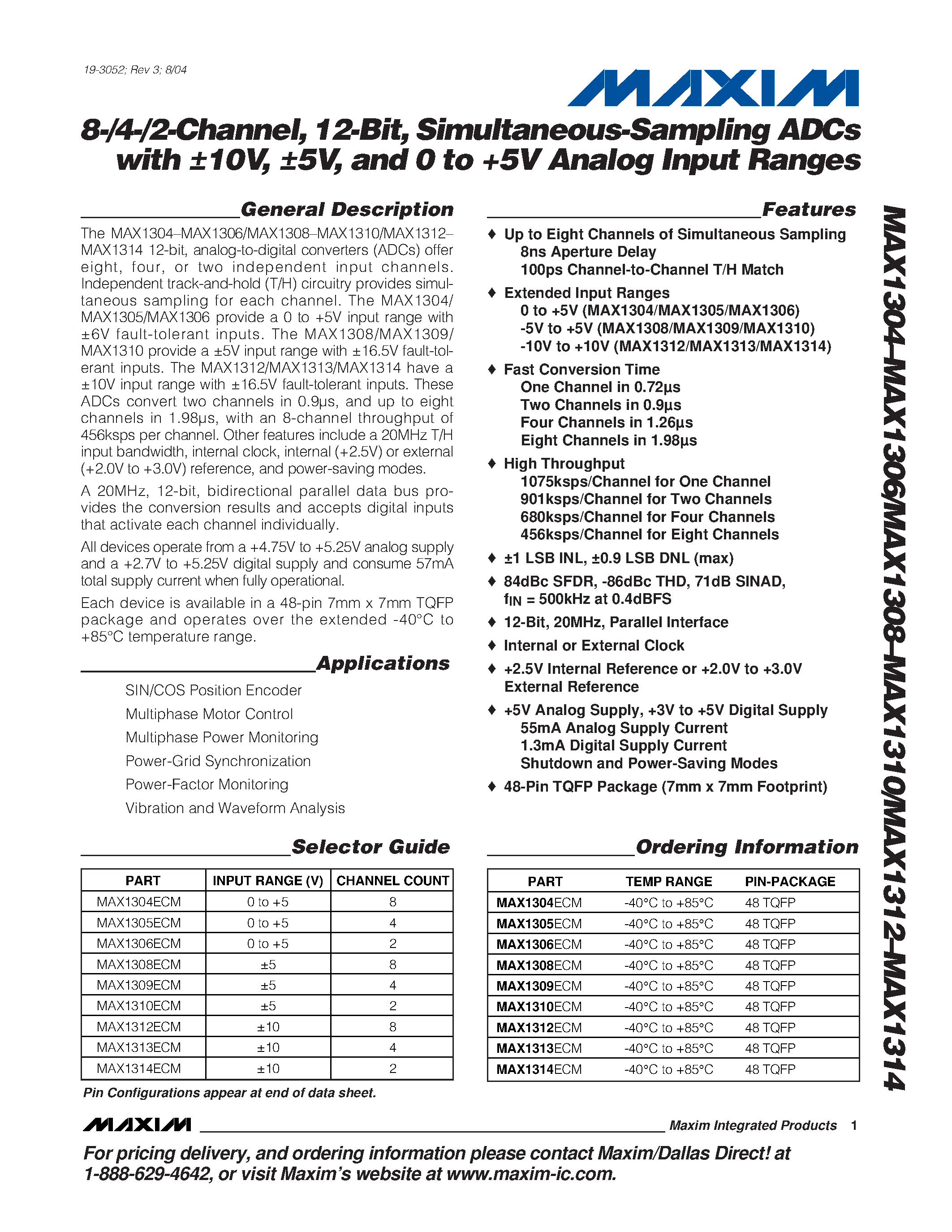

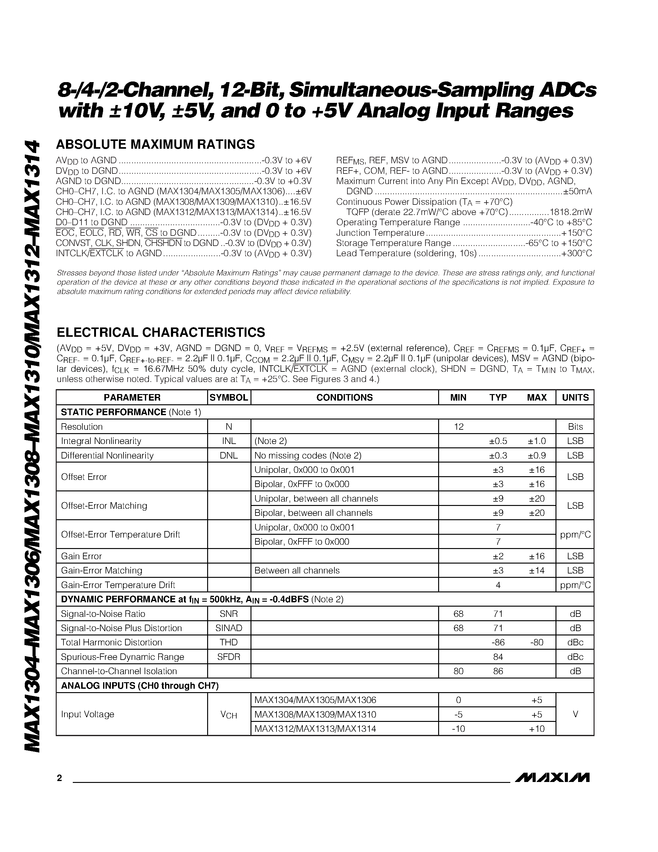

MAX1305-8-/4-/2-Channel / 12-Bit / Simultaneous-Sampling ADCs with 10V / 5V / and 0 to +5V Analog Input Ranges
Producer:Maxim
Description:8-/4-/2-Channel / 12-Bit / Simultaneous-Sampling ADCs with 10V / 5V / and 0 to +5V Analog Input Ranges
