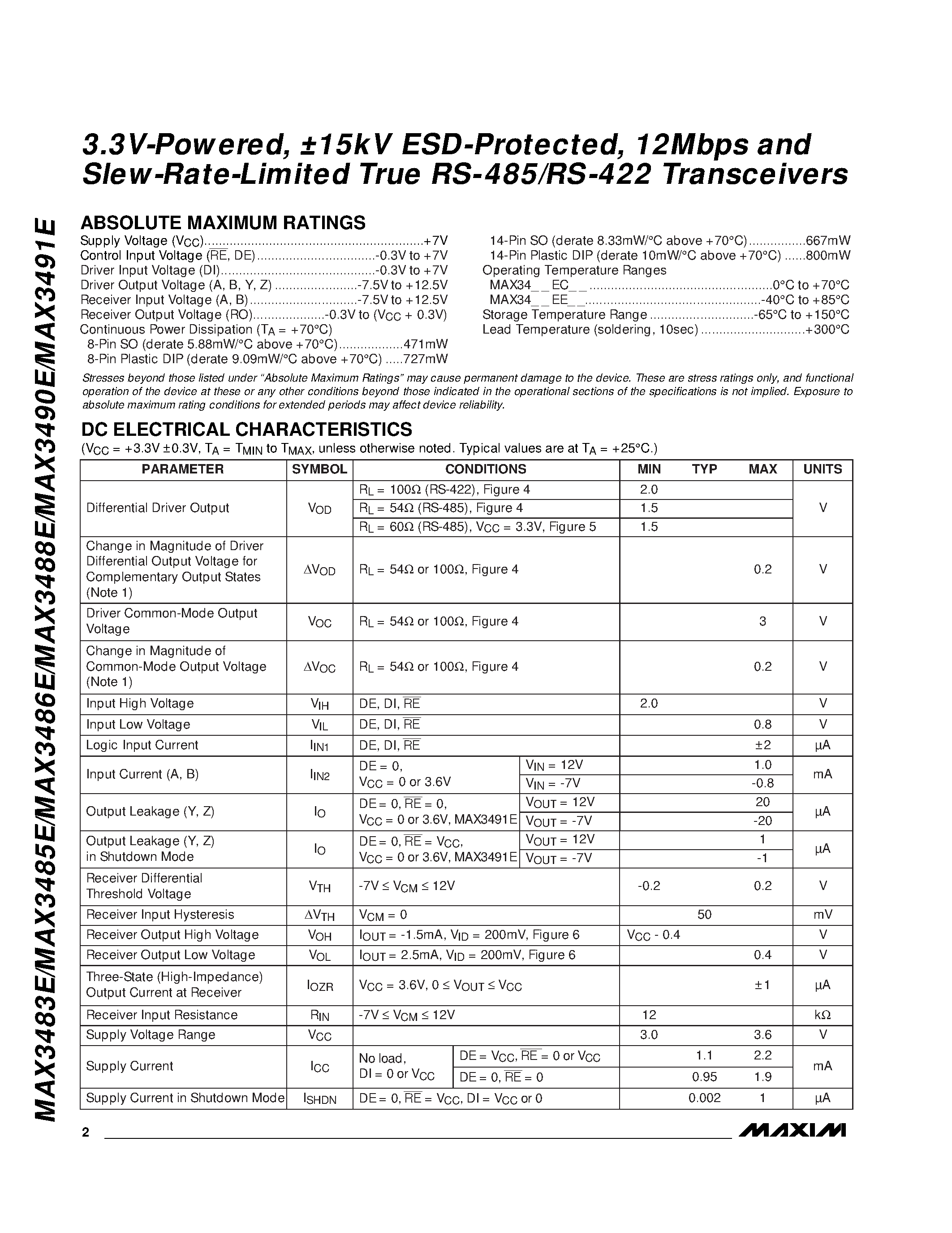

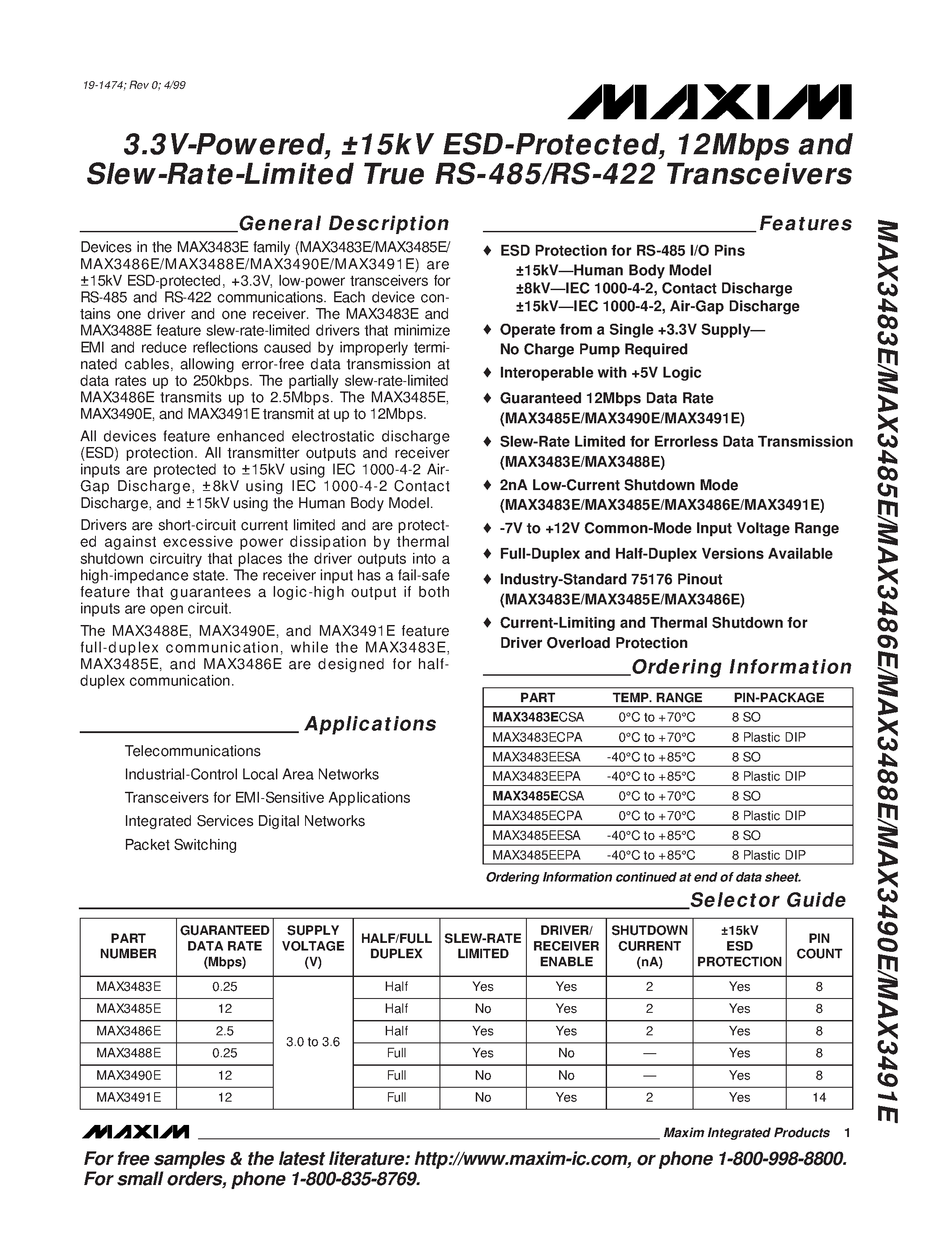

MAX3485EEPA-3.3V-Powered / 15kV ESD-Protected / 12Mbps and Slew-Rate-Limited True RS-485/RS-422 Transceivers
Producer:Maxim
Description:3.3V-Powered / 15kV ESD-Protected / 12Mbps and Slew-Rate-Limited True RS-485/RS-422 Transceivers
