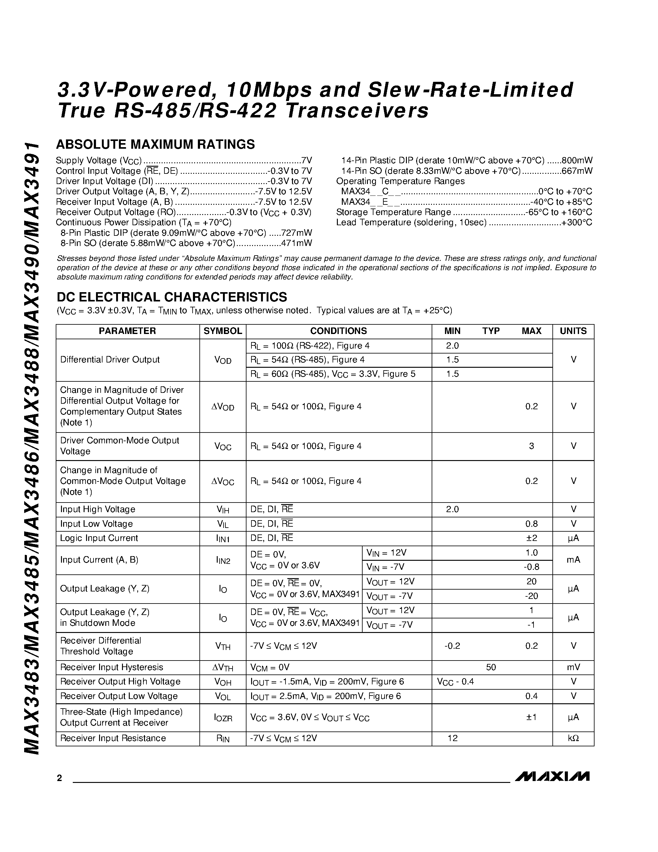

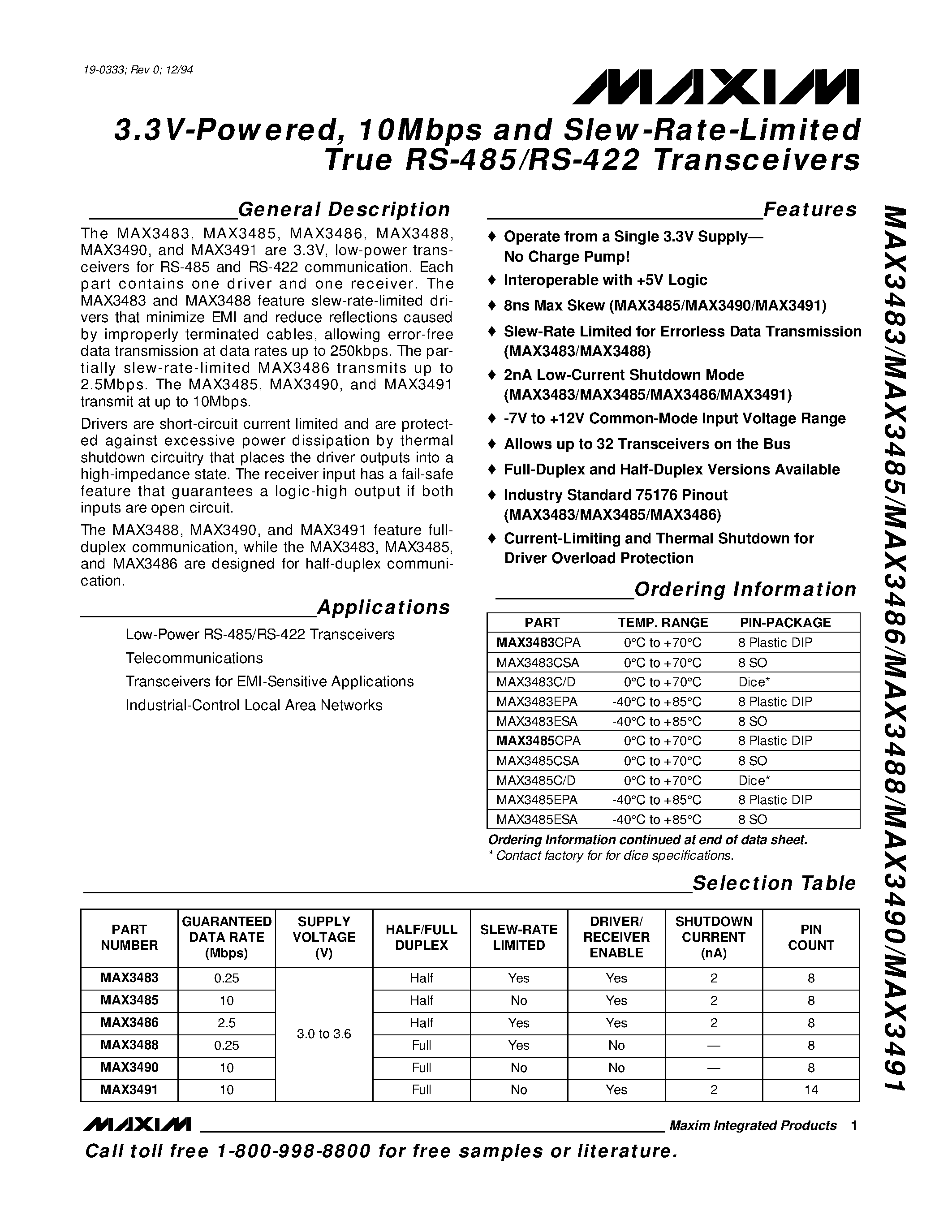

MAX3485ESA-3.3V-Powered / 10Mbps and Slew-Rate-Limited True RS-485/RS-422 Transceivers
Producer:Maxim
Description:3.3V-Powered / 10Mbps and Slew-Rate-Limited True RS-485/RS-422 Transceivers
Others with the same file: MAX3485ESA
Datasheet MAX3485ESA - 3.3V-Powered / 10Mbps and Slew-Rate-Limited True RS-485/RS-422 Transceivers page 1
Datasheet MAX3485ESA - 3.3V-Powered / 10Mbps and Slew-Rate-Limited True RS-485/RS-422 Transceivers page 2
