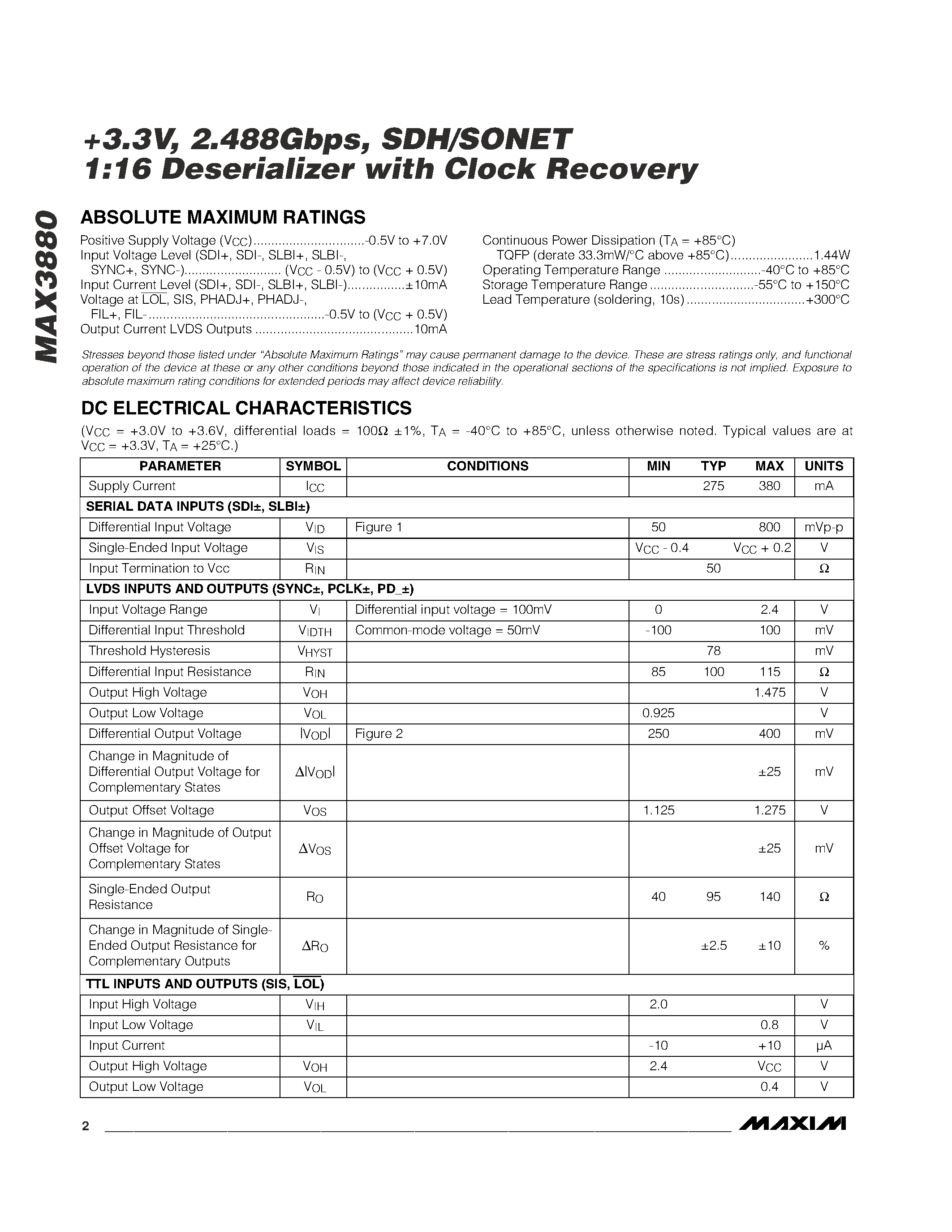

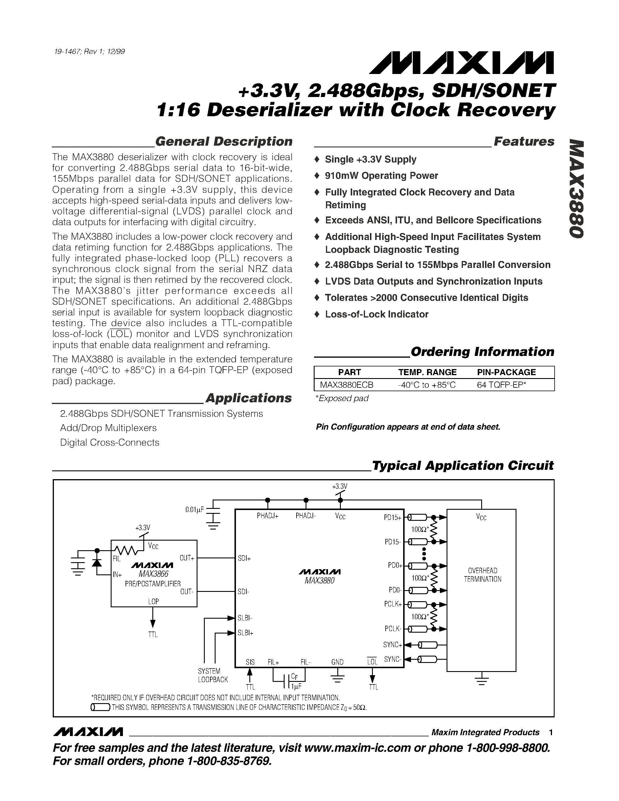

MAX3880-+3.3V / 2.488Gbps / SDH/SONET 1:16 Deserializer with Clock Recovery
Producer:Maxim
Description:+3.3V / 2.488Gbps / SDH/SONET 1:16 Deserializer with Clock Recovery
