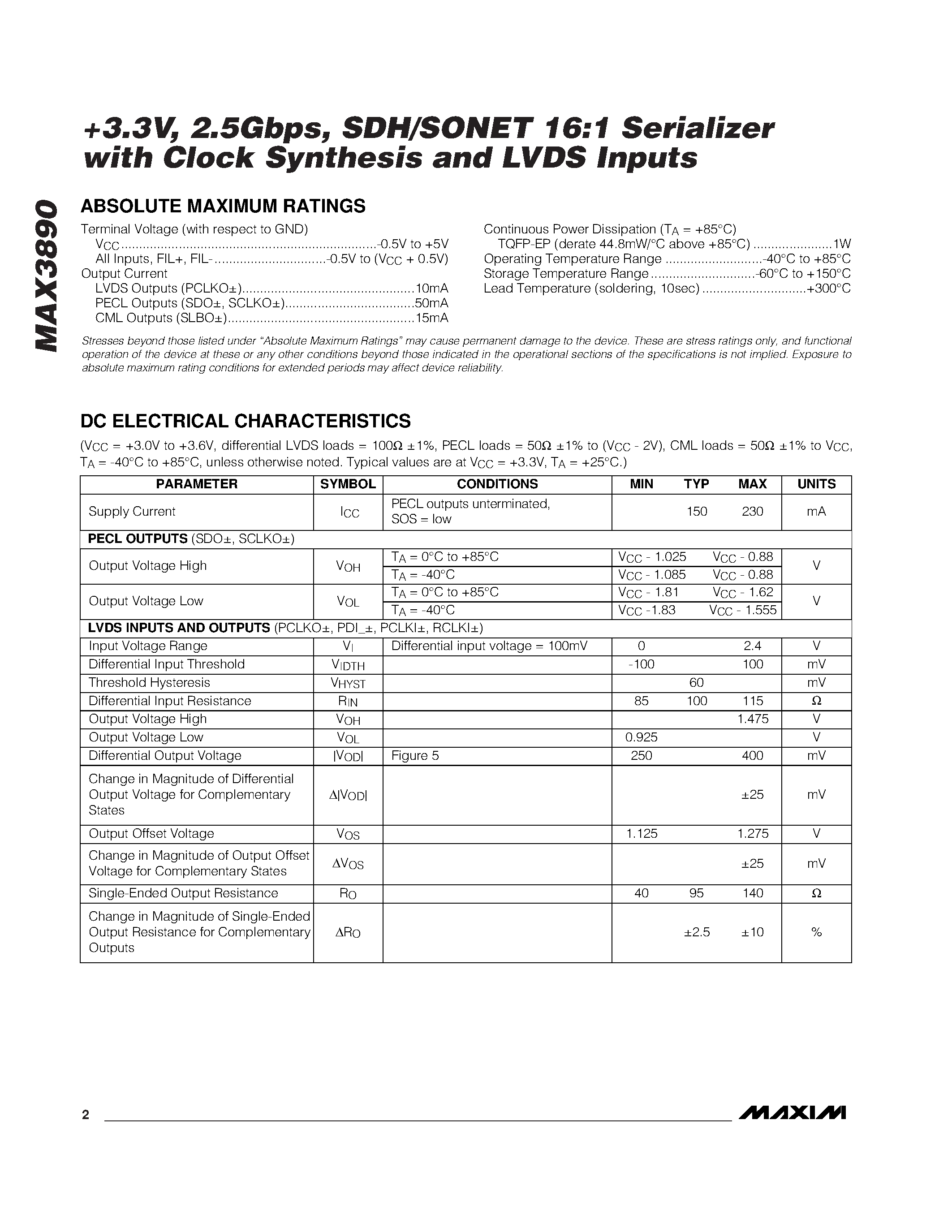

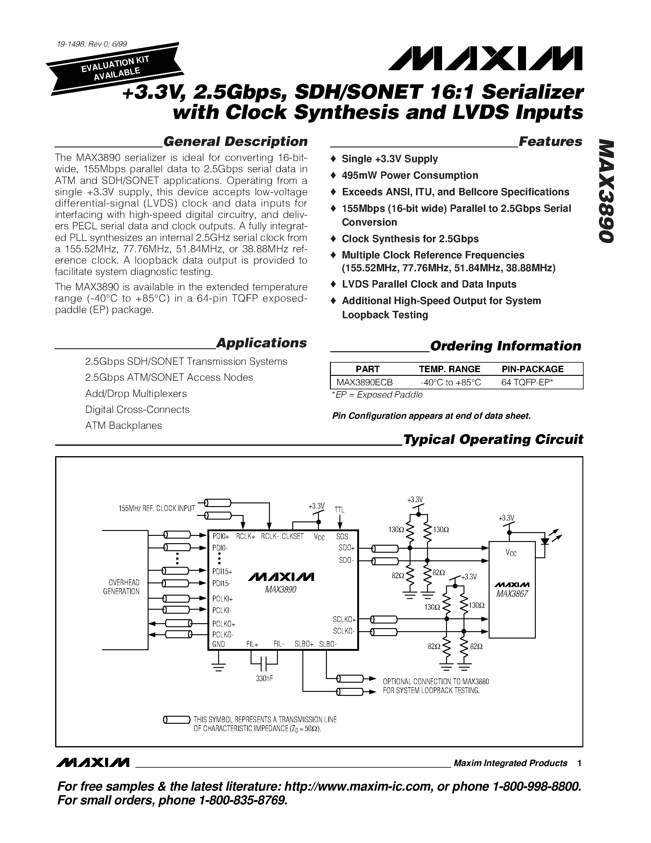

MAX3890-+3.3V / 2.5Gbps / SDH/SONET 16:1 Serializer with Clock Synthesis and LVDS Inputs
Producer:Maxim
Description:+3.3V / 2.5Gbps / SDH/SONET 16:1 Serializer with Clock Synthesis and LVDS Inputs
