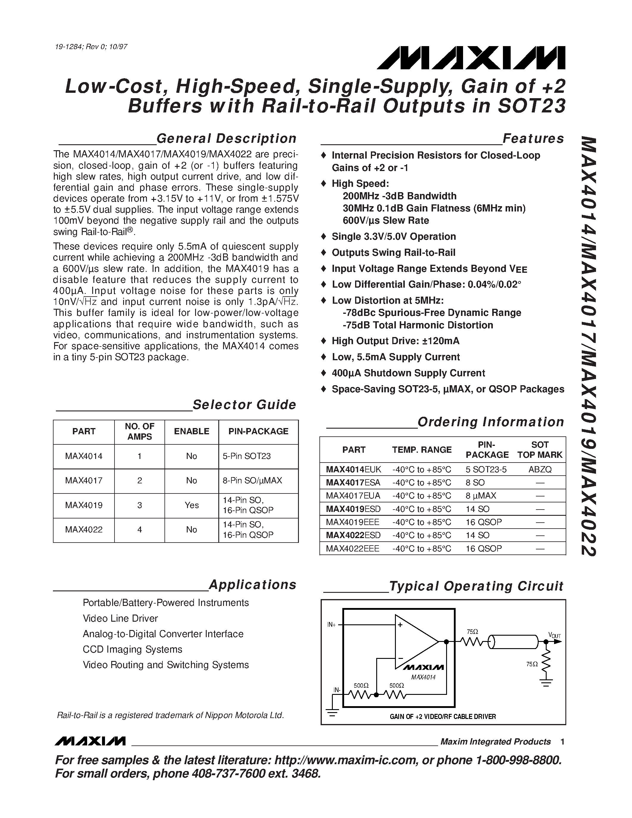

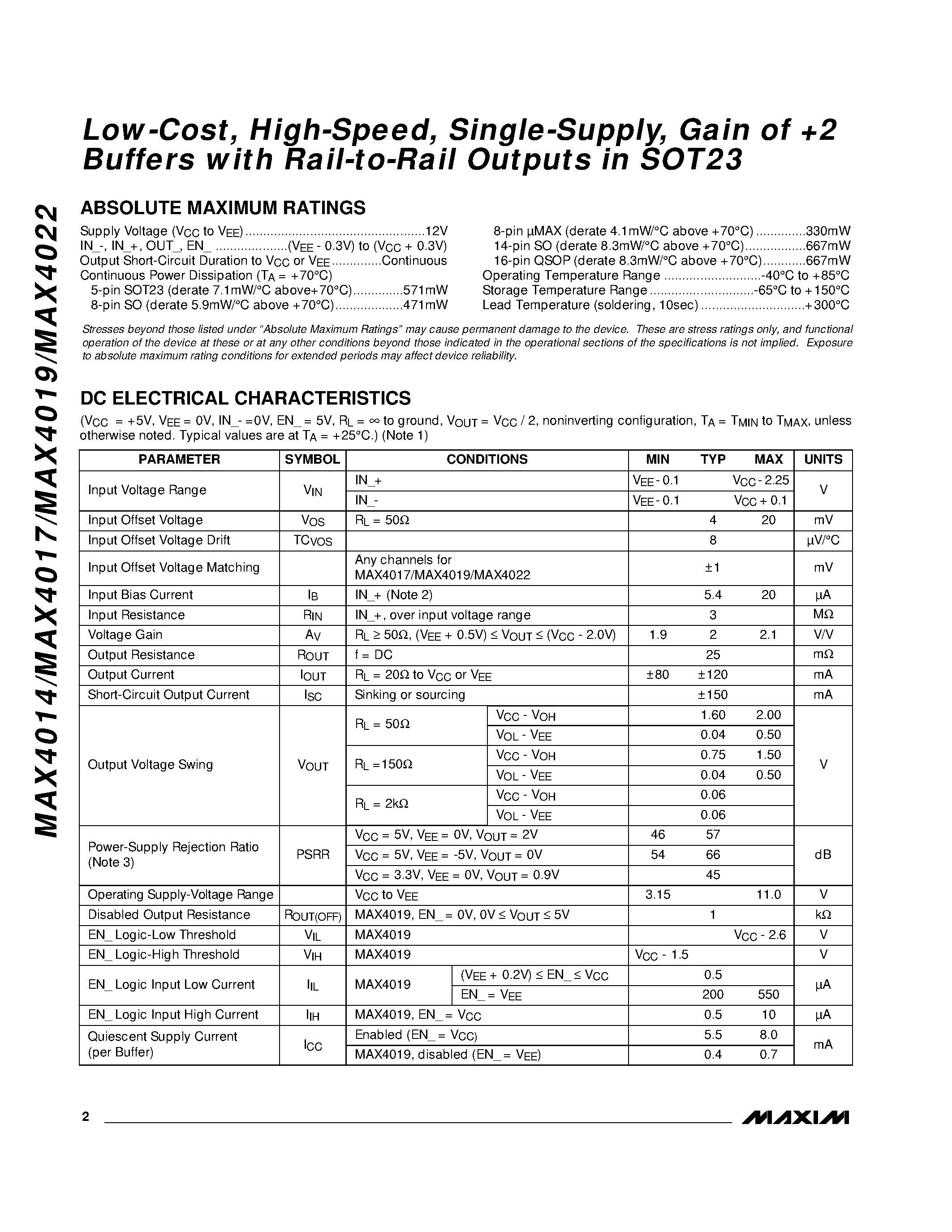

MAX4019ESD-Low-Cost / High-Speed / Single-Supply / Gain of +2 Buffers with Rail-to-Rail Outputs in SOT23
Producer:Maxim
Description:Low-Cost / High-Speed / Single-Supply / Gain of +2 Buffers with Rail-to-Rail Outputs in SOT23
