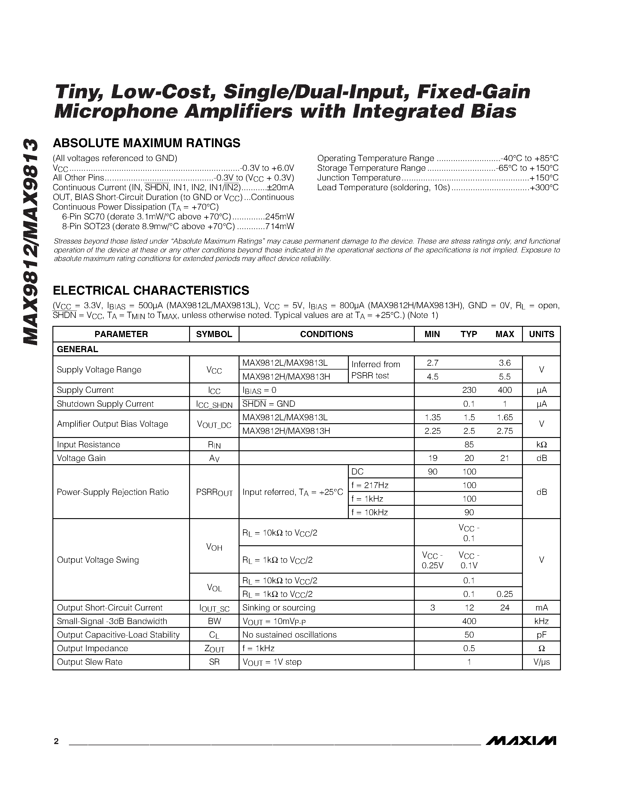

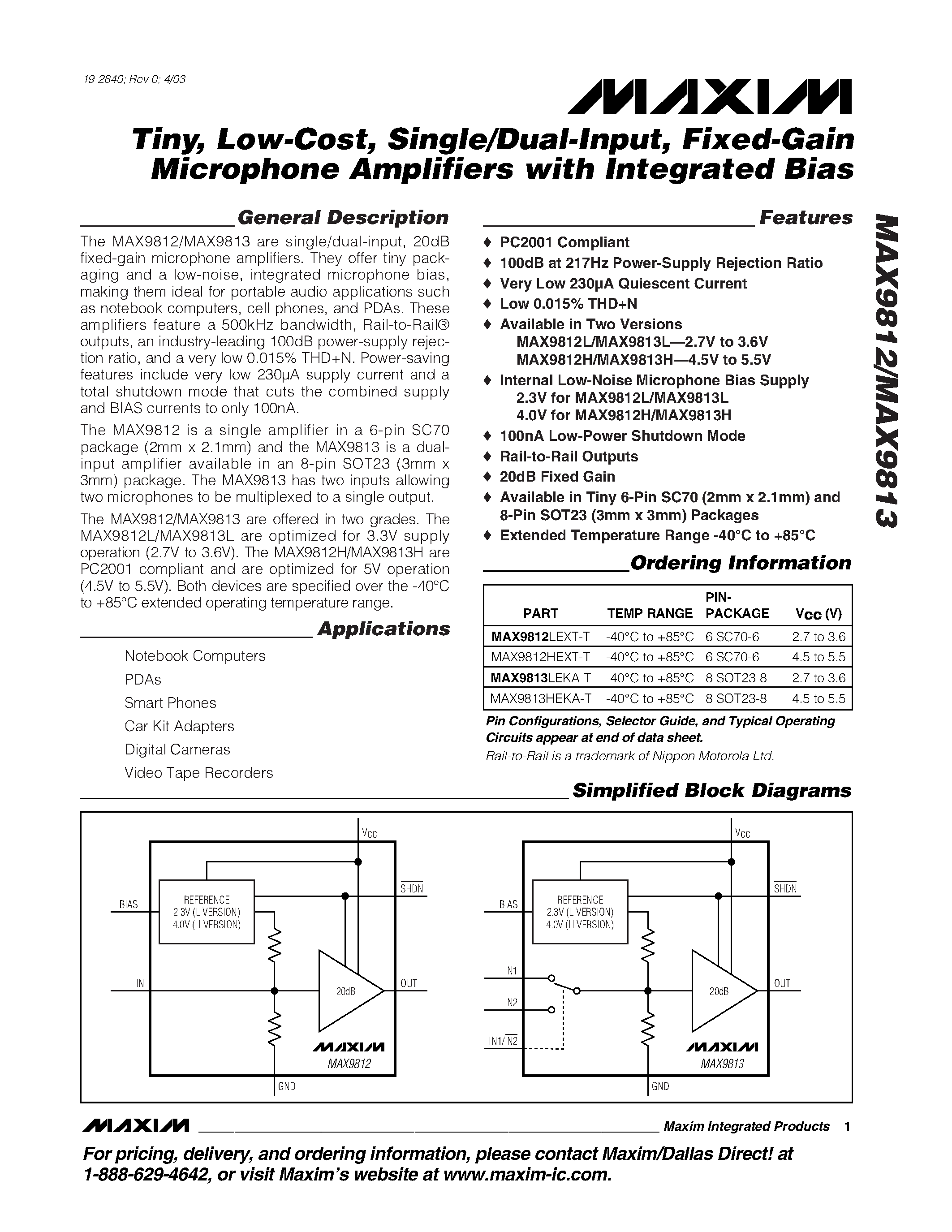

MAX9812HEXT-T-Tiny / Low-Cost / Single/Dual-Input / Fixed-Gain Microphone Amplifiers with Integrated Bias
Producer:Dallas Semiconducotr
Description:Tiny / Low-Cost / Single/Dual-Input / Fixed-Gain Microphone Amplifiers with Integrated Bias
