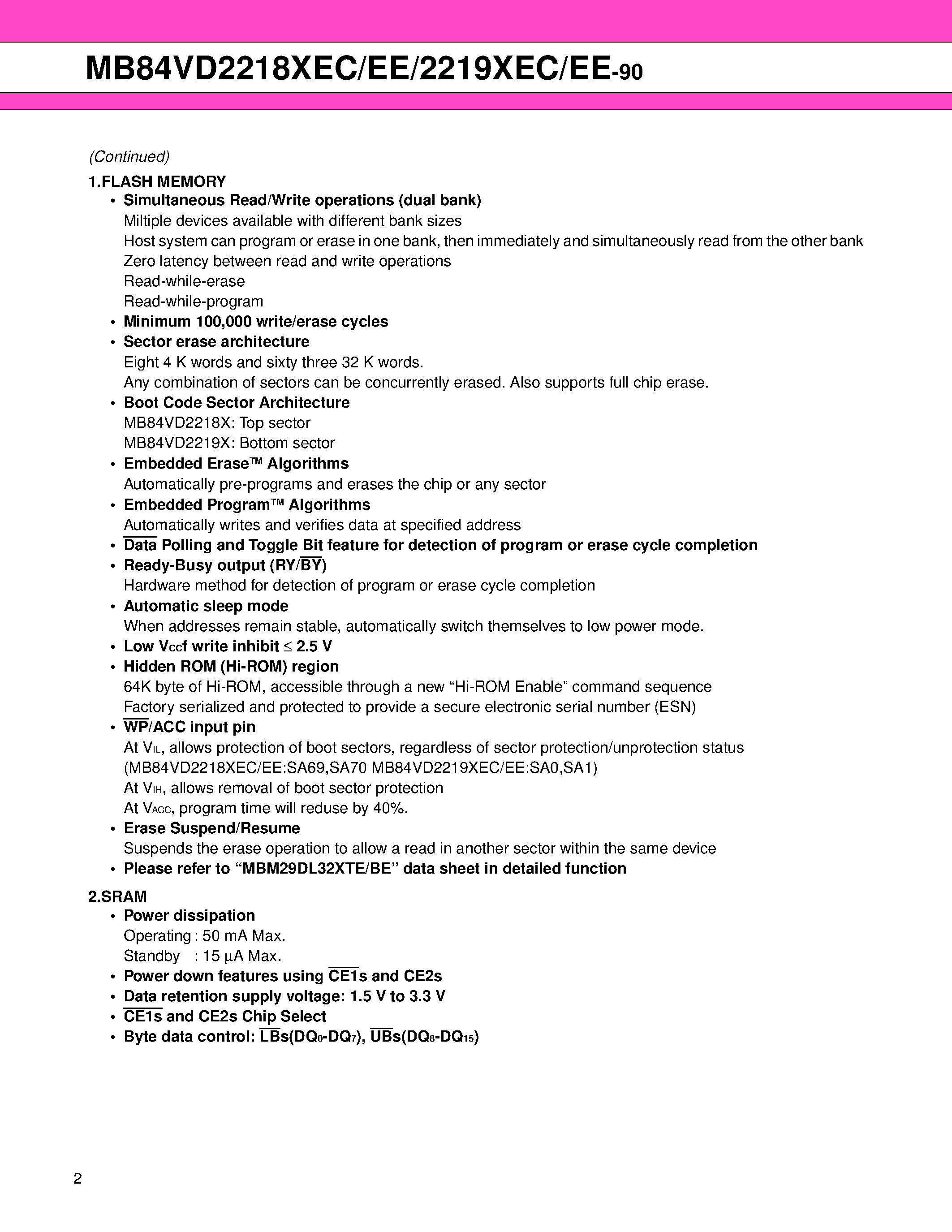

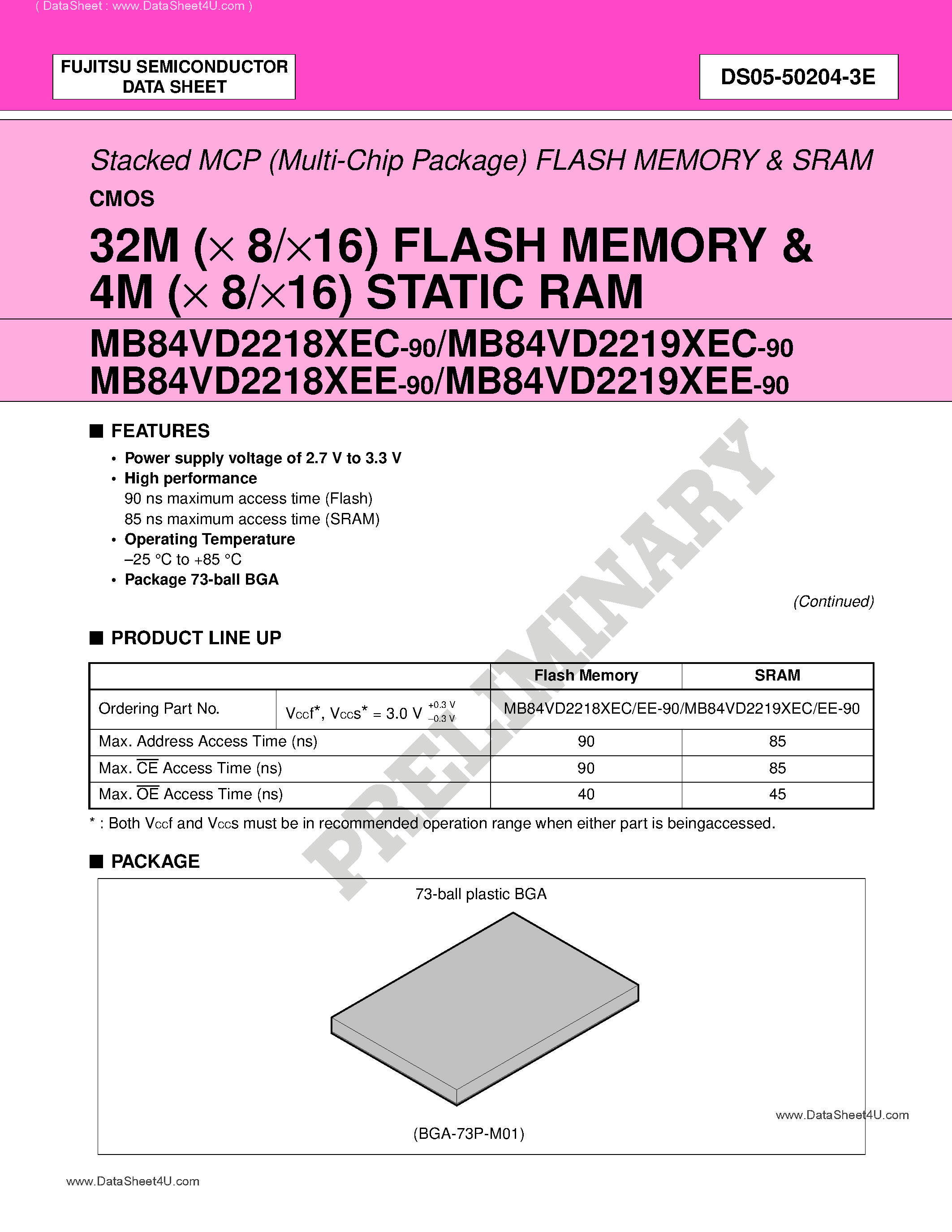

MB84VD2218xEC-(MB84VD2218xEC/EE / MB84VD2219xEC/EE) 32M (x 8/x16) FLASH MEMORY & 4M (x 8/x16) STATIC RAM
Producer:Fujitsu Media Devices
Description:(MB84VD2218xEC/EE / MB84VD2219xEC/EE) 32M (x 8/x16) FLASH MEMORY & 4M (x 8/x16) STATIC RAM
