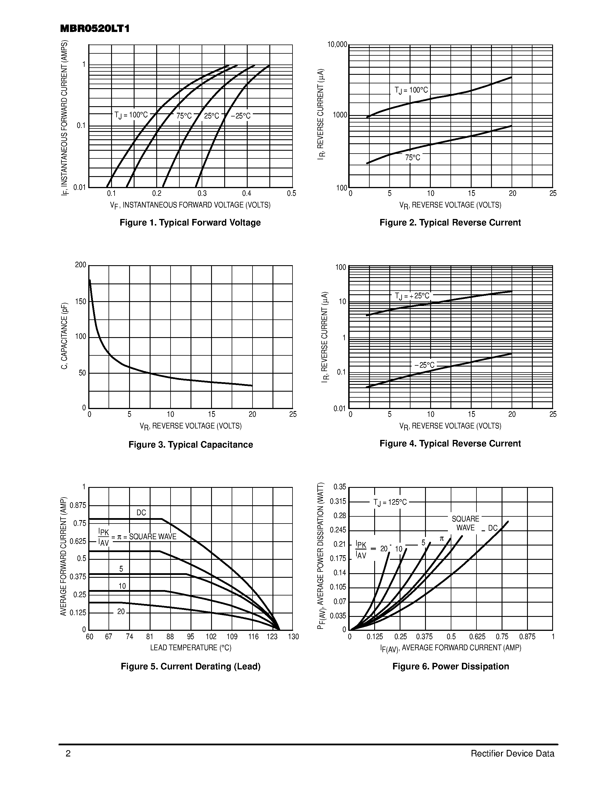

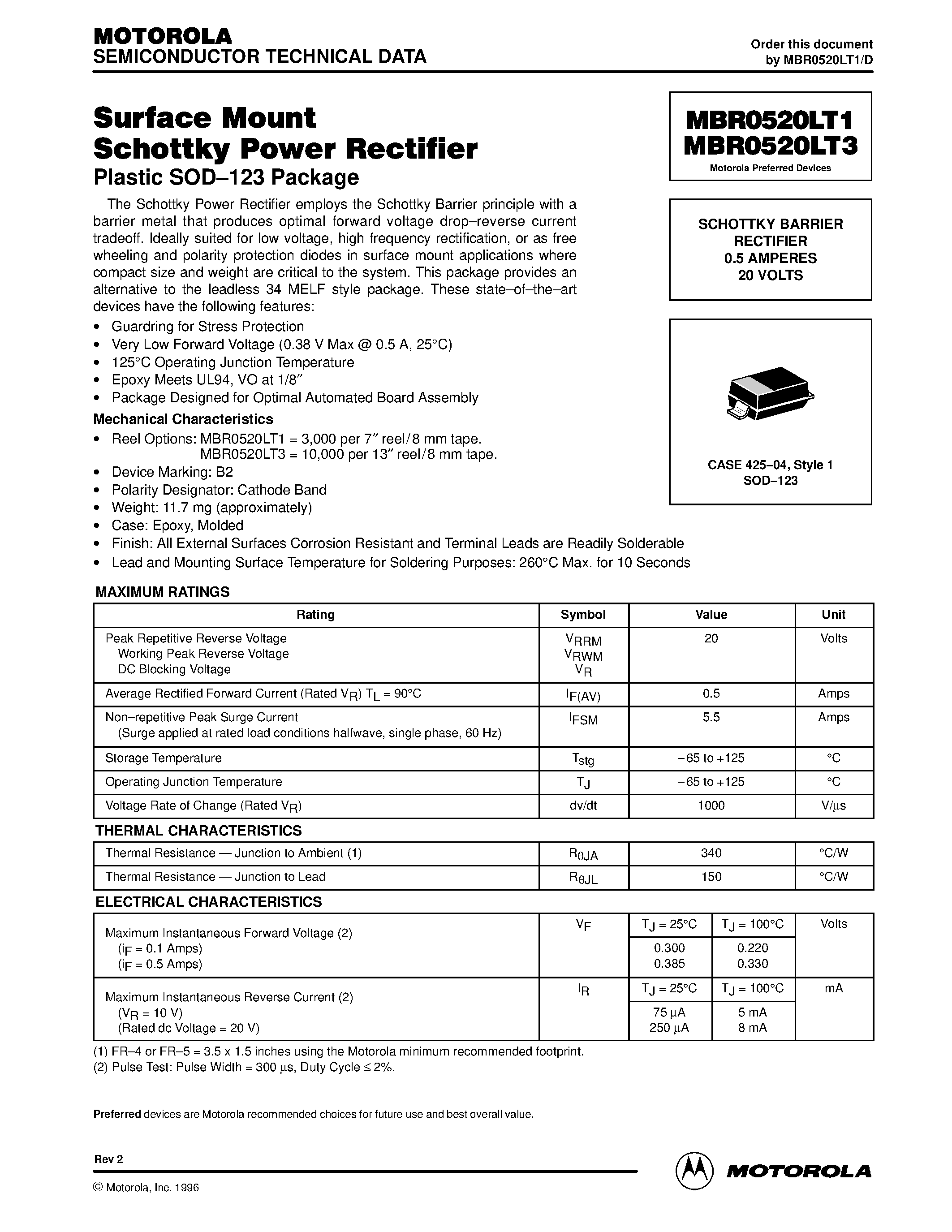

MBR0520LT1-(MBR0520LT1 / MBR0520LT3) SCHOTTKY BARRIER RECTIFIER 0.5 AMPERES 20 VOLTS
Producer:Motorola
Description:(MBR0520LT1 / MBR0520LT3) SCHOTTKY BARRIER RECTIFIER 0.5 AMPERES 20 VOLTS
Others with the same file: MBR0520LT1 | MBR0520LT3
Datasheet MBR0520LT1 - (MBR0520LT1 / MBR0520LT3) SCHOTTKY BARRIER RECTIFIER 0.5 AMPERES 20 VOLTS page 1
Datasheet MBR0520LT1 - (MBR0520LT1 / MBR0520LT3) SCHOTTKY BARRIER RECTIFIER 0.5 AMPERES 20 VOLTS page 2
