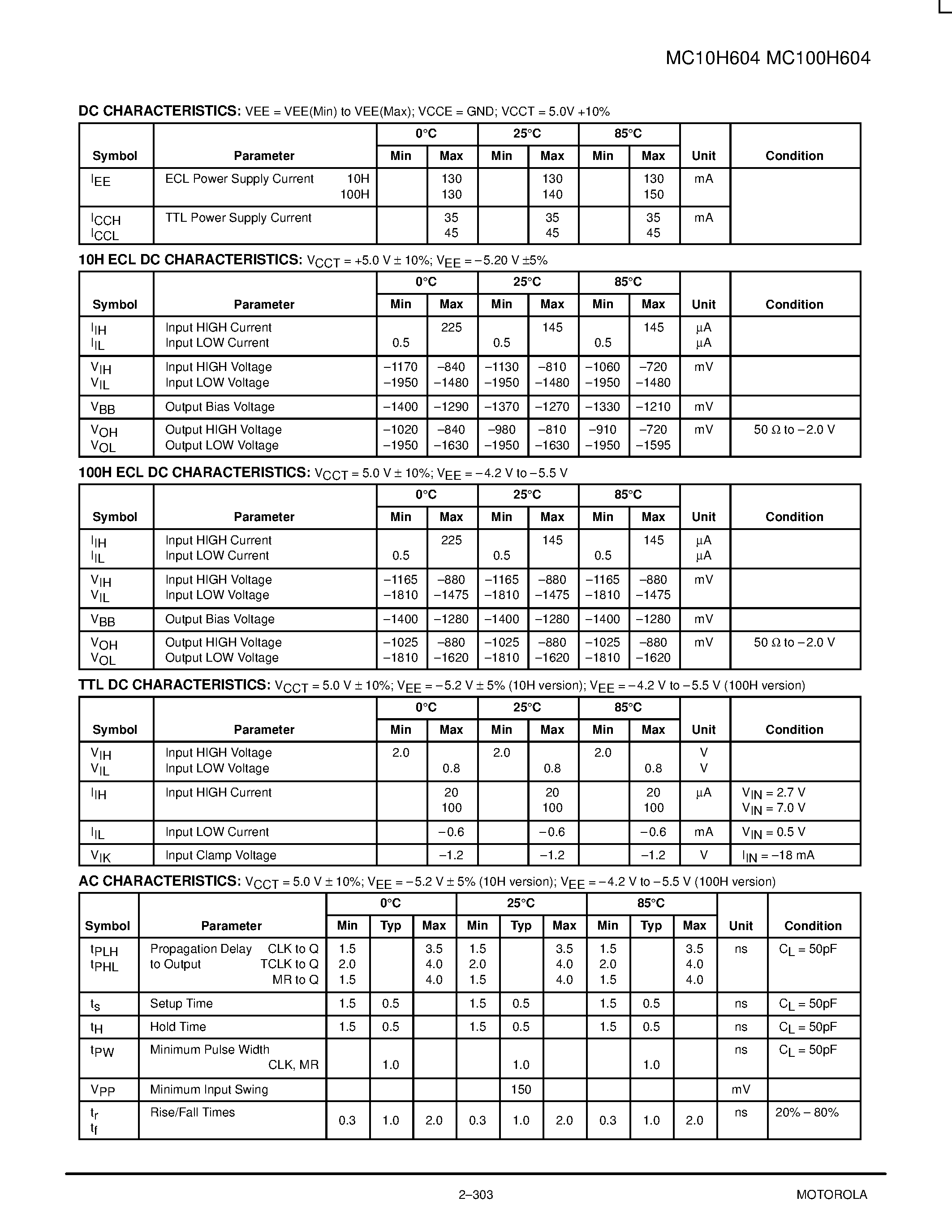

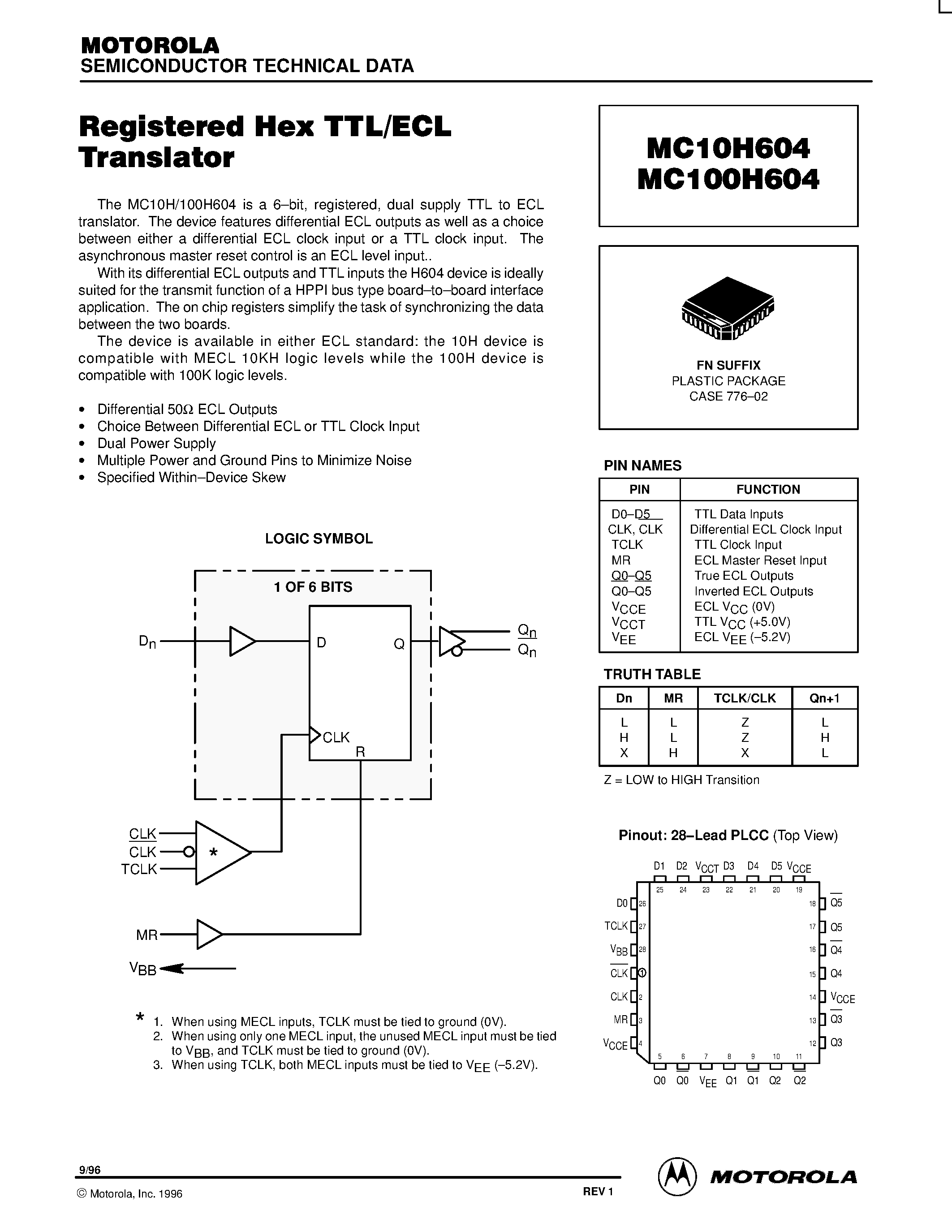

MC10H604FN-Registered Hex TTL/ECL Translator
Producer:Motorola
Description:Registered Hex TTL/ECL Translator
Others with the same file: MC10H604FN
Datasheet MC10H604FN - Registered Hex TTL/ECL Translator page 1
Datasheet MC10H604FN - Registered Hex TTL/ECL Translator page 2
