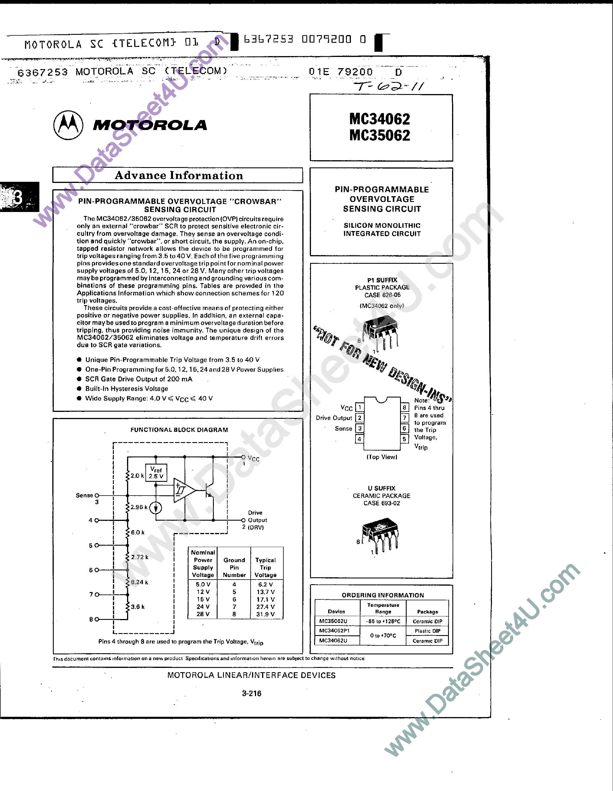

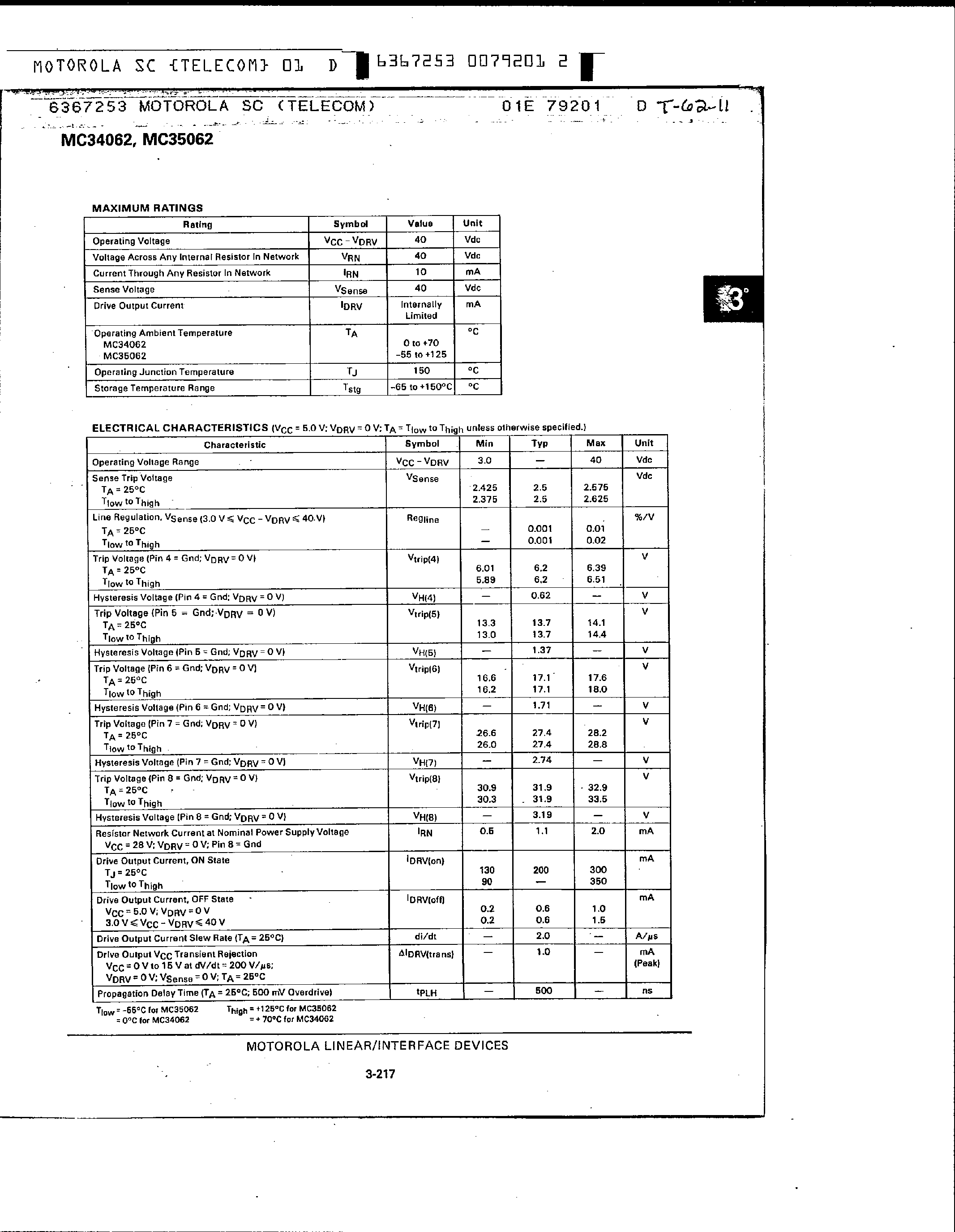

MC34062-(MC34062 / MC35062) PIN-PROGRAMMABLE OVERVOLTAGE SENSING CIRCUIT
Producer:Motorola
Description:(MC34062 / MC35062) PIN-PROGRAMMABLE OVERVOLTAGE SENSING CIRCUIT
Others with the same file: MC34062 | MC35062
Datasheet MC34062 - (MC34062 / MC35062) PIN-PROGRAMMABLE OVERVOLTAGE SENSING CIRCUIT page 1
Datasheet MC34062 - (MC34062 / MC35062) PIN-PROGRAMMABLE OVERVOLTAGE SENSING CIRCUIT page 2
