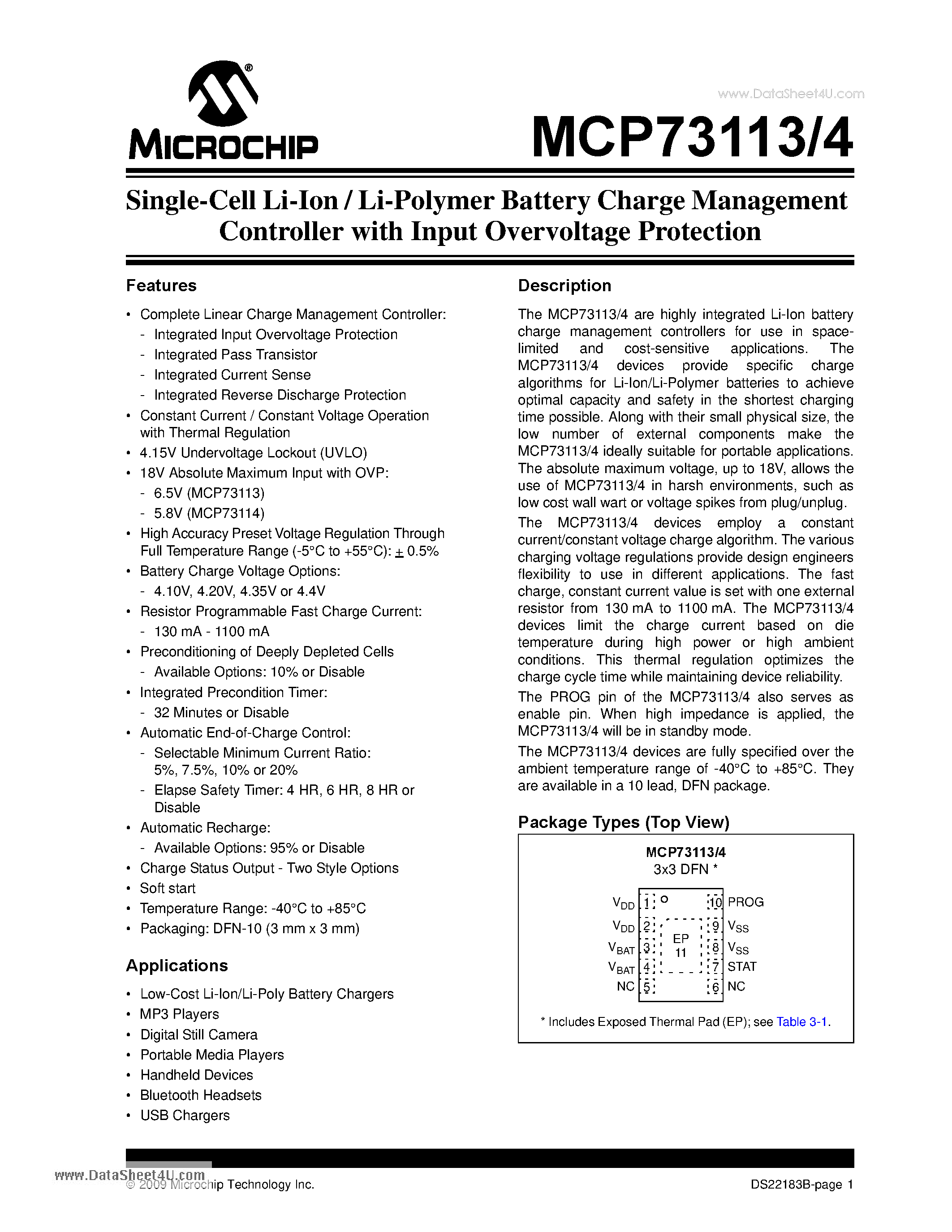

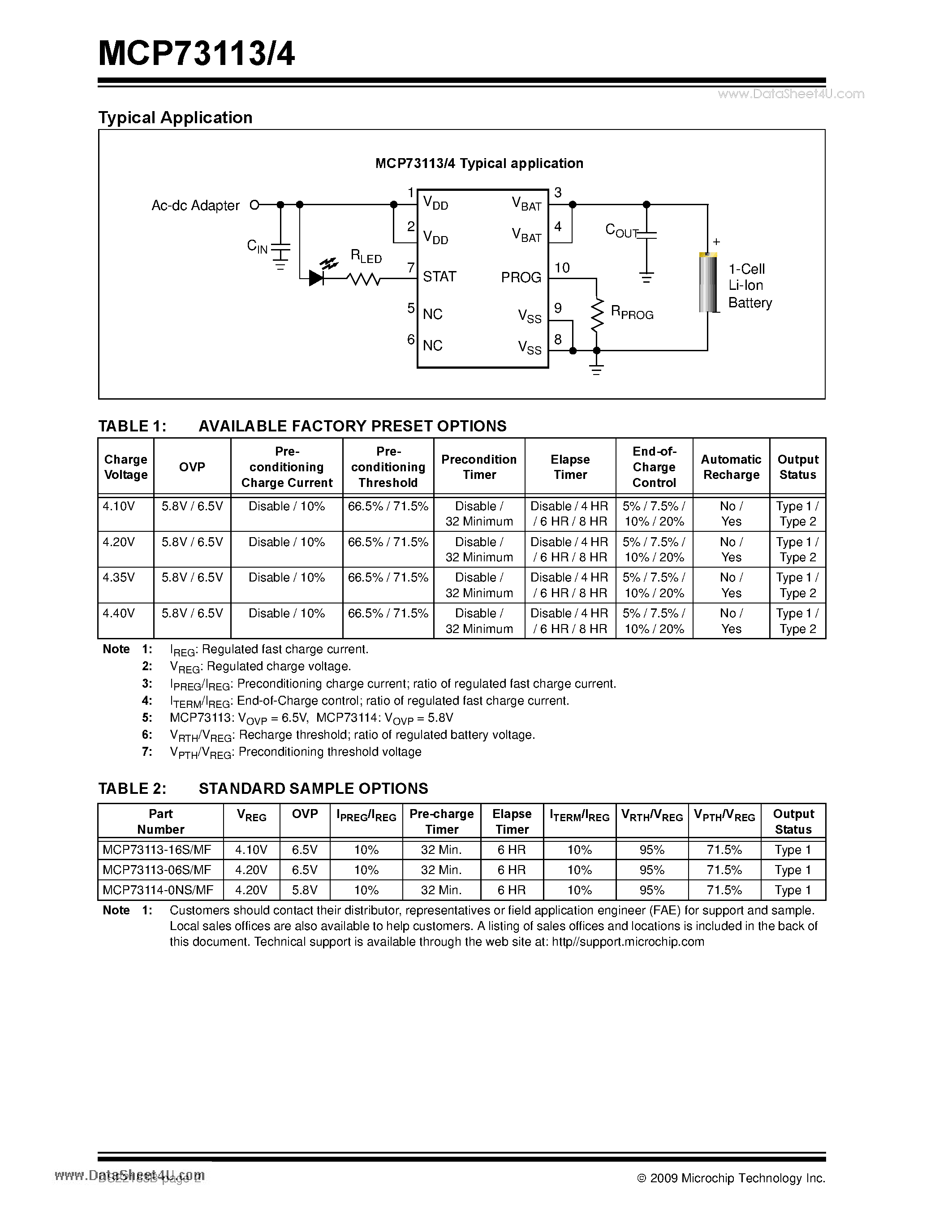

MCP73113-Single-Cell Li-Ion / Li-Polymer Battery Charge Management Controller with Input Overvoltage Protection
Producer:Microchip Technology
Description:Single-Cell Li-Ion / Li-Polymer Battery Charge Management Controller with Input Overvoltage Protection
Others with the same file: MCP73113 | MCP73114
Datasheet MCP73113 - Single-Cell Li-Ion / Li-Polymer Battery Charge Management Controller with Input Overvoltage Protection page 1
Datasheet MCP73113 - Single-Cell Li-Ion / Li-Polymer Battery Charge Management Controller with Input Overvoltage Protection page 2
