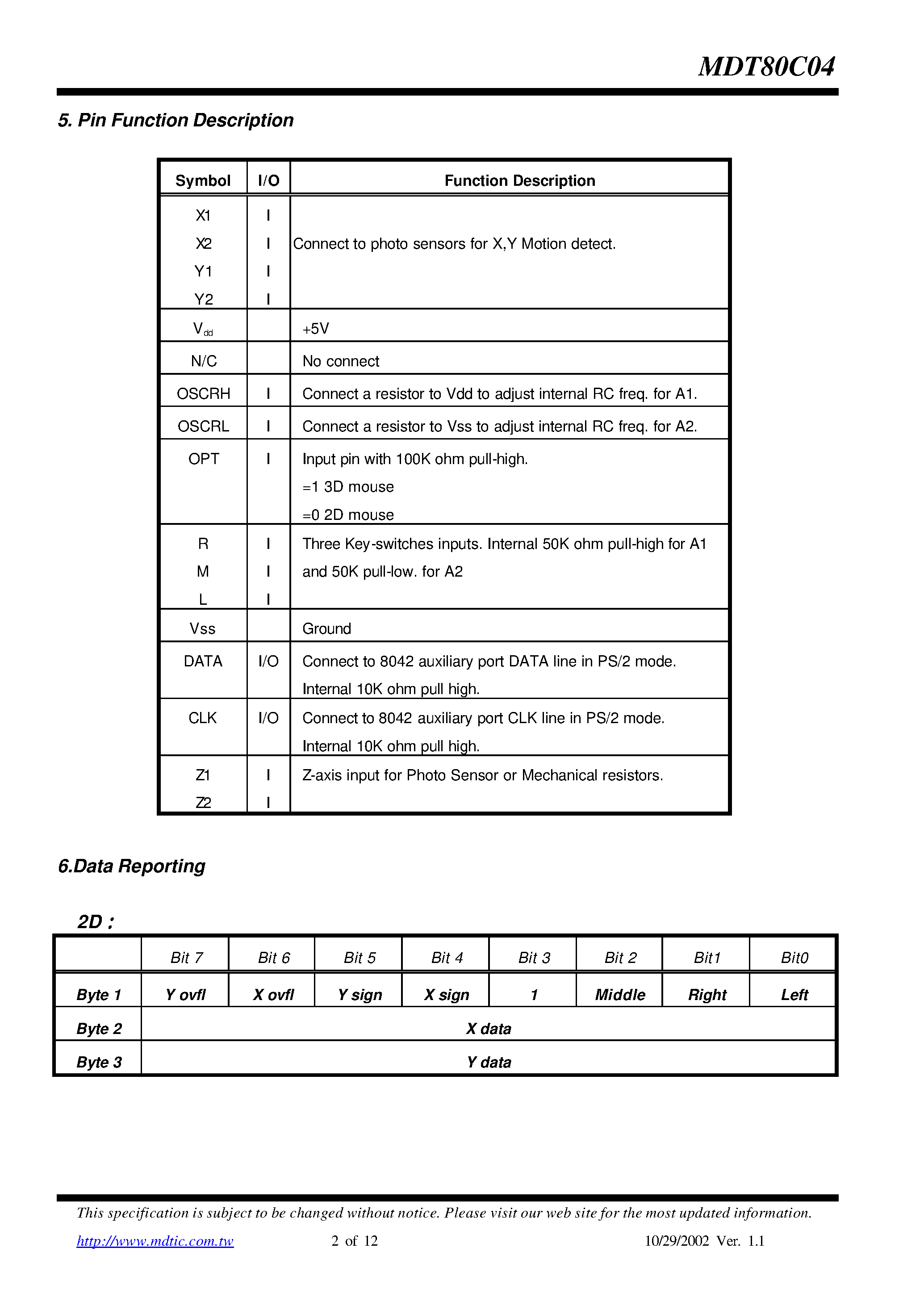

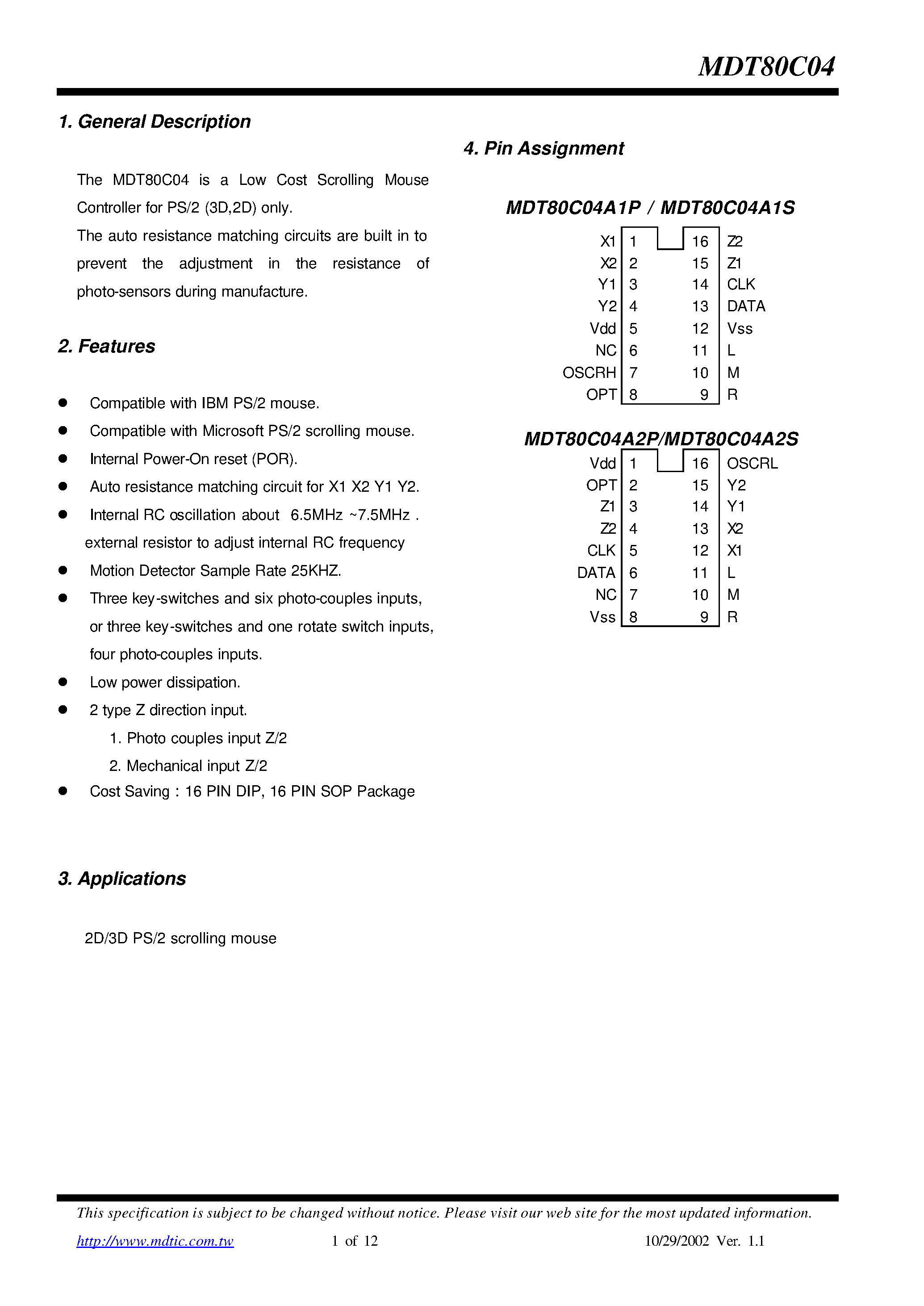

MDT80C04-Low Cost Scrolling Mouse Controller for PS/2
Producer:Micon Design
Description:Low Cost Scrolling Mouse Controller for PS/2
Others with the same file: MDT80C04
Datasheet MDT80C04 - Low Cost Scrolling Mouse Controller for PS/2 page 1
Datasheet MDT80C04 - Low Cost Scrolling Mouse Controller for PS/2 page 2
