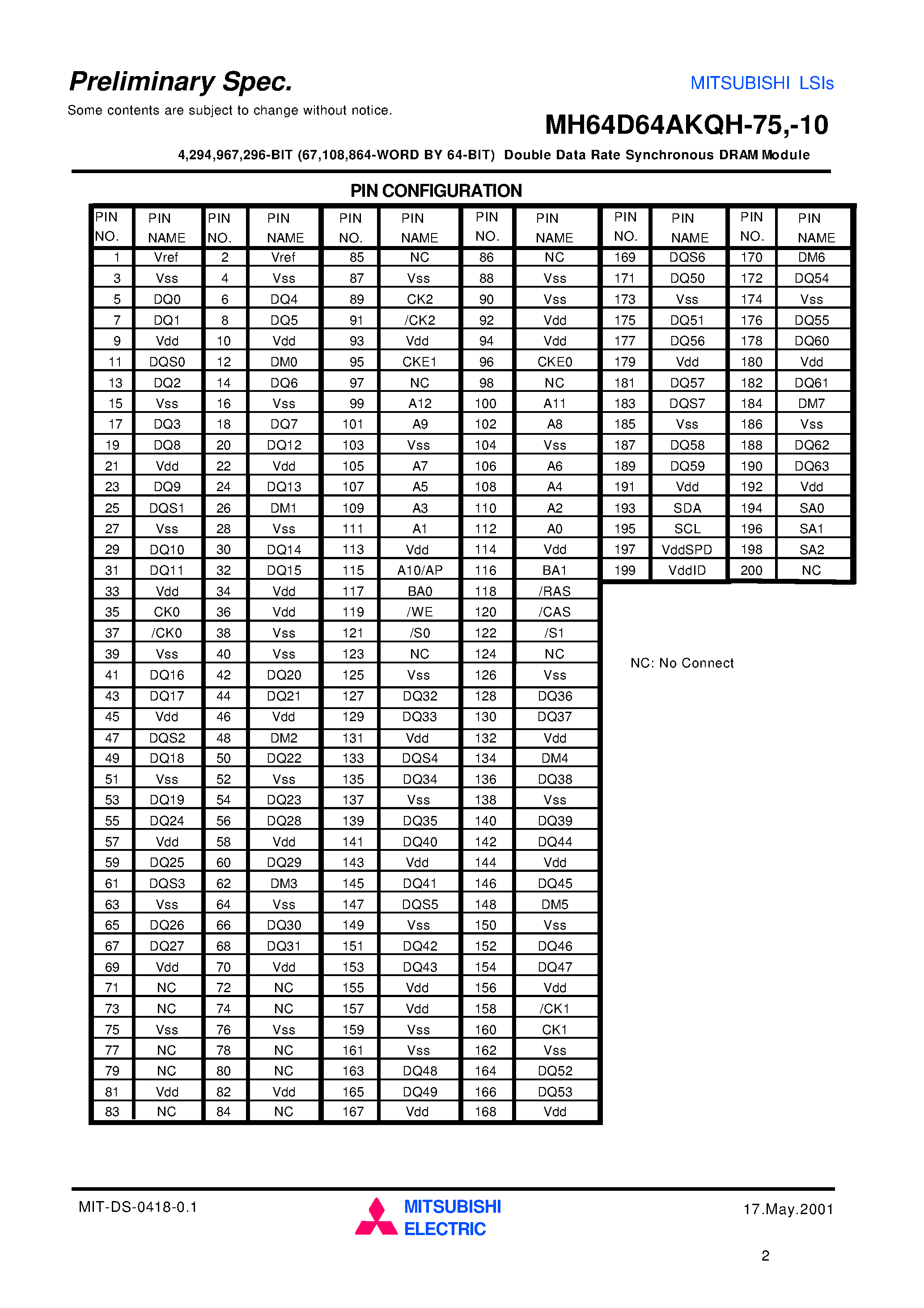

MH64D64AKQH-10-4 /294 /967 /296-BIT (67 /108 /864-WORD BY 64-BIT) Double Data Rate Synchronous DRAM Module
Producer:Mitsubishi
Description:4 /294 /967 /296-BIT (67 /108 /864-WORD BY 64-BIT) Double Data Rate Synchronous DRAM Module
Others with the same file: MH64D64AKQH-10
Datasheet MH64D64AKQH-10 - 4 /294 /967 /296-BIT (67 /108 /864-WORD BY 64-BIT) Double Data Rate Synchronous DRAM Module page 1
Datasheet MH64D64AKQH-10 - 4 /294 /967 /296-BIT (67 /108 /864-WORD BY 64-BIT) Double Data Rate Synchronous DRAM Module page 2
