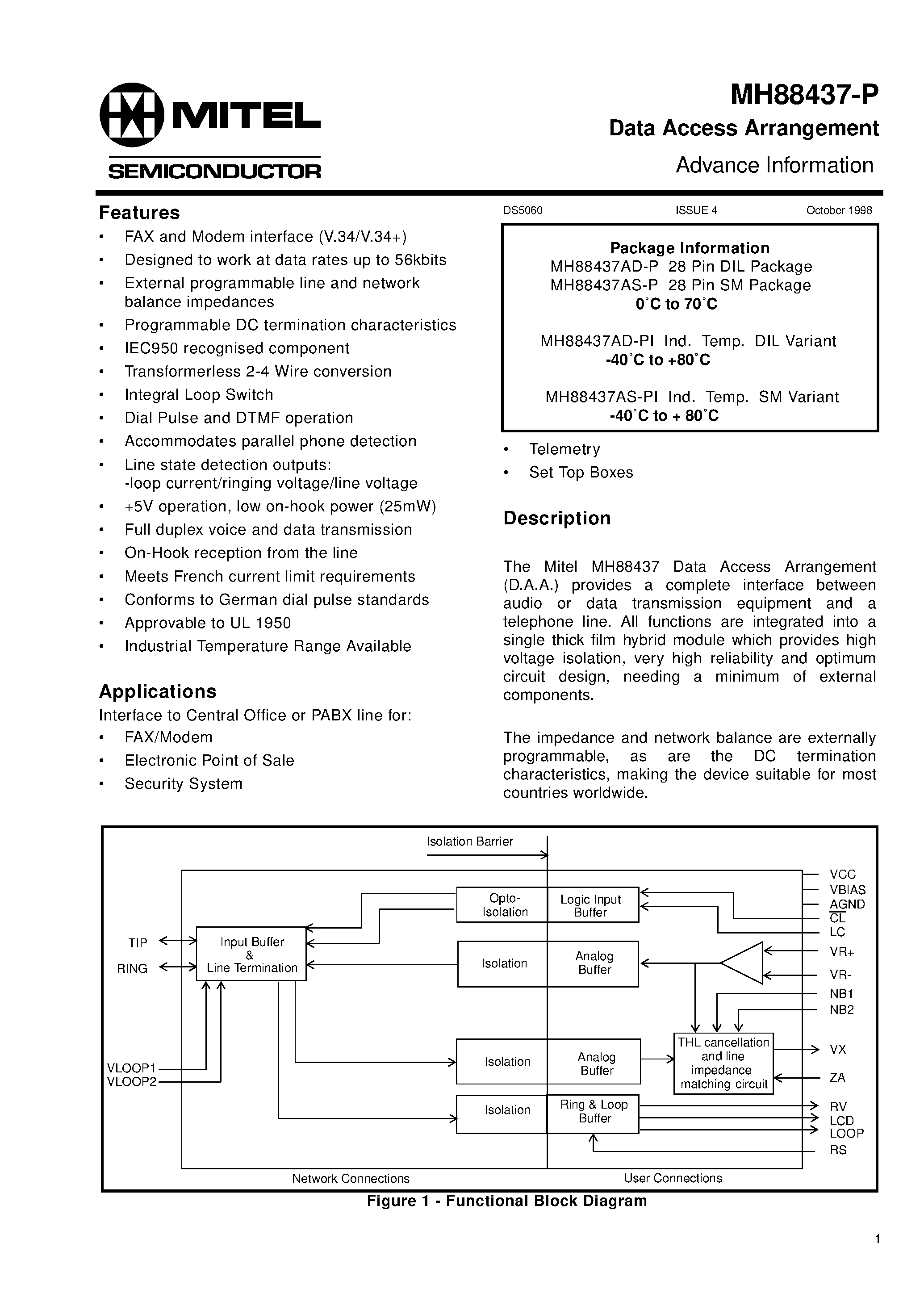

MH88437AD-PI-Data Access Arrangement Advance Information
Producer:Mitel Networks
Description:Data Access Arrangement Advance Information
Others with the same file: MH88437AD-PI
Datasheet MH88437AD-PI - Data Access Arrangement Advance Information page 1
Datasheet MH88437AD-PI - Data Access Arrangement Advance Information page 2
