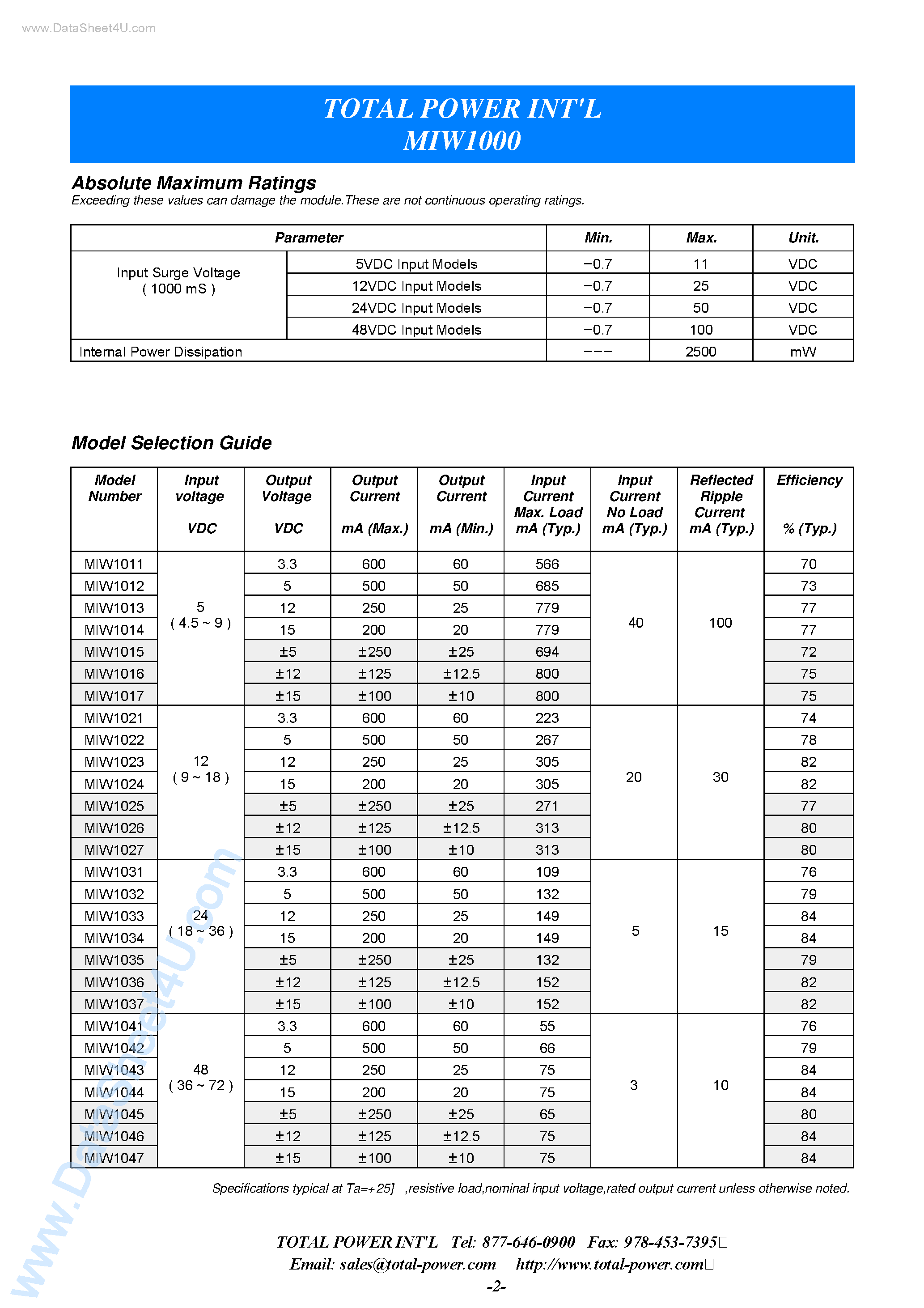

MIW1000-(MIW1000 Series) MIW1000 SERIES 2-3 WATT INPUT RANGE DC/DC CONVERTERS SINGLE AND DUAL OUTPUT
Producer:Total Power International
Description:(MIW1000 Series) MIW1000 SERIES 2-3 WATT INPUT RANGE DC/DC CONVERTERS SINGLE AND DUAL OUTPUT
