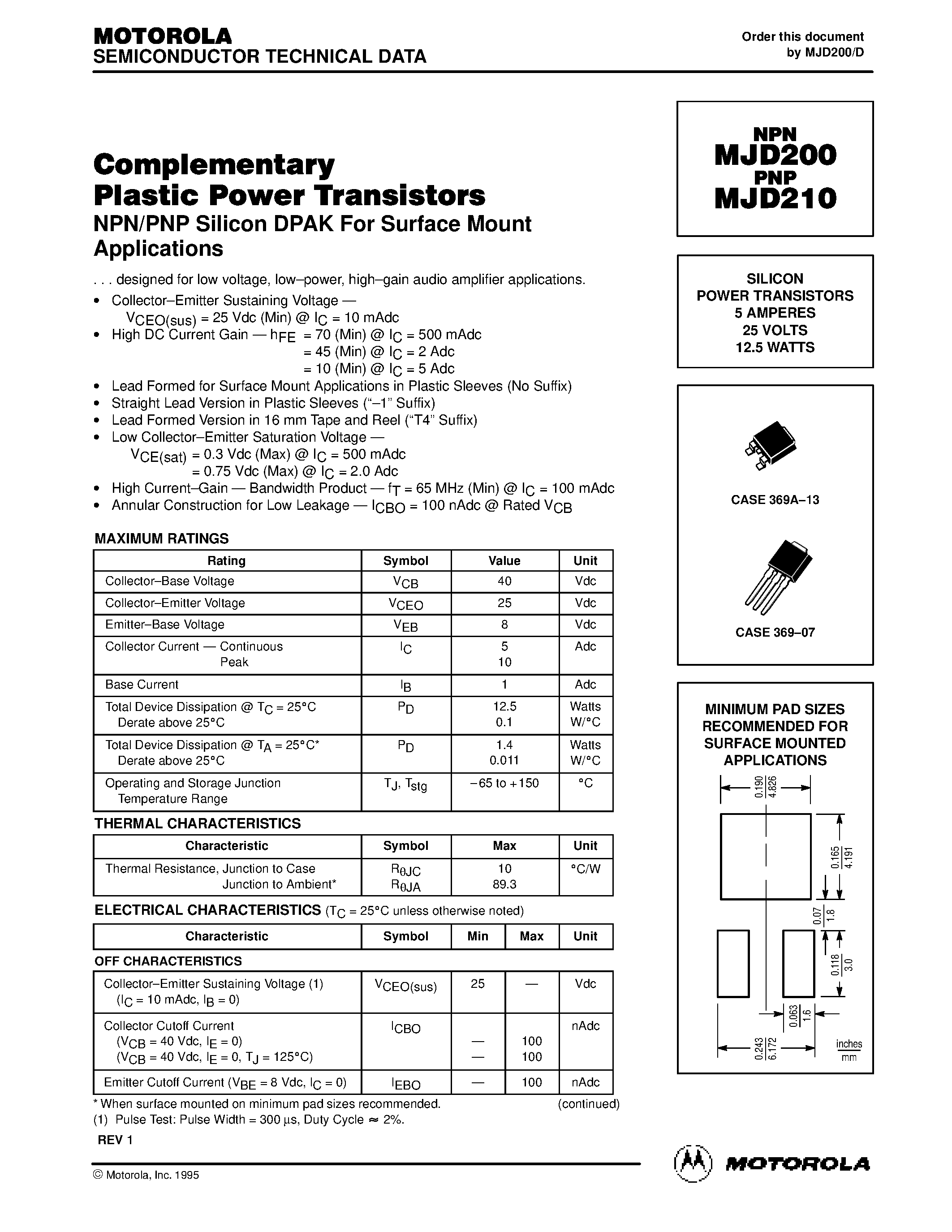

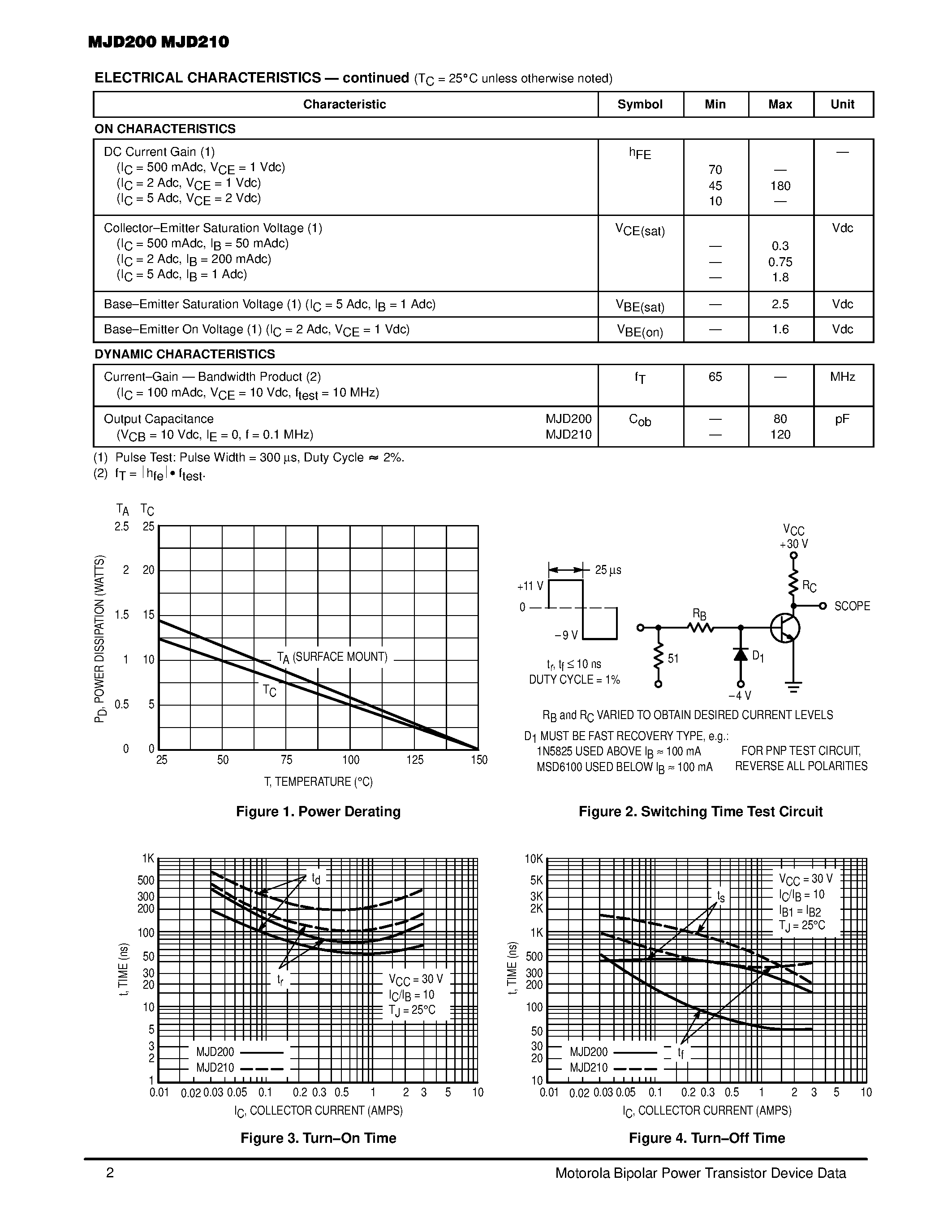

MJD200-SILICON POWER TRANSISTORS 5 AMPERES 25 VOLTS 12.5 WATTS
Producer:Motorola
Description:SILICON POWER TRANSISTORS 5 AMPERES 25 VOLTS 12.5 WATTS
Others with the same file: MJD200
Datasheet MJD200 - SILICON POWER TRANSISTORS 5 AMPERES 25 VOLTS 12.5 WATTS page 1
Datasheet MJD200 - SILICON POWER TRANSISTORS 5 AMPERES 25 VOLTS 12.5 WATTS page 2
