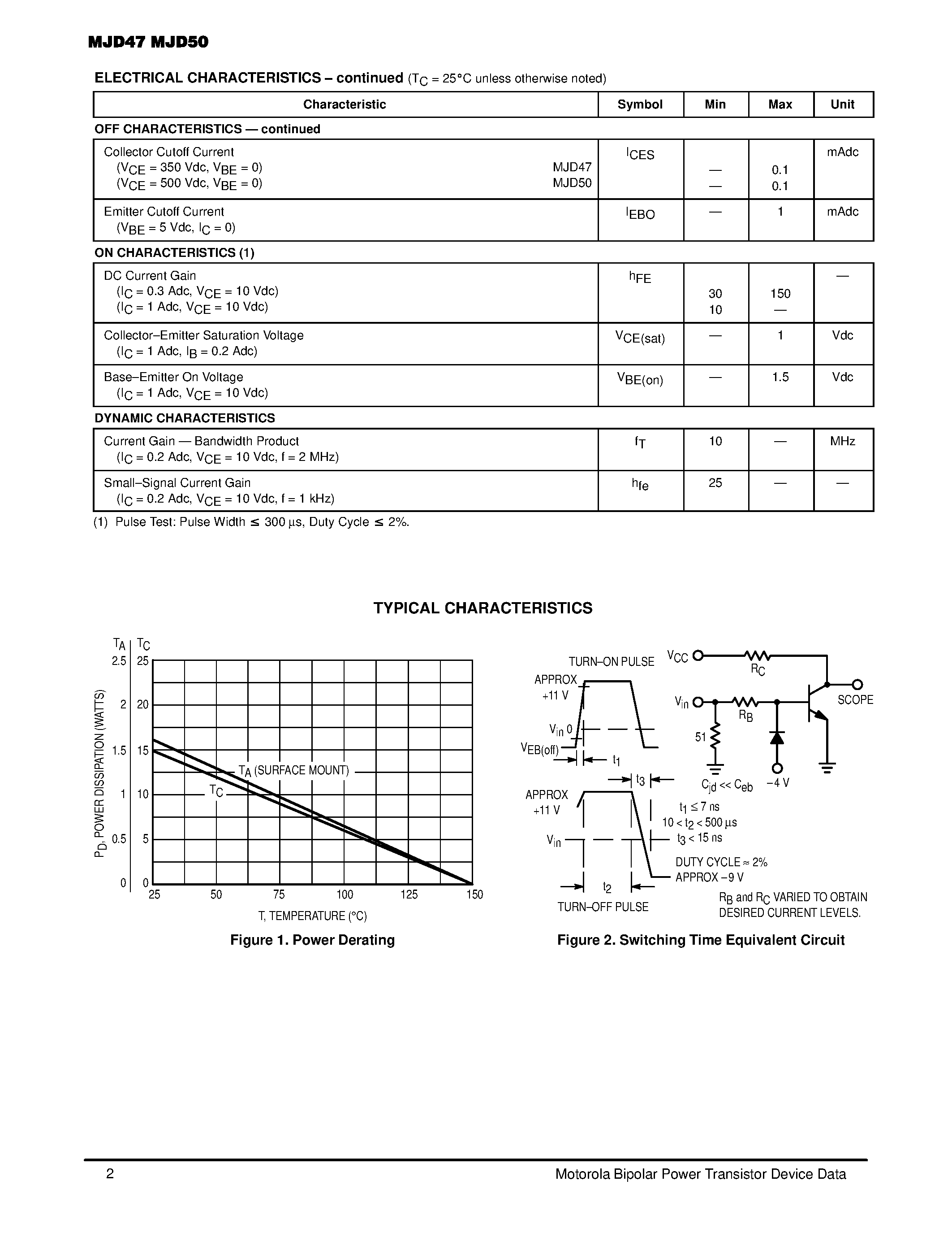

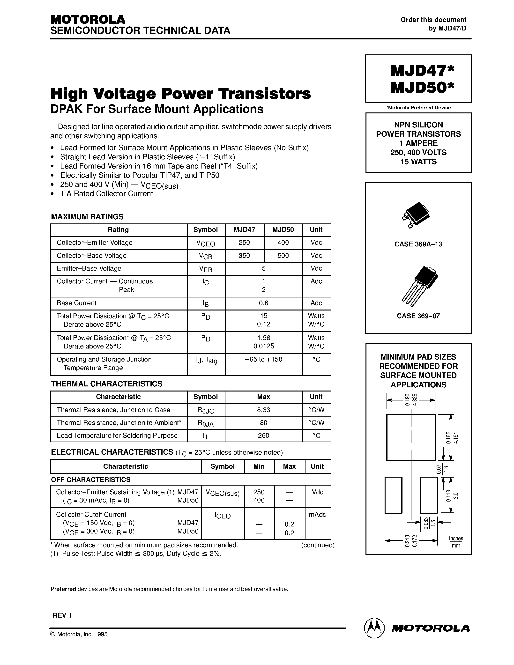

MJD47T4-NPN SILICON POWER TRANSISTORS 1 AMPERE 250 / 400 VOLTS 15 WATTS
Producer:Motorola
Description:NPN SILICON POWER TRANSISTORS 1 AMPERE 250 / 400 VOLTS 15 WATTS
Others with the same file: MJD47T4
Datasheet MJD47T4 - NPN SILICON POWER TRANSISTORS 1 AMPERE 250 / 400 VOLTS 15 WATTS page 1
Datasheet MJD47T4 - NPN SILICON POWER TRANSISTORS 1 AMPERE 250 / 400 VOLTS 15 WATTS page 2
