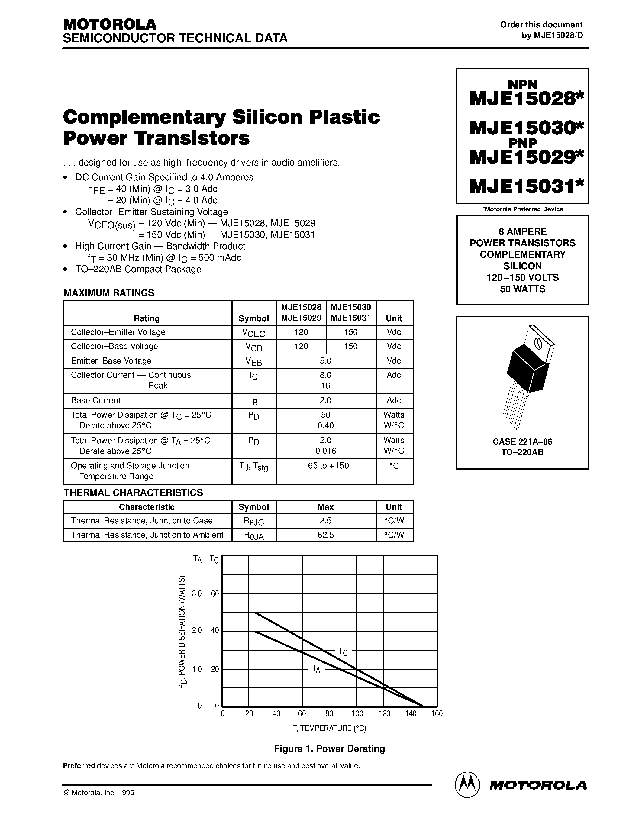

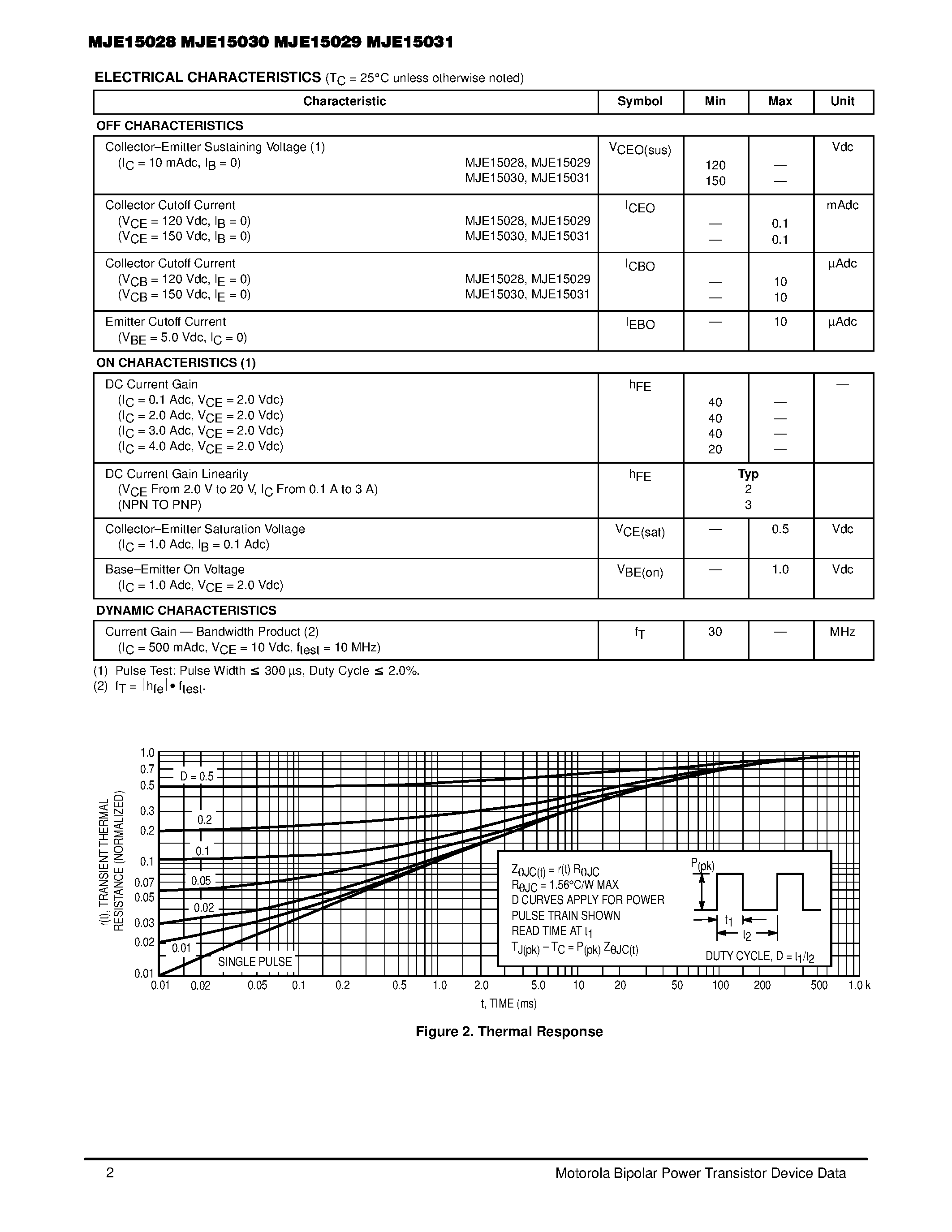

MJE15028-8 AMPERE POWER TRANSISTORS COMPLEMENTARY SILICON 120-150 VOLTS 50 WATTS
Producer:Motorola
Description:8 AMPERE POWER TRANSISTORS COMPLEMENTARY SILICON 120-150 VOLTS 50 WATTS
