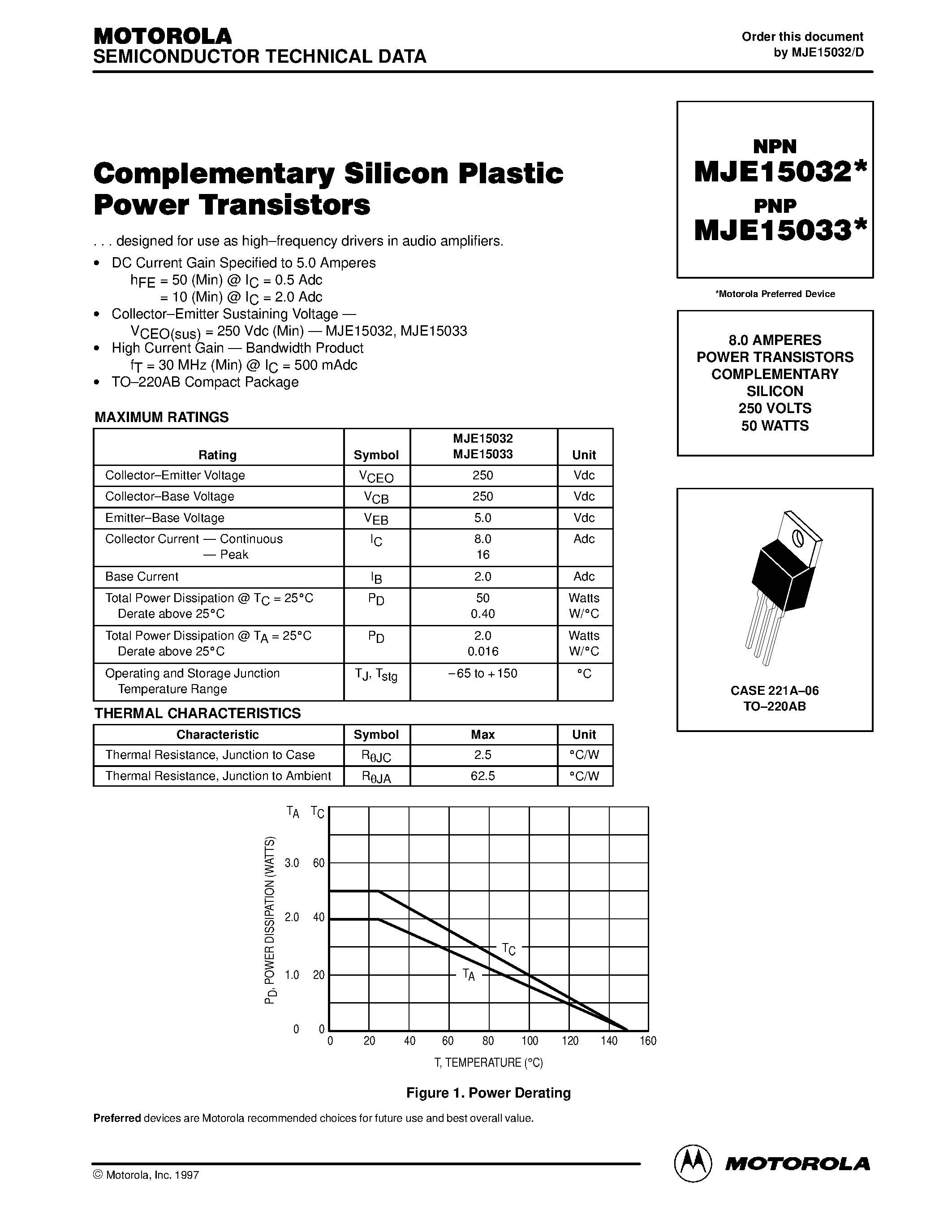

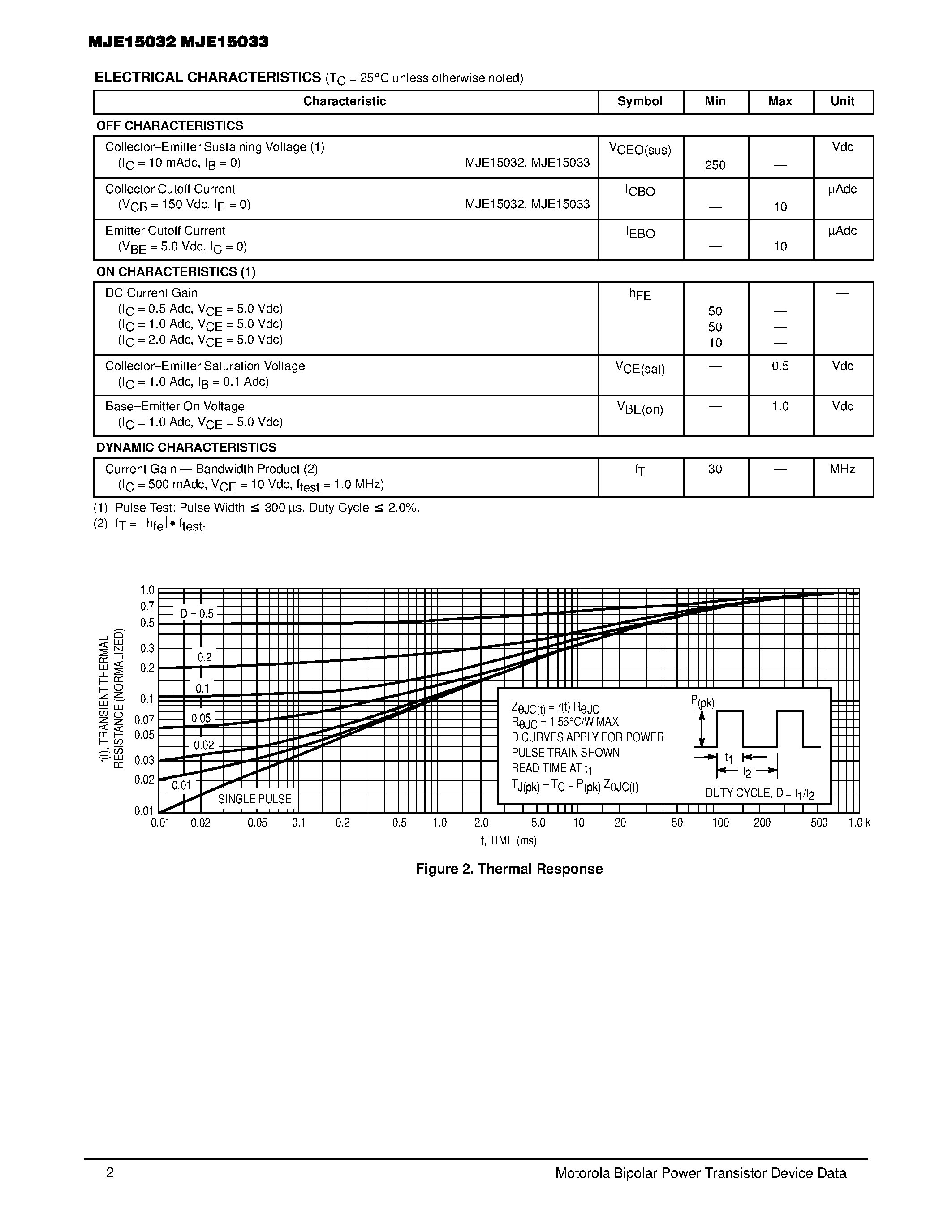

MJE15032-8.0 AMPERES POWER TRANSISTORS COMPLEMENTARY SILICON 250 VOLTS 50 WATTS
Producer:Motorola
Description:8.0 AMPERES POWER TRANSISTORS COMPLEMENTARY SILICON 250 VOLTS 50 WATTS
