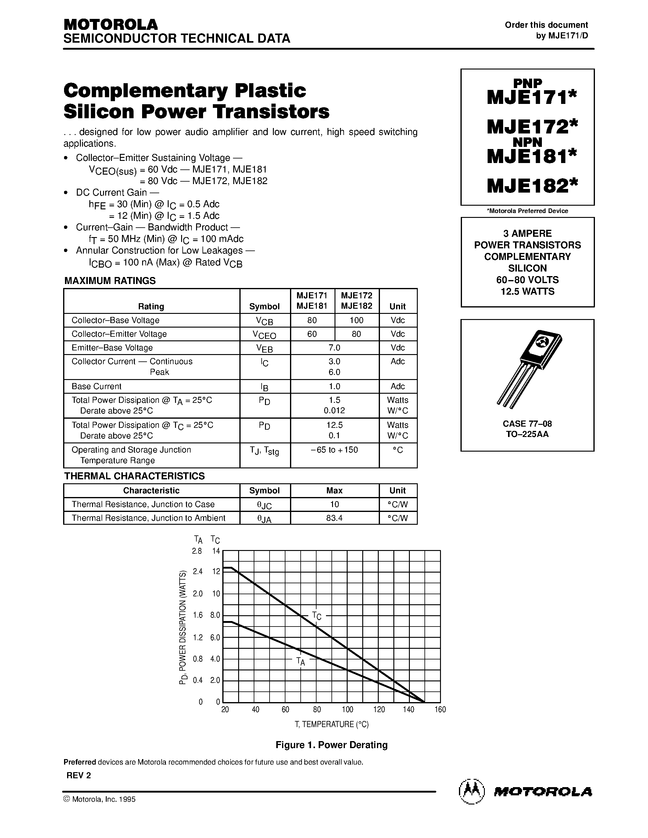

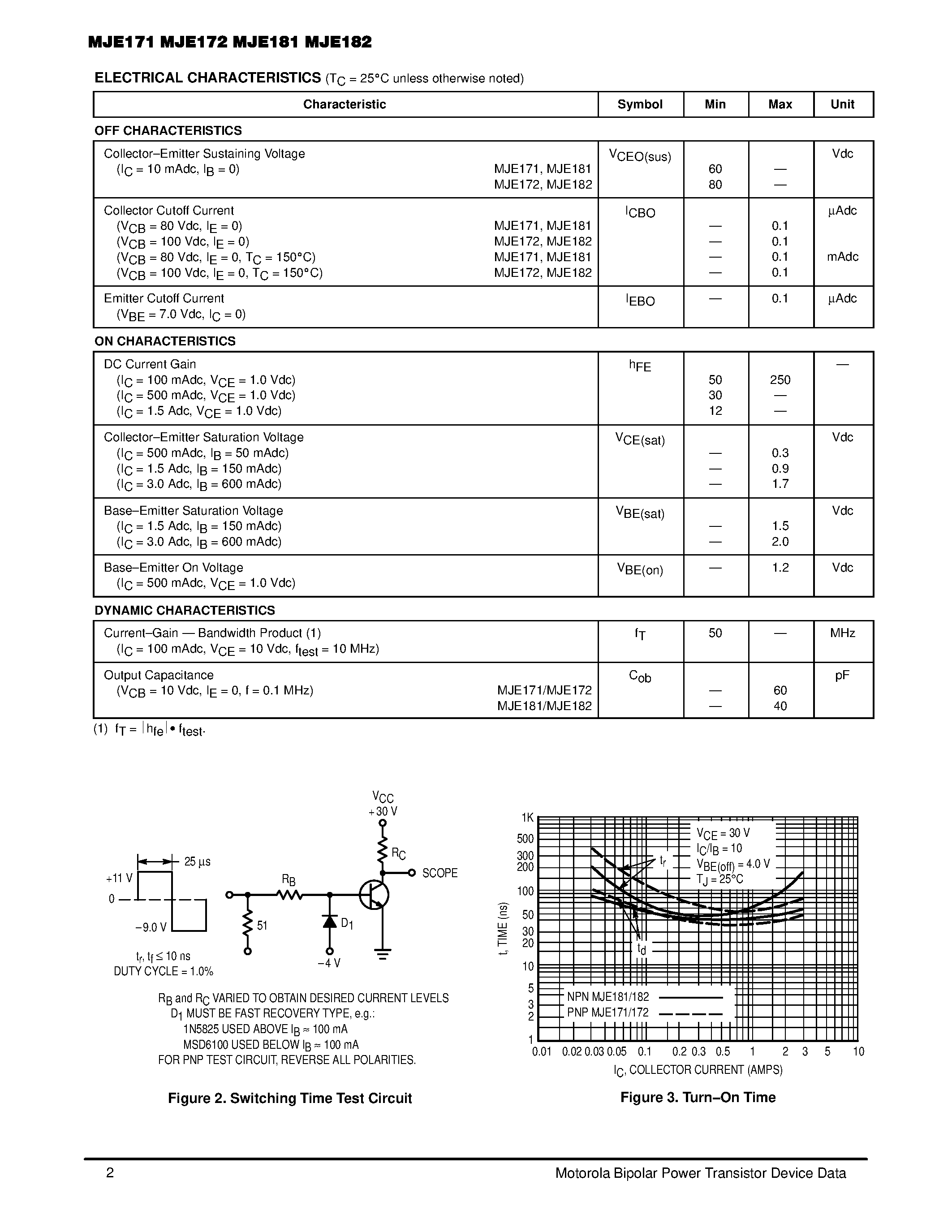

MJE171-3 AMPERE POWER TRANSISTORS COMPLEMENTARY SILICON 60-80 VOLTS 12.5 WATTS
Producer:Motorola
Description:3 AMPERE POWER TRANSISTORS COMPLEMENTARY SILICON 60-80 VOLTS 12.5 WATTS
Others with the same file: MJE171
Datasheet MJE171 - 3 AMPERE POWER TRANSISTORS COMPLEMENTARY SILICON 60-80 VOLTS 12.5 WATTS page 1
Datasheet MJE171 - 3 AMPERE POWER TRANSISTORS COMPLEMENTARY SILICON 60-80 VOLTS 12.5 WATTS page 2
