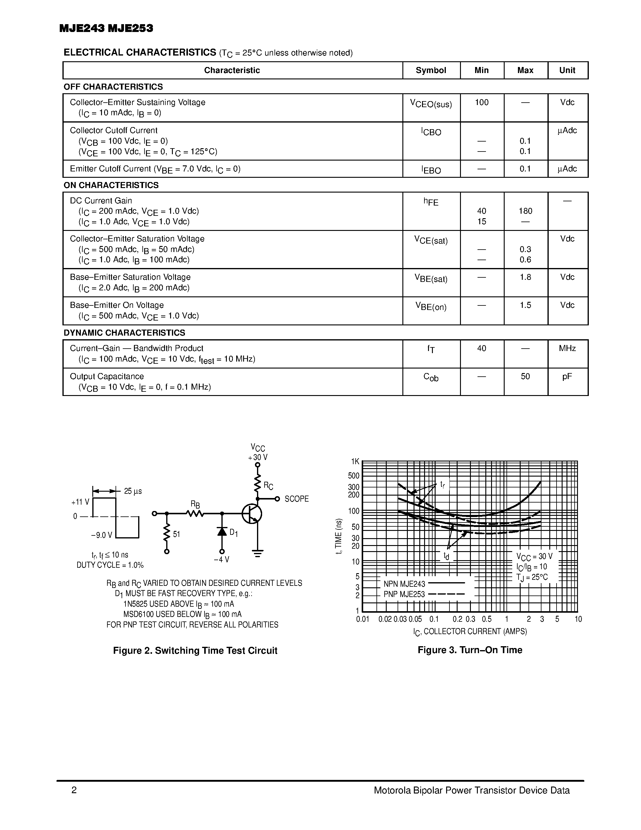

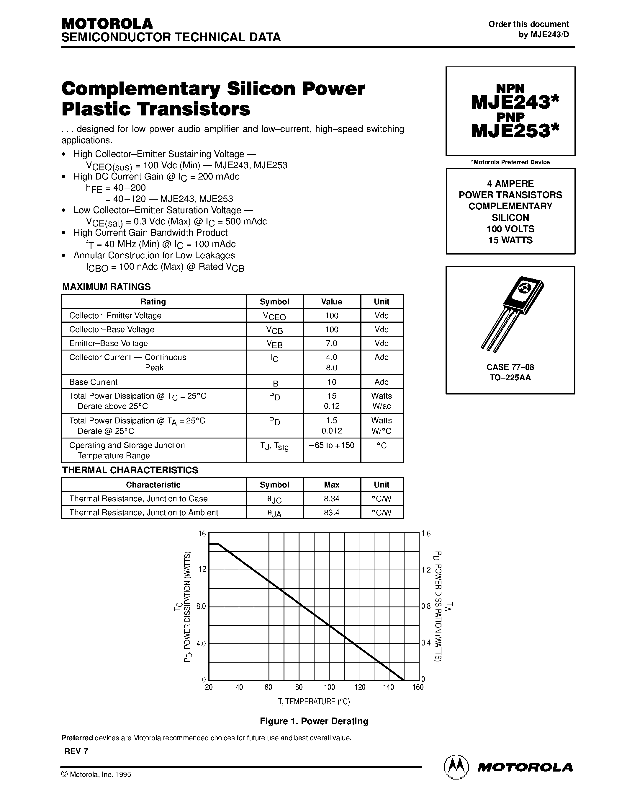

MJE243-4 AMPERE POWER TRANSISTORS COMPLEMENTARY SILICON 100 VOLTS 15 WATTS
Producer:Motorola
Description:4 AMPERE POWER TRANSISTORS COMPLEMENTARY SILICON 100 VOLTS 15 WATTS
Others with the same file: MJE243
Datasheet MJE243 - 4 AMPERE POWER TRANSISTORS COMPLEMENTARY SILICON 100 VOLTS 15 WATTS page 1
Datasheet MJE243 - 4 AMPERE POWER TRANSISTORS COMPLEMENTARY SILICON 100 VOLTS 15 WATTS page 2
