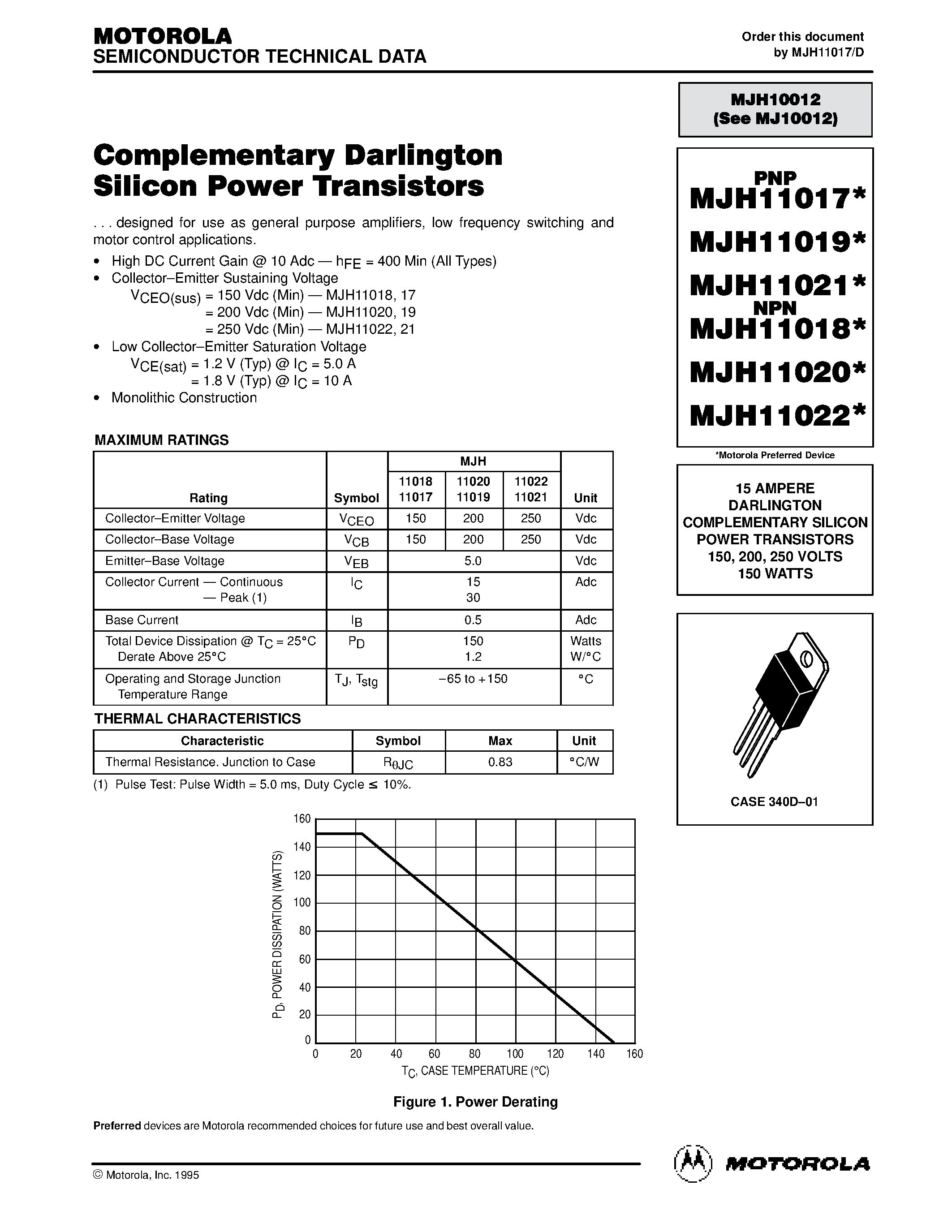

MJH11017-15 AMPERE DARLINGTON COMPLEMENTARY SILICON POWER TRANSISTORS 150 / 200 / 250 VOLTS 150 WATTS
Producer:Motorola
Description:15 AMPERE DARLINGTON COMPLEMENTARY SILICON POWER TRANSISTORS 150 / 200 / 250 VOLTS 150 WATTS
Others with the same file: MJH11017

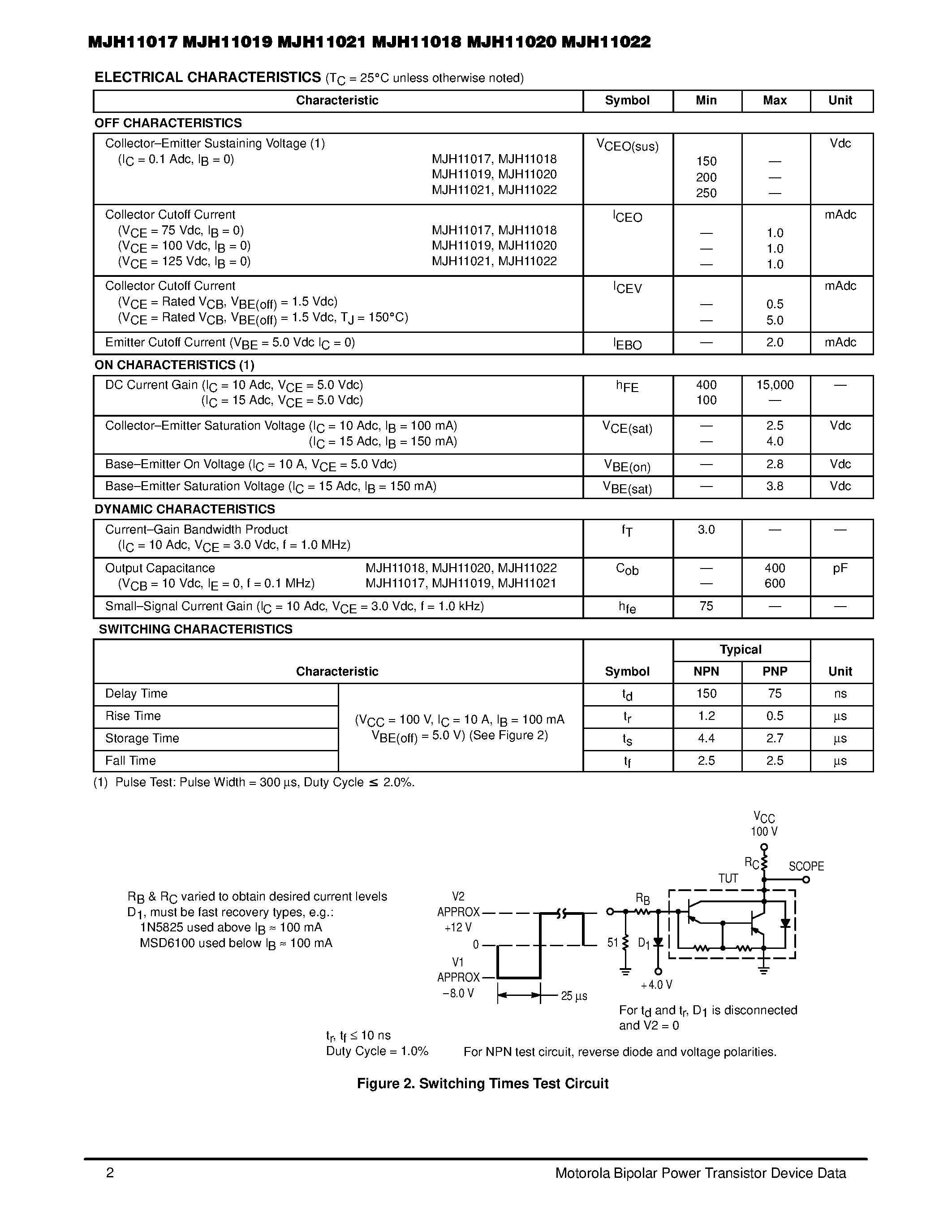

Datasheet MJH11017 - 15 AMPERE DARLINGTON COMPLEMENTARY SILICON POWER TRANSISTORS 150 / 200 / 250 VOLTS 150 WATTS page 1
Datasheet MJH11017 - 15 AMPERE DARLINGTON COMPLEMENTARY SILICON POWER TRANSISTORS 150 / 200 / 250 VOLTS 150 WATTS page 2
