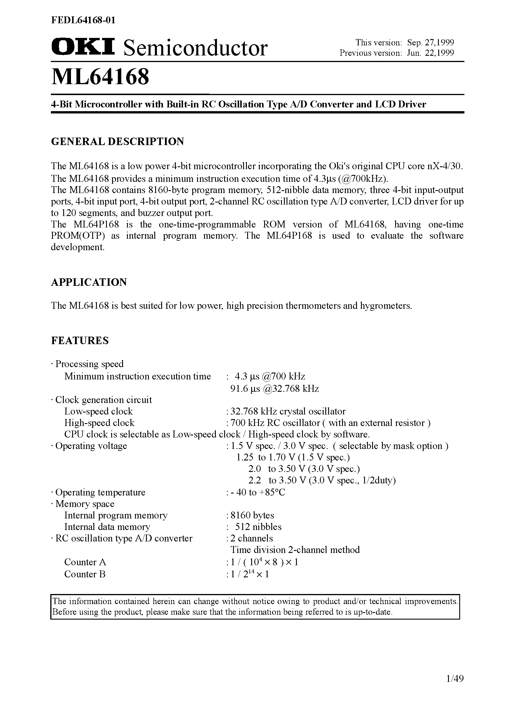

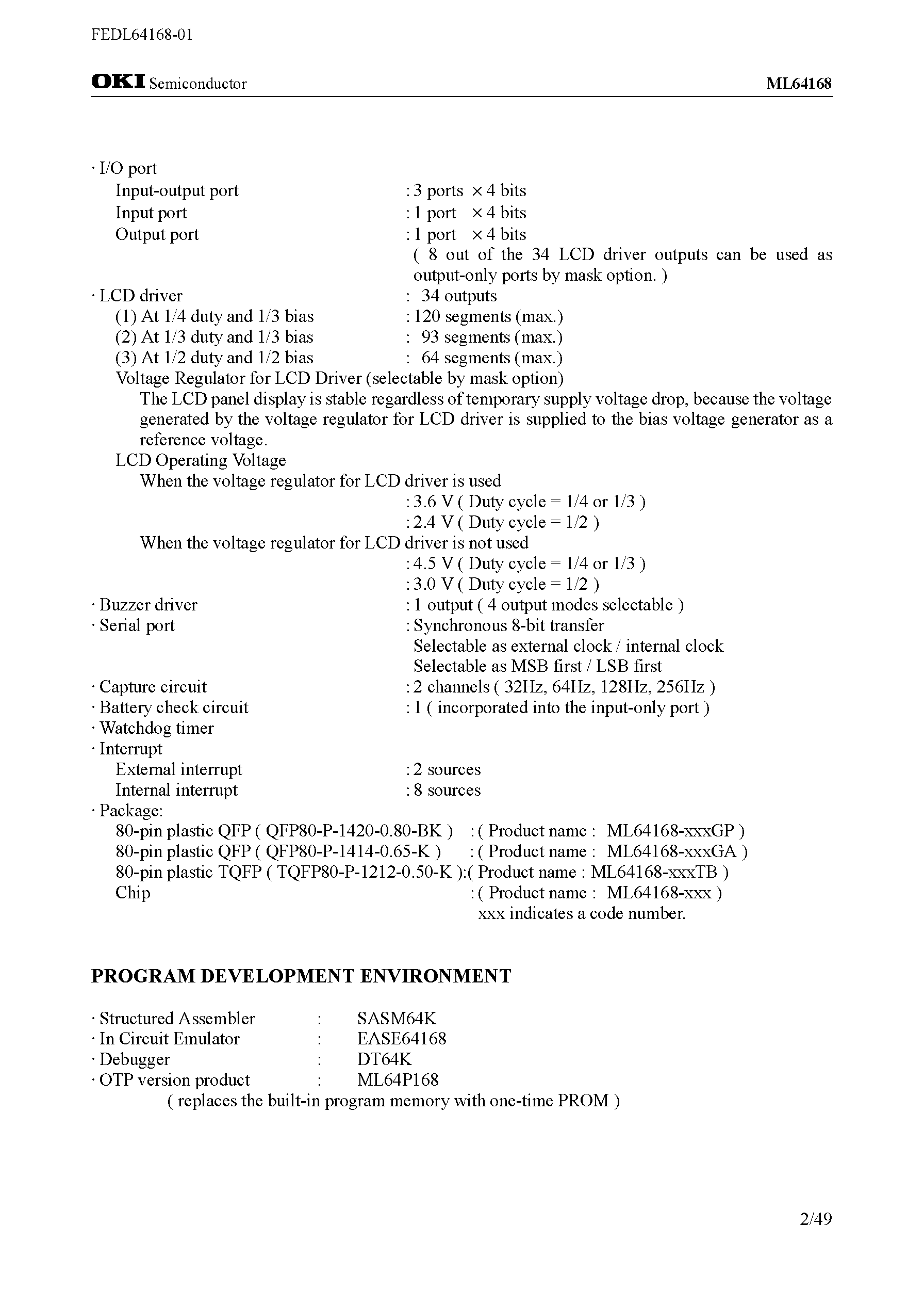

ML64168-4-Bit Microcontroller with Built-in RC Oscillation Type A/D Converter and LCD Driver
Producer:OKI electronic componets
Description:4-Bit Microcontroller with Built-in RC Oscillation Type A/D Converter and LCD Driver
Others with the same file: ML64168
Datasheet ML64168 - 4-Bit Microcontroller with Built-in RC Oscillation Type A/D Converter and LCD Driver page 1
Datasheet ML64168 - 4-Bit Microcontroller with Built-in RC Oscillation Type A/D Converter and LCD Driver page 2
