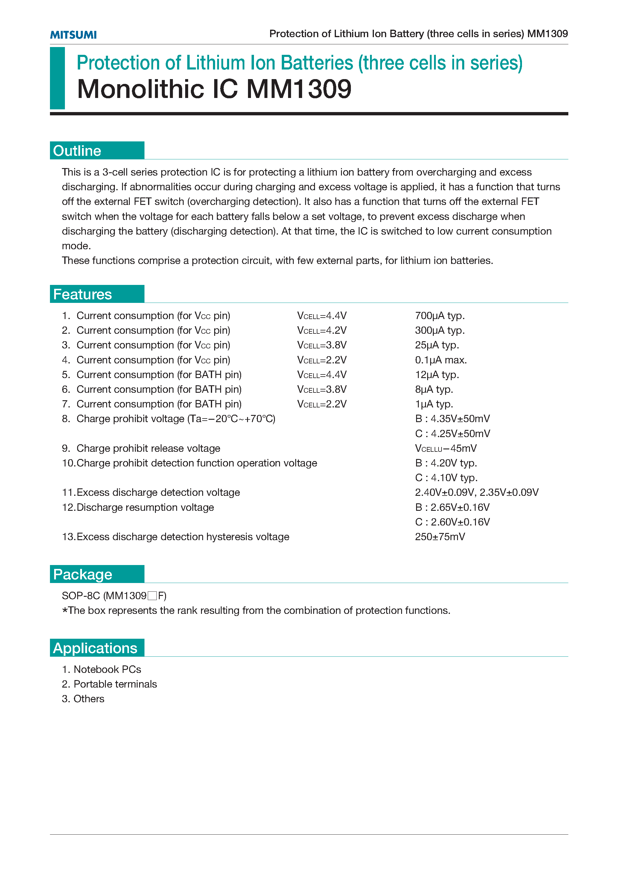

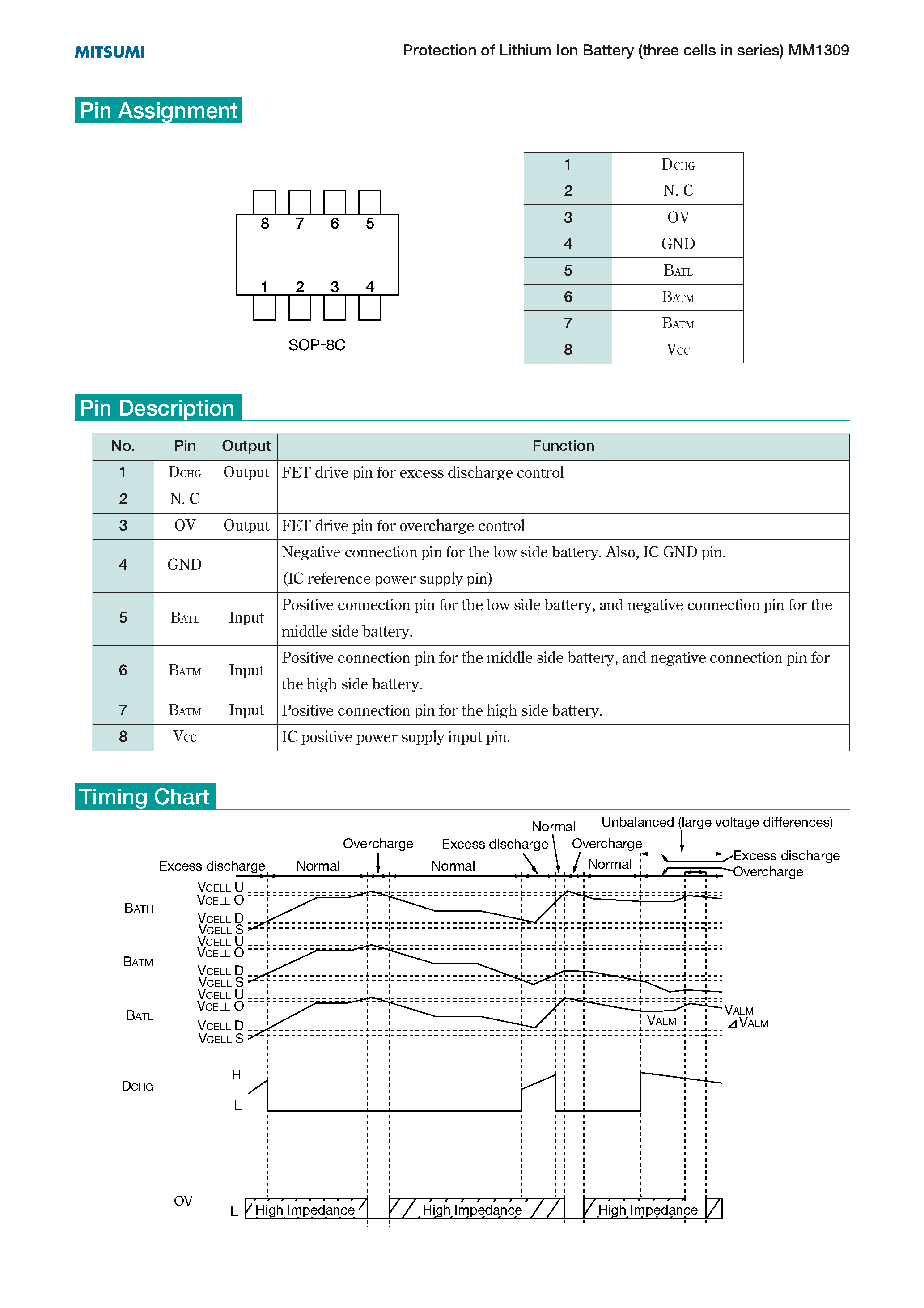

MM1309CF-Protection of Lithium Ion Batteries (three cells in series)
Producer:MITSUMI
Description:Protection of Lithium Ion Batteries (three cells in series)
Others with the same file: MM1309CF
Datasheet MM1309CF - Protection of Lithium Ion Batteries (three cells in series) page 1
Datasheet MM1309CF - Protection of Lithium Ion Batteries (three cells in series) page 2
