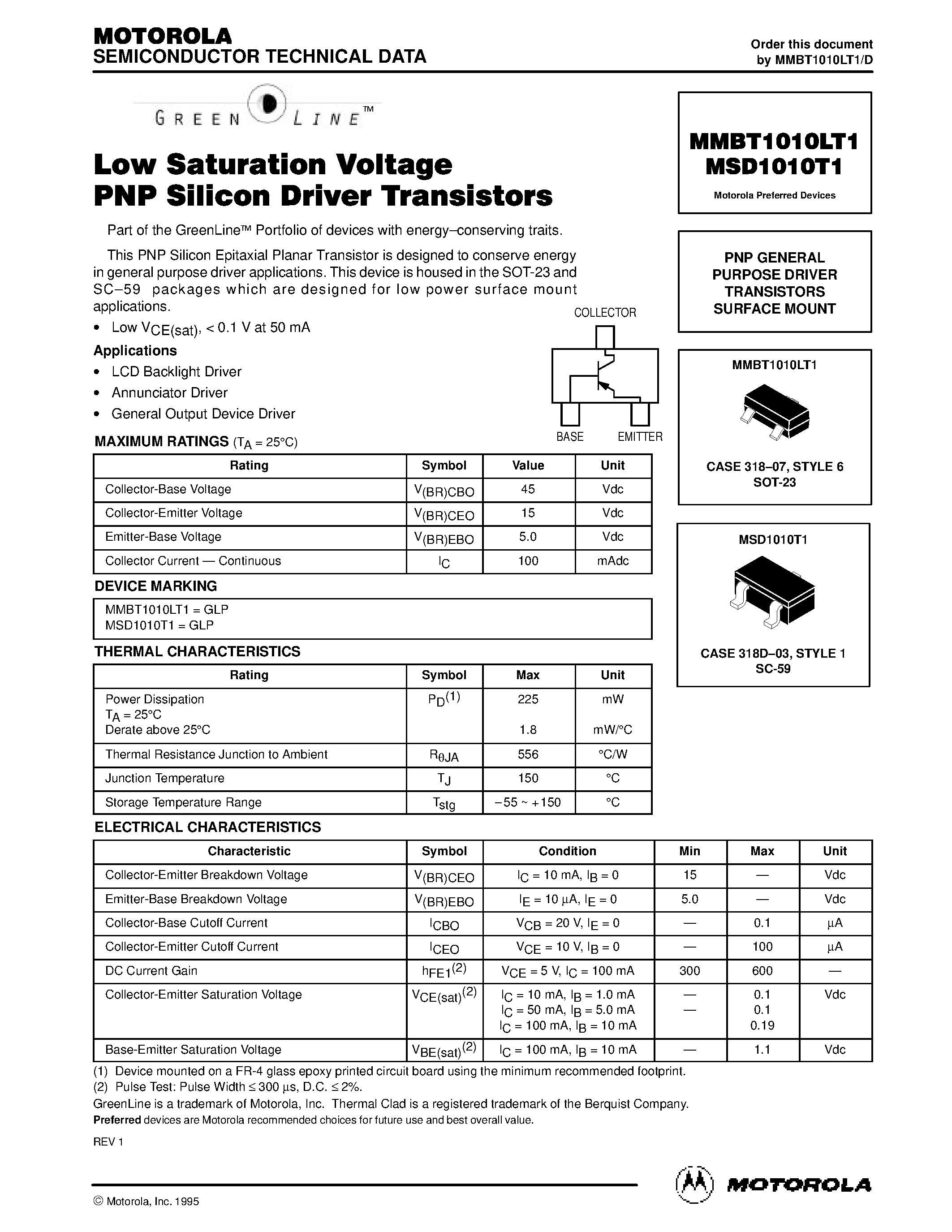

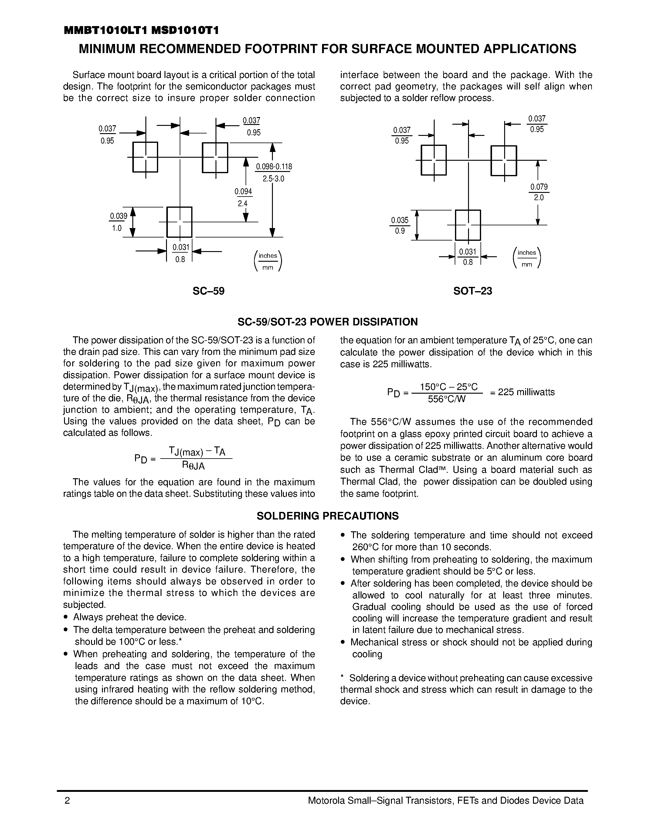

MMBT1010LT1-PNP GENERAL PURPOSE DRIVER TRANSISTORS SURFACE MOUNT
Producer:Motorola
Description:PNP GENERAL PURPOSE DRIVER TRANSISTORS SURFACE MOUNT
Others with the same file: MMBT1010LT1
Datasheet MMBT1010LT1 - PNP GENERAL PURPOSE DRIVER TRANSISTORS SURFACE MOUNT page 1
Datasheet MMBT1010LT1 - PNP GENERAL PURPOSE DRIVER TRANSISTORS SURFACE MOUNT page 2
