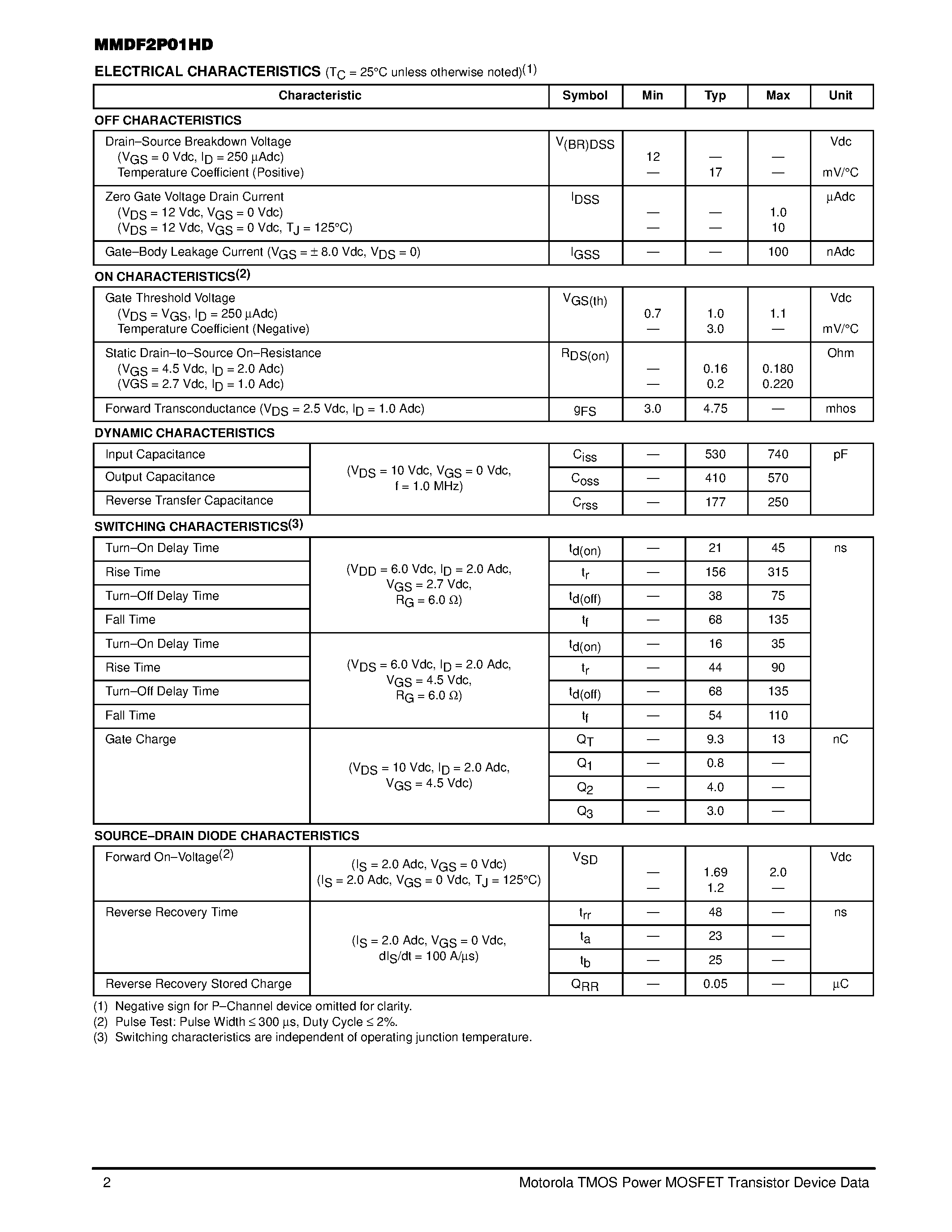

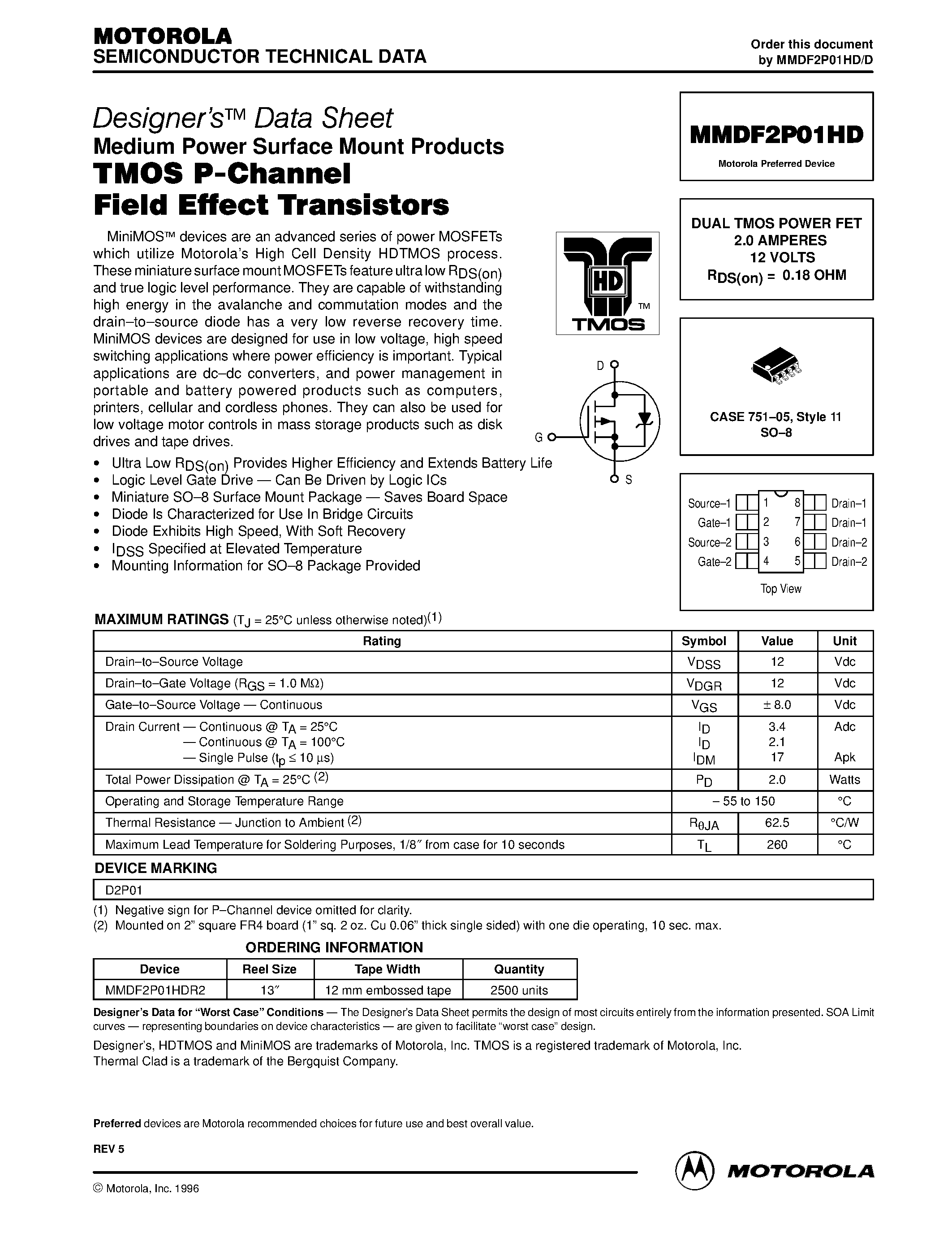

MMDF2P01HD-DUAL TMOS POWER FET 2.0 AMPERES 12 VOLTS
Producer:Motorola
Description:DUAL TMOS POWER FET 2.0 AMPERES 12 VOLTS
Others with the same file: MMDF2P01HD
Datasheet MMDF2P01HD - DUAL TMOS POWER FET 2.0 AMPERES 12 VOLTS page 1
Datasheet MMDF2P01HD - DUAL TMOS POWER FET 2.0 AMPERES 12 VOLTS page 2
