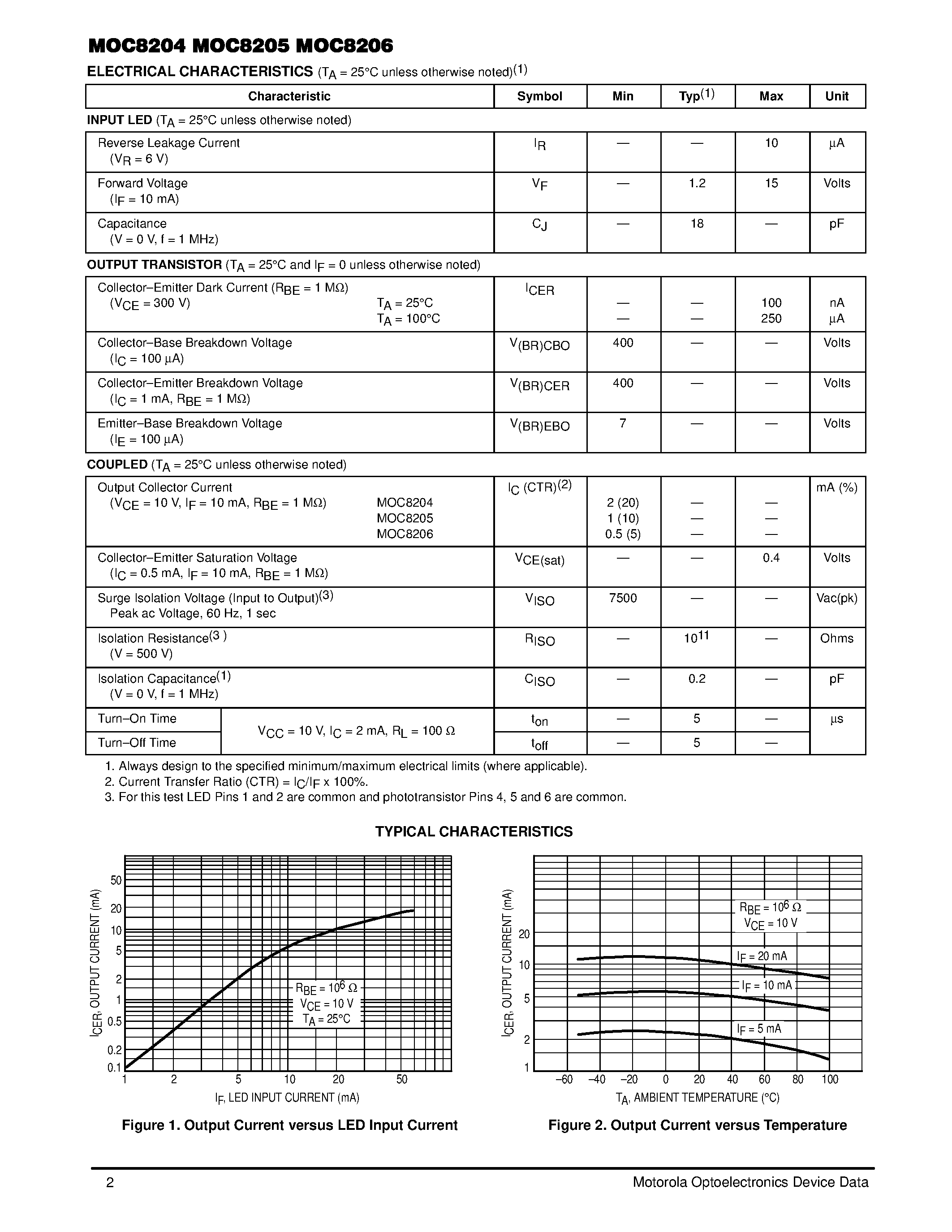

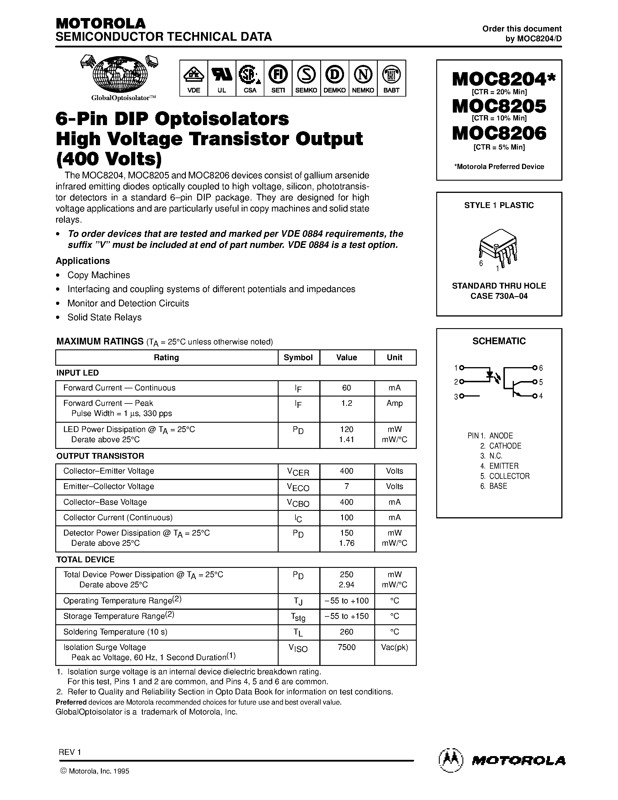

Datasheet MOC8204 - (MOC8204 / MOC8205 / MOC8206) 6-Pin DIP Optoisolators High Voltage Transistor Output(400 Volts) page 1
Datasheet MOC8204 - (MOC8204 / MOC8205 / MOC8206) 6-Pin DIP Optoisolators High Voltage Transistor Output(400 Volts) page 2
