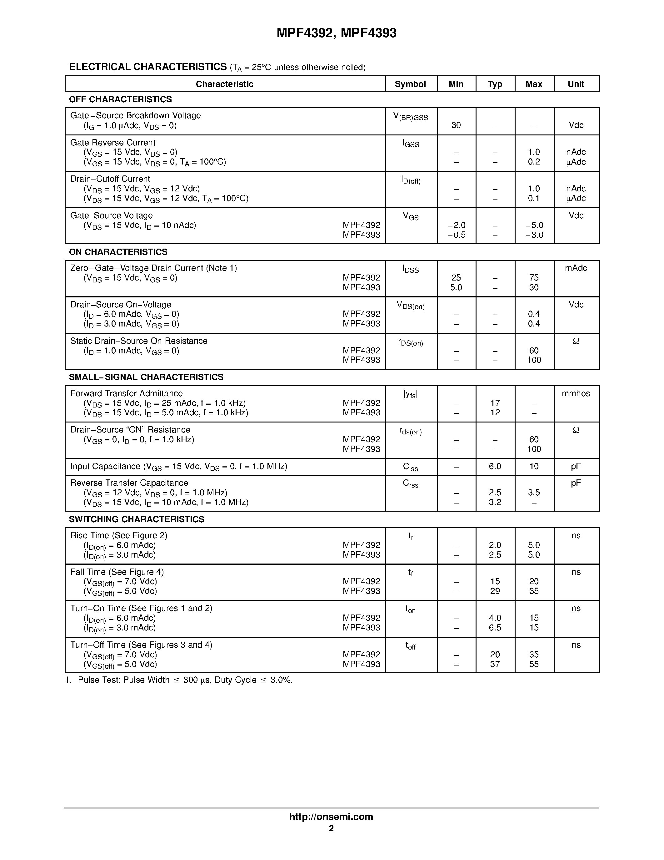

MPF4392-(MPF4392 / MPF4393) JFET Switching Transistors N-Channel
Producer:ON Semiconductor
Description:(MPF4392 / MPF4393) JFET Switching Transistors N-Channel
