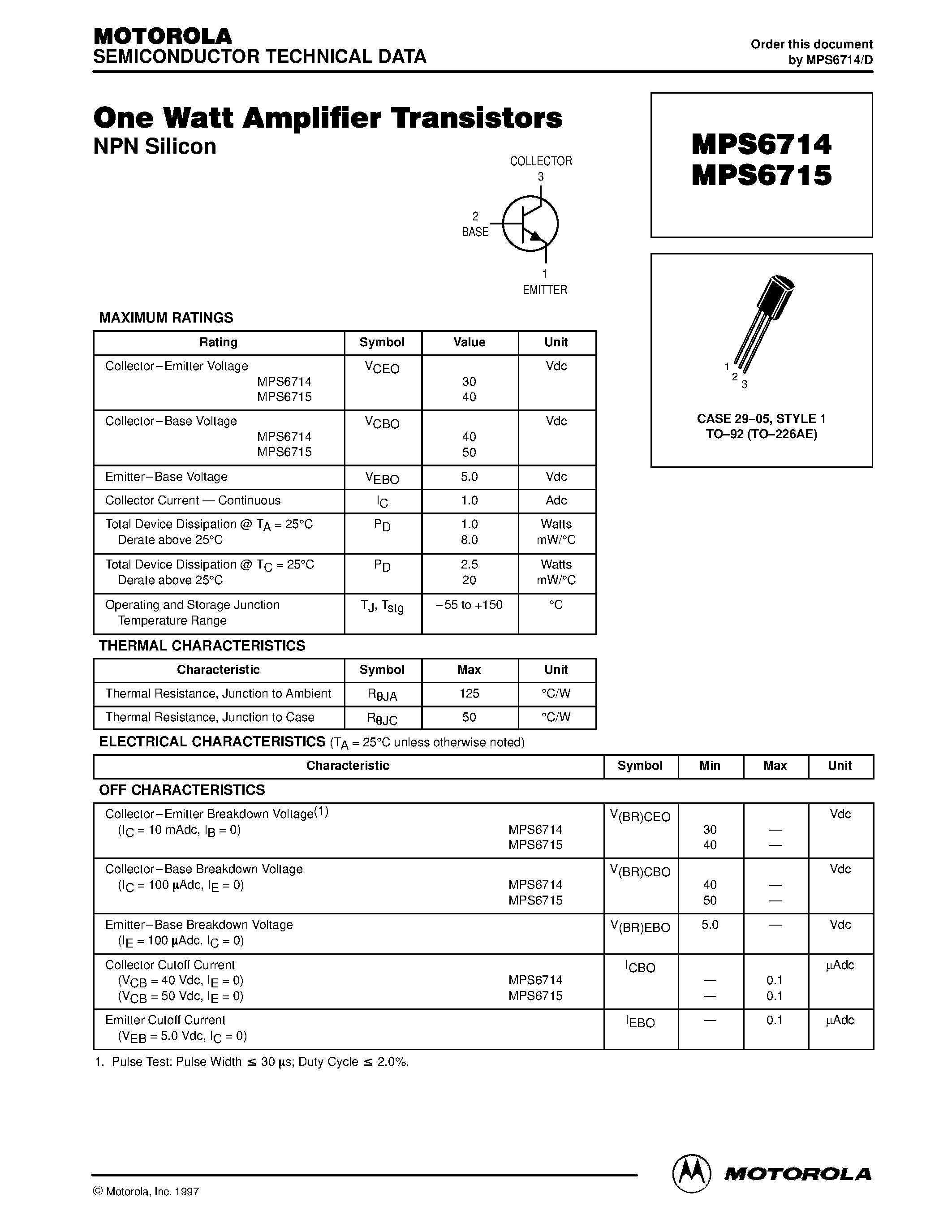

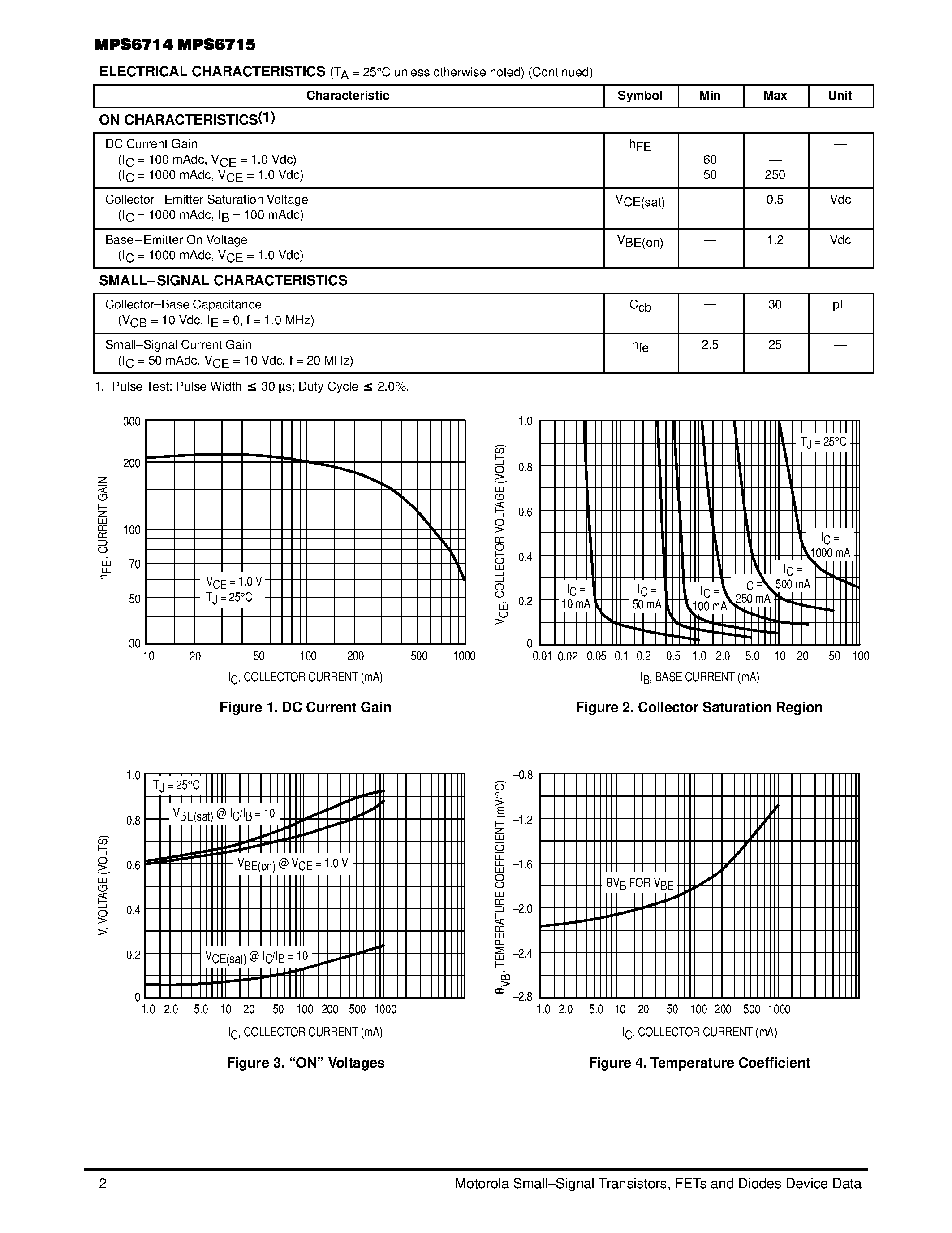

MPS6714-(MPS6714) One Watt Amplifier Transistors
Producer:Motorola
Description:(MPS6714) One Watt Amplifier Transistors
Others with the same file: MPS6714 | MPS6715
Datasheet MPS6714 - (MPS6714) One Watt Amplifier Transistors page 1
Datasheet MPS6714 - (MPS6714) One Watt Amplifier Transistors page 2
